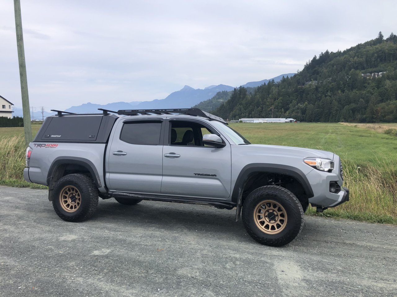

    Picture is before I pushed the front wheels out with lower cams.

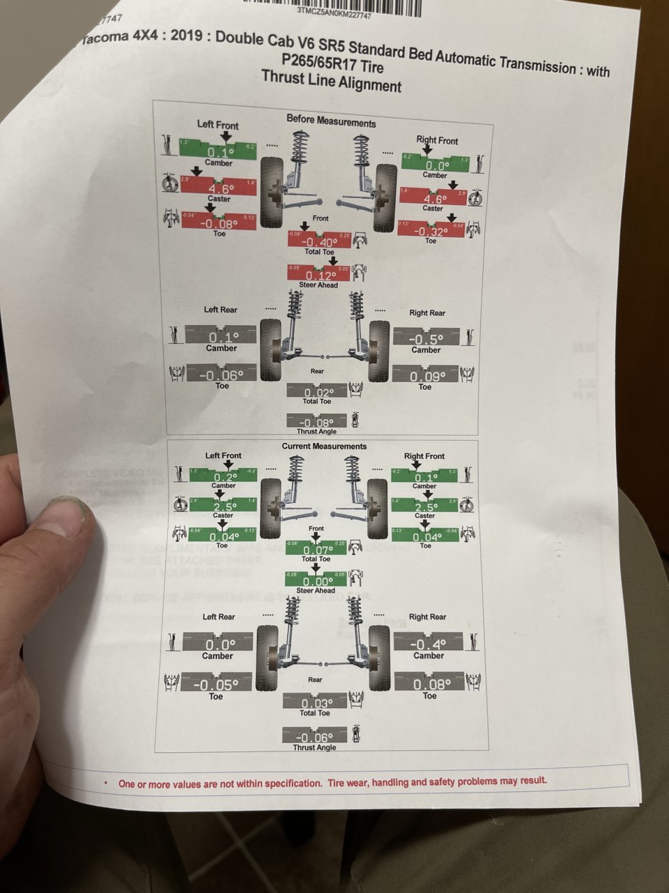

    So got lift installed. 6112s (5/6 setting), icon rxt leaf pack w/5100s, camburg x-joint uca. I set the caster to max forward after putting lift on. That is what the pre install numbers are. 4.6. Minor adjustments and I would have had 4deg caster. Drove to get tires installed and alignment. Truck felt planted. The tech said that he adjusted to 4 but then he test drove it and got some pulling to the right. So he set it to factory and called it a day. And then tried some BS about tire wear and that he couldn’t get it get it to 4. I guess he doesn’t get the point of cross caster. So I get to go back in after waiting 2 hrs for them to change it and let me drive it and see how I like it (which with 2.5 it feels like I am driving a cloud around on the freeway as I am constantly drifting around. Nightmares… and I need a CMC soon barely rubbed with my settings. Rubs like a MF’r now

    Dropping from 4.6 to 2.5 will pull the wheels back by quite a bit. They could have spent 5 minutes setting the toe and billed a complete alignment.

    That’s exactly what I am saying. :lol: I’m mean I had it dam close except the toe. But know the monkey said otherwise. And it definitely pulled the wheel back a lot cause it was kind of rubbing at 1.5 wheel turns before the alignment. Now it slams into the back well. Hopefully getting the alignment resolved tomorrow. I post up some results.

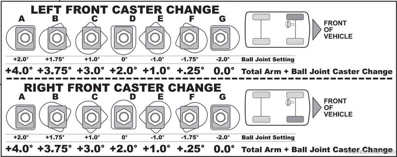

    Currently have Spc ucas at setting D, trd OR suspension and a 2" spacer trying too achieve best ride quality with more cab clearance from tires that are 265 75 16. My lower cams are maxed out, would changing too setting E improve this?

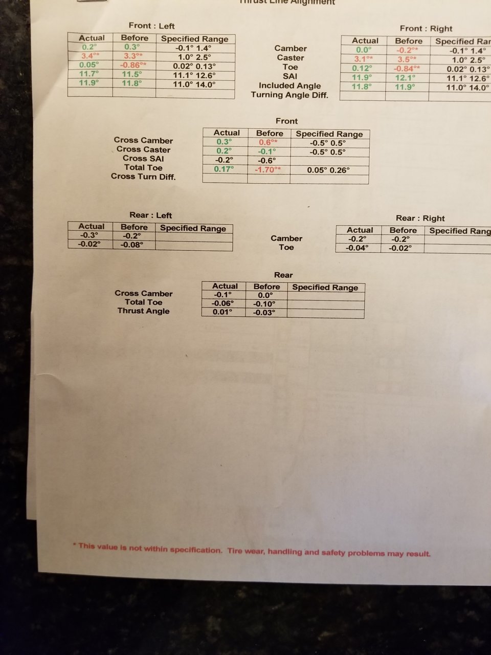

    Bilstein 5160 up front 6/5 setting. Was paired with SPC UCAs but they developed crazy play in bushings and ball joint after 10k miles. Somehow with spc it gave 1.25 in lift. Put oem ucas back on and now have 2in of lift. How does this happen? Here are my alignment specs. Was shooting for 2.5 caster but that put camber way out of spec. A8E3525D-662B-40FF-87EA-2A17E237D984.jpg
