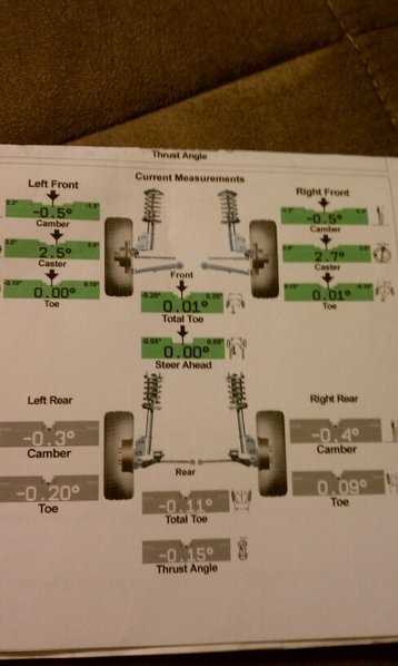

    I just got my LR uca installed. Previously my alignment numbers were : toe 0, camber 0, and caster 1.4. After install they are : toe 0, camber -.5, and caster is 2.4. Of course I requested 0 for camber and my alignment tech said that -.5 is right in the middle of tacomas camber range. Will running a -.5 camber effect outer tire wear?

    I'm taking it back tomorrow. I'm not happy with how it drives. I'm going to request 0* camber, just like the first time. I also noticed that my driver side ball joint is at the -1* position and my passenger ball joint is at the neutral position. Truck also seems to be pulling to the left a little bit.

    Least they did well on the toe. You shouldn't really have any noticeable pull with that. Try driving on the other side of the crown and see what happens, and if it's still pulling then swap front tires rear and make sure your rear axle is located properly, no busted center pins for example.

    How does the caster look? Would the ball joints not being in the same position cause anything? On the rear, do my toe or camber numbers look high?

    I walked them through everything so I would say yes but you never know. Looking at the upper nut it looks like they placed it in the middle so I know I have some movement in it.

    I got my truck back yesterday. Toe is 0, camber is 0, and caster is 2.2. They had to reposition the ball joint to the -1* position. Then to find out they told me they could only get 2.2 caster because my lca cam bolts were seized up. They had to do all of the adjusting with the uca.
