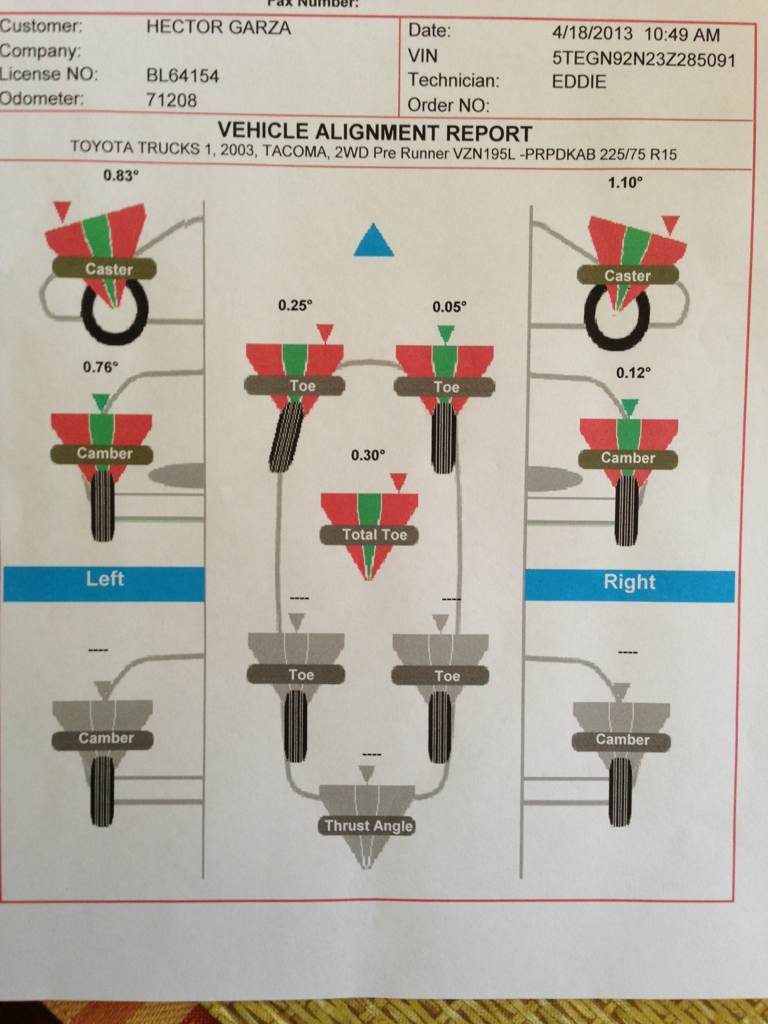

    Hello guys I took my truck for an aligment since I instaed 881 up front. The shop told me they couldn't do nothing about the caster!! My friend recommend me another shop. I have an appointment today what numbers would be good for the caster?? Here is as it sits now.

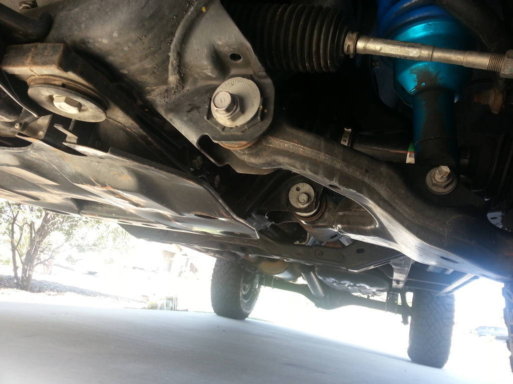

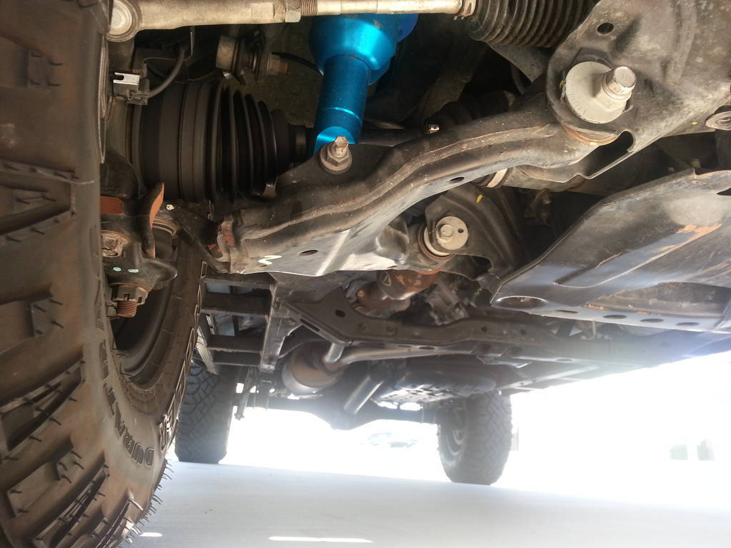

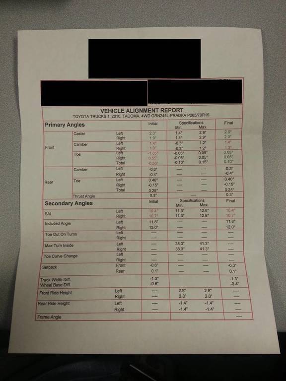

    Took in the truck to get aligned after getting all of my suspension pieced together and these are the results.
    For reference:
    - King extended length coilovers (700 lb springs)
    - Camburg uniball UCA
    - All Pro Expo leafs
    Drivers side eccentric cams:
    Passenger side eccentric cams:
    Alignment Sheet:
    Alignment guy said this was the best he could do and that the passenger side cams were "maxed" out. I didn't have time to get under there myself, but before I go a second time i'd like to get an idea of whether or not there is any hope to get it into spec (Camber: 0, Caster: 2.5+, Toe: 0.05).
    From what i've gathered, the extra lift (sitting at 3" of lift) I have right now due to my 700 lb springs and no front bumper or skids on (yet) is hurting my numbers but I thought the Camburg UCAs should still get me close?
