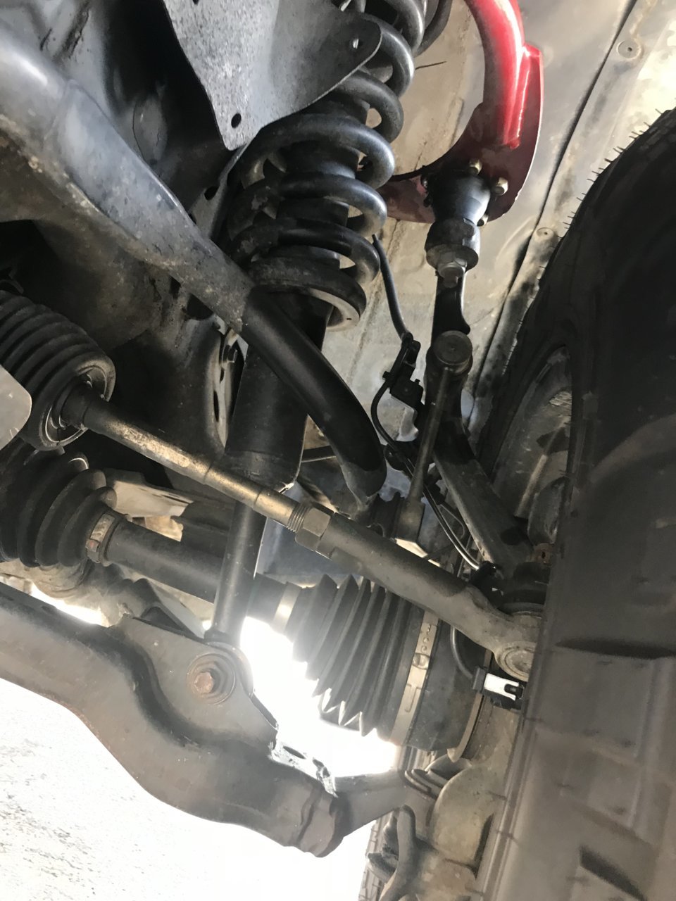

  16. May 16, 2019 at 12:58 PM
    #16
    WooddysTaco
    WooddysTaco [OP] Well-Known Member
    Jan 22, 2019
    #280273
    76
    Micah
    2009 grey Tacoma

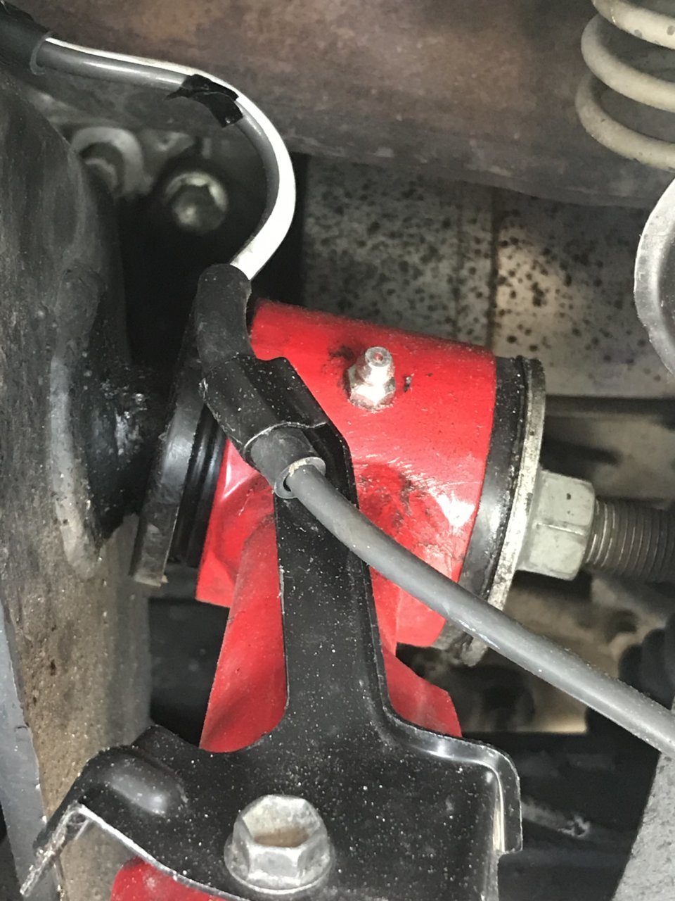

    #17
    WooddysTaco
    Jan 22, 2019
    #280273
    76
    Micah
    2009 grey Tacoma
  18. May 16, 2019 at 1:00 PM
    #18
    WooddysTaco
    Jan 22, 2019
    #280273
    76
    Micah
    2009 grey Tacoma
    Shop that put these on didn’t put washers on the inside and now refusing to fix their mistake and calling me a kid that doesn’t know what I’m talking about, could this affect alignment?
    pinktaco808 and Bastek like this.
  19. May 16, 2019 at 1:02 PM
    #19
    jmanscotch
    jmanscotch Well-Known Member
    Jul 12, 2016
    #191851
    874
    Jake
    Colorado Springs
    2021 TRD OR DCLB
    The tabs are there to give the alignment cam something to adjust is relation to. If the tabs are bent, the alignment *might* be able to be put into spec, but the slop will allow the cams to rotate, rather easily, if the suspension is worn and the truck is being driven over rough roads, all that jolting will throw off an alignment quickly if the tabs aren't as intended and the LCA bolts aren't tight enough.
    If the other shops keep saying nothing in the suspension is worn to the point of needing replaced, and one shop is saying the cam tabs are bent, then I'd advise you to look into repairing the tabs.
    Bent tabs won't MAKE your alignment go out, but they will ALLOW it to go out, because the cams aren't secured. Some think you can over tighten the cam bolts and prevent them from rotating, but it doesn't work well in practice.
    With the information presented, if it were my truck, I'd get the cam tabs reinforced or just welded back to a 90* angle, shouldn't be too much $$, then realign and see. I'd be that's your biggest problem if what the shops and you are sharing is accurate.
