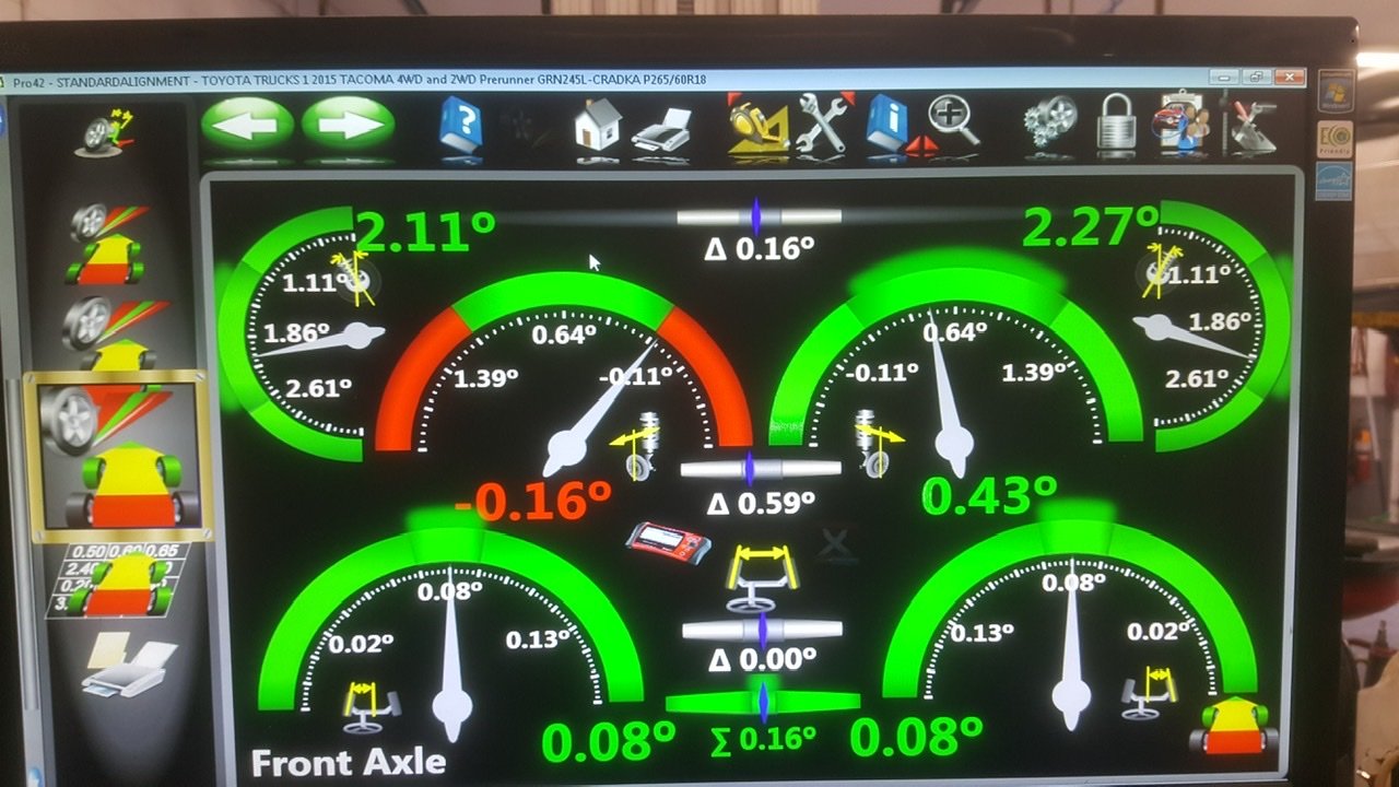

    88223813-E8EF-487B-81E2-9BD22A97A84D.jpg So I took my truck to the local Meineke for an alignment after putting new suspension on. After doing the alignment I asked how bad it was and the guy told me it was bad but it is perfect now. I asked if it was the chamber that was bad, and he said they do not do camber only toe. He then told me most vehicles require new hardware to change the chamber, which I know to be true but our trucks allow for caster and camber adjustment without special parts, if not lifted over 2 1/2 inches.
    Trying to figure out if I am going to make a stink about this or live with the camber being slightly out. The manager said one good pothole could knock the alignment out that much as soon as I left (BS). I plan on replacing the tires next year and will do an alignment then anyway, just not at Meineke.
