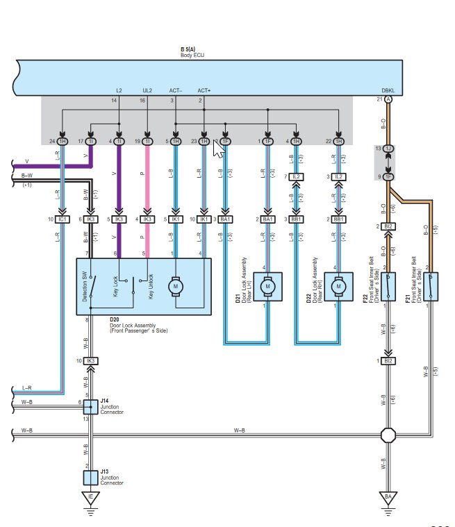

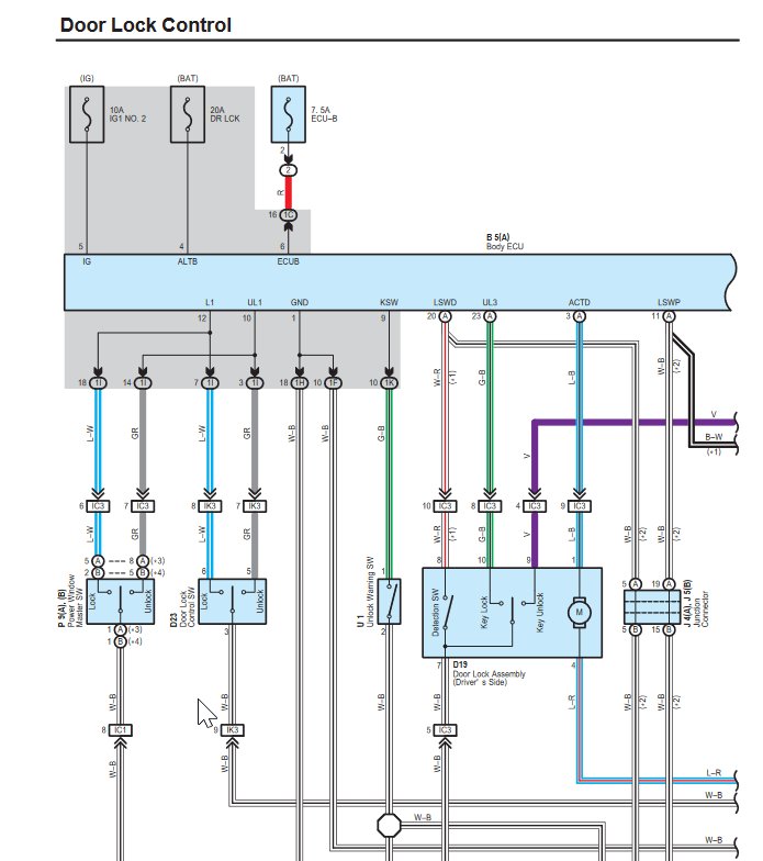

    Here are the prints. There is no relay. locking is controlled by the Body ECU.
