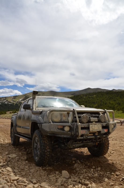

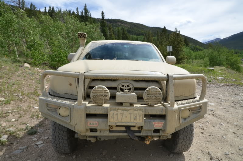

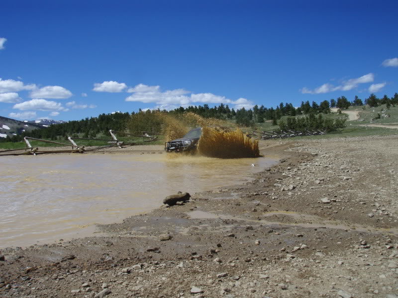

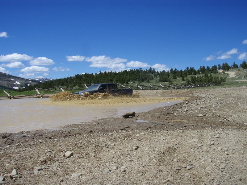

    Here a some more pics from a recent wheeling excursion:

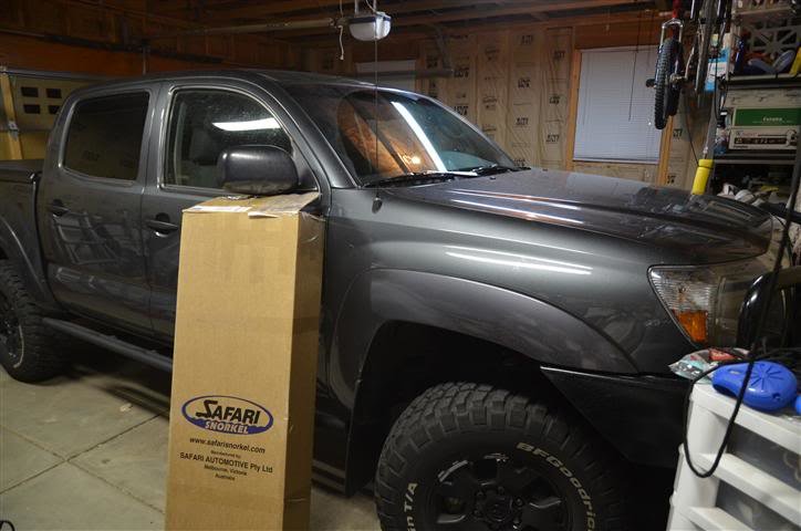

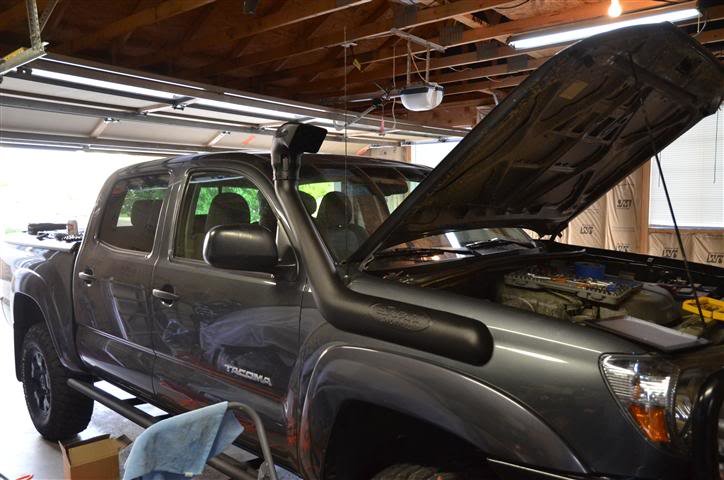

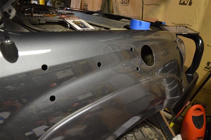

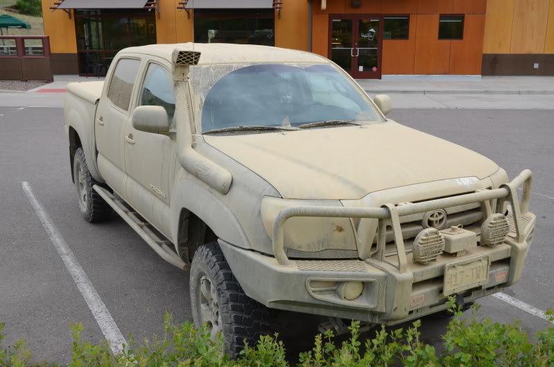

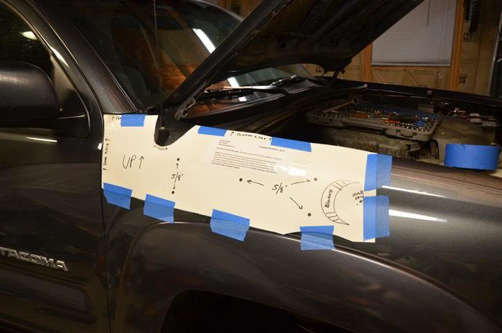

    After a couple of years spent hemming and hawing over the thought of drilling through a perfectly good fender, I finally decided to take the plunge and install a Safari snorkel.
    There are already a few detailed posts about how to do this elsewhere, so I'll skip the details, but here are some pics of my steps along the way. If you have any questions, feel free to ask. This was no small task and the project was filled with lots of weird little kinks and quirks to figure out.
    I will share a couple of things I learned-- when drilling, definitely use step bits only. The sheet metal can be surprisingly soft, and regular bits can chew things up if you don't have the right technique/speed/touch. I lost a step bit at some point in the project and then tried to make due with a regular bit... it was not nearly as nice or easy! So that, and use a metal nibbling tool if you can get one for enlarging the large hole. I actually own one and completely forgot to use it, instead going with a small sawzall, which put a couple of small dings in my fender. :(
    Anyway, here's the good stuff:
    ...and so it begins!
    Using the custom Tacoma template as included when I bought the snorkel from Cruiser Outfitters. Kurt was great to work with, by the way!
    Yikes, all the holes drilled out and everything went along just perfectly... at least until I unknowingly made a couple of small dings while using the aforementioned mini sawzall to elongate the big hole.

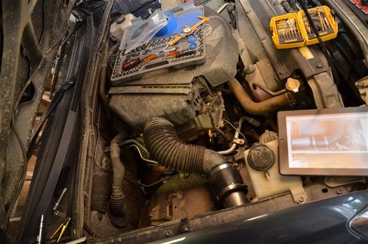

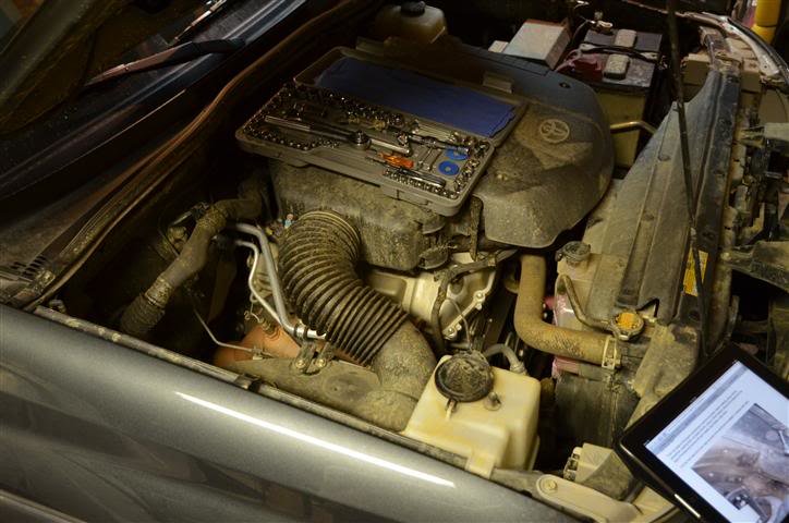

    Stock air intake plumbing. As you can see from all the mud splashes, a snorkel was long overdue. I was blown away by how much dried mud I found in the intake hose and box... all the way up to the filter. Yeah, it was time for a snorkel. Did I mention, I like mud?
    Newly routed plumbing all set. I followed Barlowrs' method from his snorkel install, hacking off the large box from the end of the OEM flexible hose and joining the snorkel hose to it with a piece of 3" muffler pipe and a 3x3" flexible plumbing connector . As you can see, my iPad came in quite handy for referencing that day!
    Finally done!

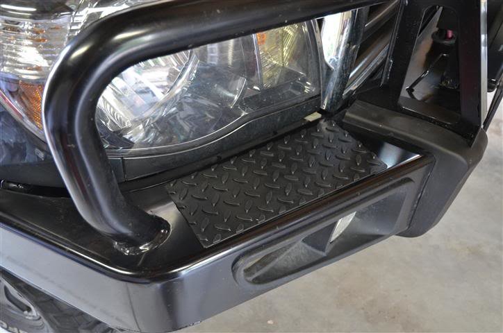

    Here's a little mod I added to my bumper that was cheap, functional, and easy. I found these diamond plate style rubber mats at Harbor Freight for about $5 a pop. They're self-adhesive backed, and each sheet will make a perfect set of two pads for the two large flat areas on an ARB bumper. This gives you a perfect grippy spot to lay tools, recovery gear, etc, on the bumper.

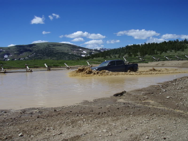

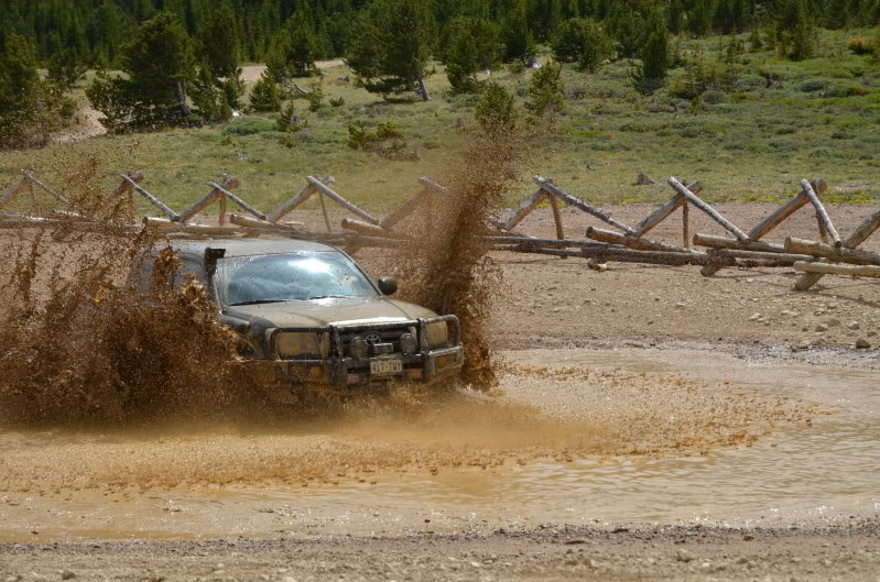

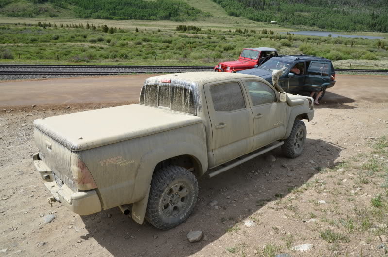

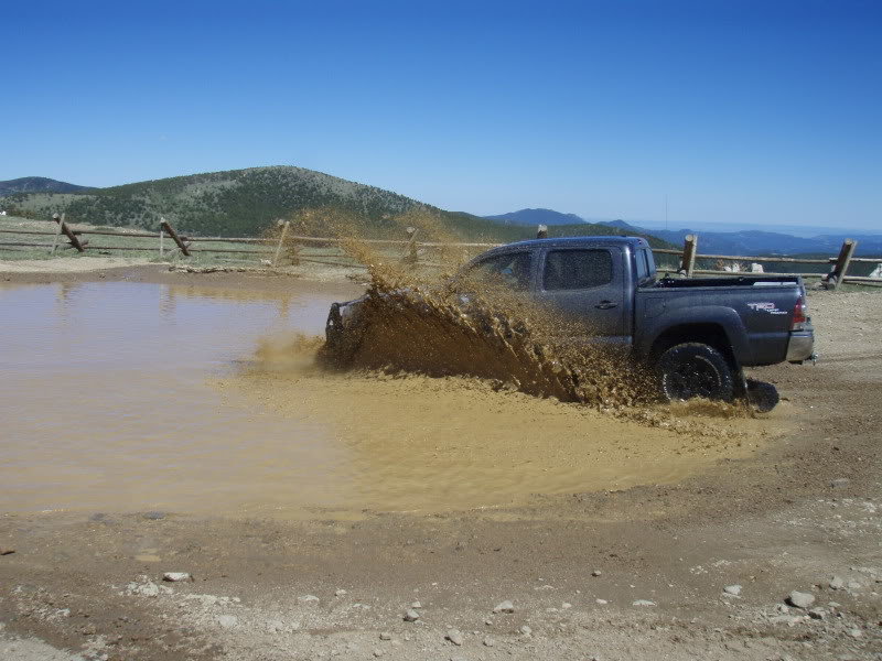

  13. Jul 24, 2012 at 3:25 PM
    #33
    All Beef Taco
    All Beef Taco [OP] Well-Known Member
    Aug 16, 2009
    #21258
    127
    Joe
    Thornton, CO
    2010 TRD Off-Road DC 4x4

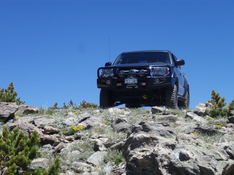

    Rattle canned wheels, Weathertech Floormats, Undercover Tonneau, DIY Hi-Lift jack bed mount, Demello Sliders, ARB Bumper w/ ARB Fogs + anytime fogs mod, IPF 968's, Warn M8000 w/ Amsteel Blue & Billet 4x4 Hawse Fairlead, Rear Leaf TSB, Toytec Adjustable Coilovers and AALs, Rear Bilstein 5100's, BFG MT KM2's, Safari Snorkel, Rear Diff Breather Mod

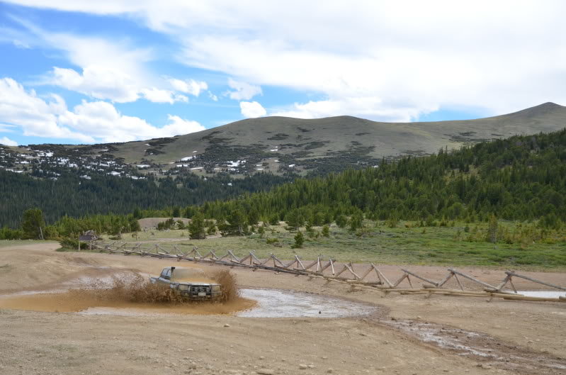

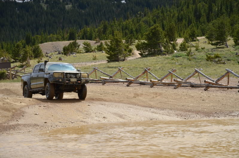

    Here are some more pics from another run through one of my favorite trails. Wish I got a pic of the Jeep guys' faces when they saw my "temporary tan" mud paint job!
