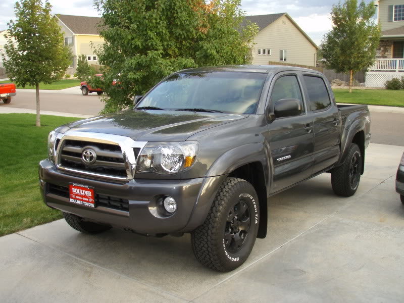

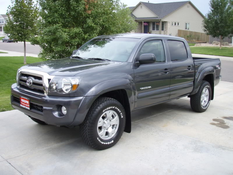

    Here she was on day 2, bone stock….

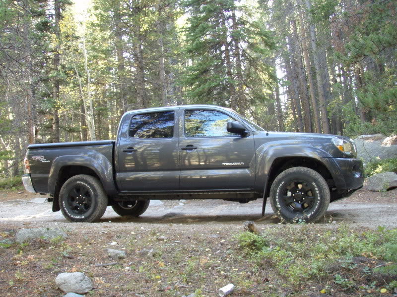

    First mod was painting the wheels black on day 3. Tacoma World’s first influence, and thanks to the handy write-ups I found here:

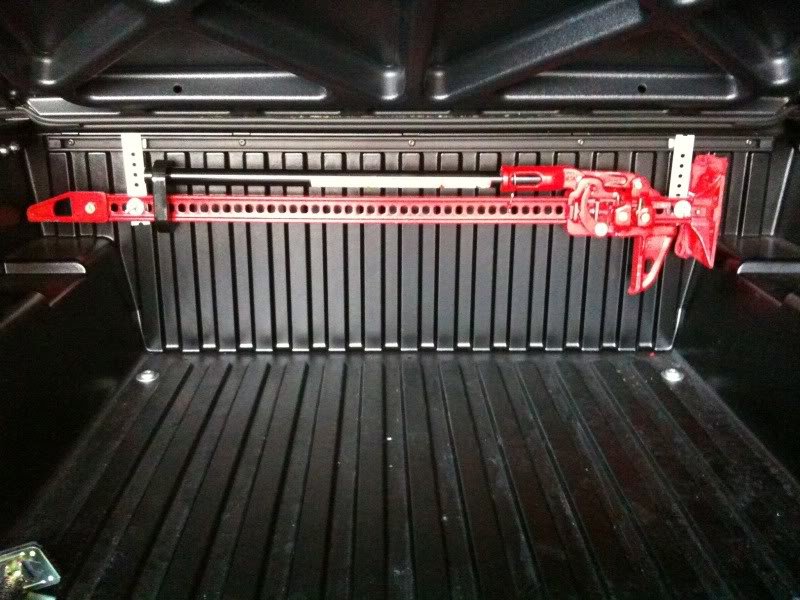

    Next came my DIY Hi-Lift bed mount:

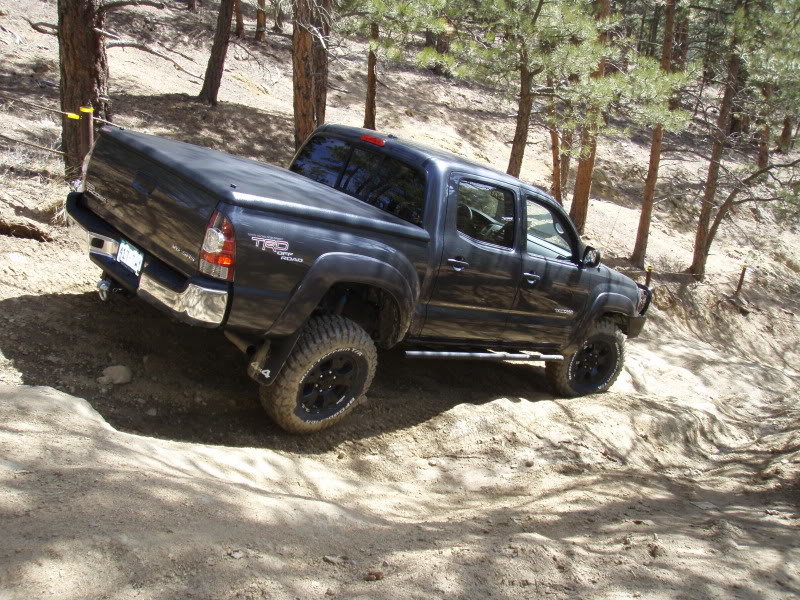

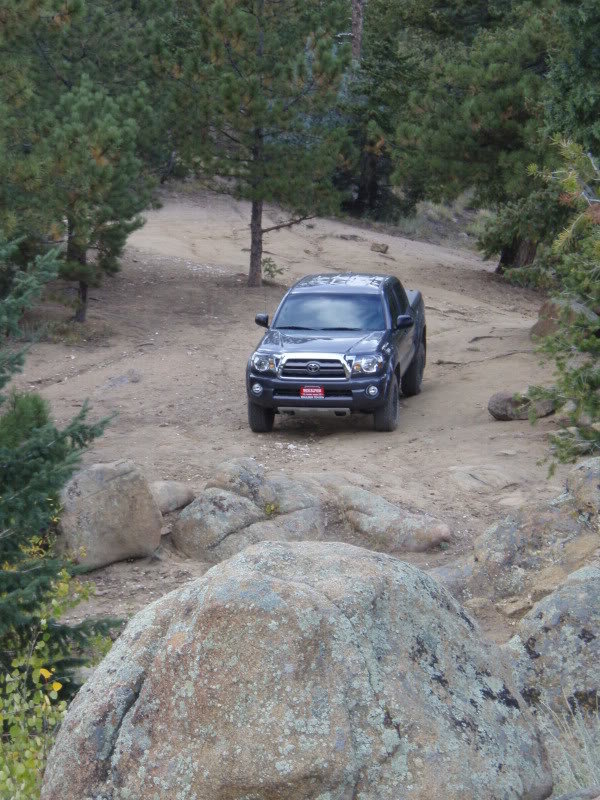

    A few pics from her first off road trips:

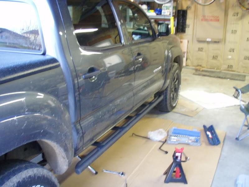

    Next came my Demello sliders. I got these through one of the handy group buys here on the forum:

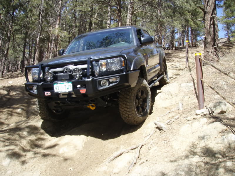

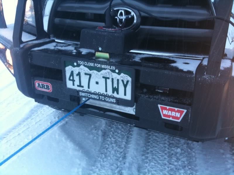

    After wheeling more and more (and often alone), I decided to go for an ARB bumper and winch. I got everything just in time for my birthday. The winch has literally saved my a$$ 3 times already since it was installed:
    I started with a Smittybilt XRC-8, which seemed like a great deal with the synthetic rope and aluminum fairlead. Unfortunately it was an absolute POS (though their customer service was great) and I ultimately returned it for a Warn M8000. I installed an offset aluminum fairlead from Billet 4x4 along with 80’ of Amsteel Blue. I also dropped my Boulder Toyota license plate frames (did I mention how much I hate them???) and added these. “TOO CLOSE FOR MISSLES – SWITCHING TO GUNS” Gotta love it!

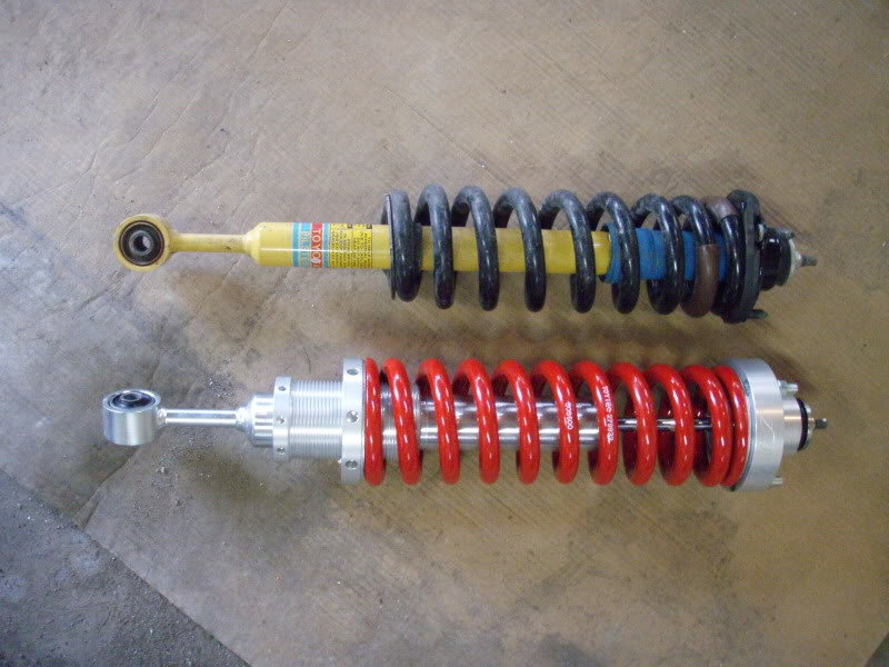

    Shortly after the winch/bumper install, I got my rear leaf TSB done. Consequently my front end was sagging pretty low after adding the bumper and winch, so it was time to upgrade. I decided to go with ToyTec’s adjustable coil overs. I wasn’t sure if I wanted to raise the rear any more after the TSB, but thought I might eventually, so the adjustability and ease of installation seemed like a good fit for me. They’re at a decent price and while I’d love to go to Icons in the future, these will do for now. My wallet is straining as it is! I also appreciated the lifetime warranty and close proximity of ToyTec, as I live very close to them. Here’s a pic of the coil overs next to the OEM Bilsteins:

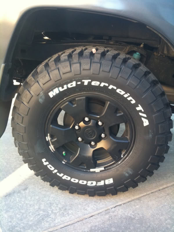

    I decided to go with some better tires for trail use. I went with BFG Mud Terrain KM2’s on Bill Burke’s recommendation and the tons of good things I’ve heard here and everywhere else. I went up to 265/75/16s (still on the stock TRD alloys) because I wanted to ensure maximum articulation without any further mods… at least for now.
    I’ve most recently added ToyTec’s TSB AAL’s, and raised the front again to compensate. I’d love to go to some Icons and Dakars in the future but this setup is working great for me, for now. Here are some pics from the trails:

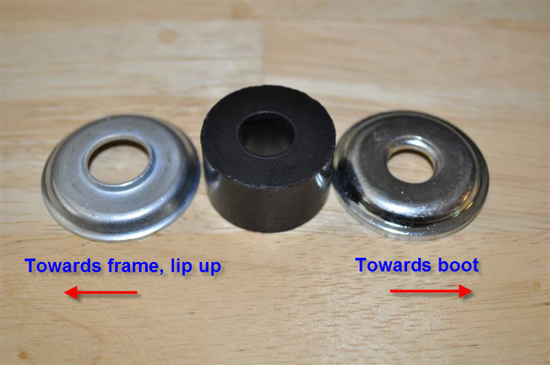

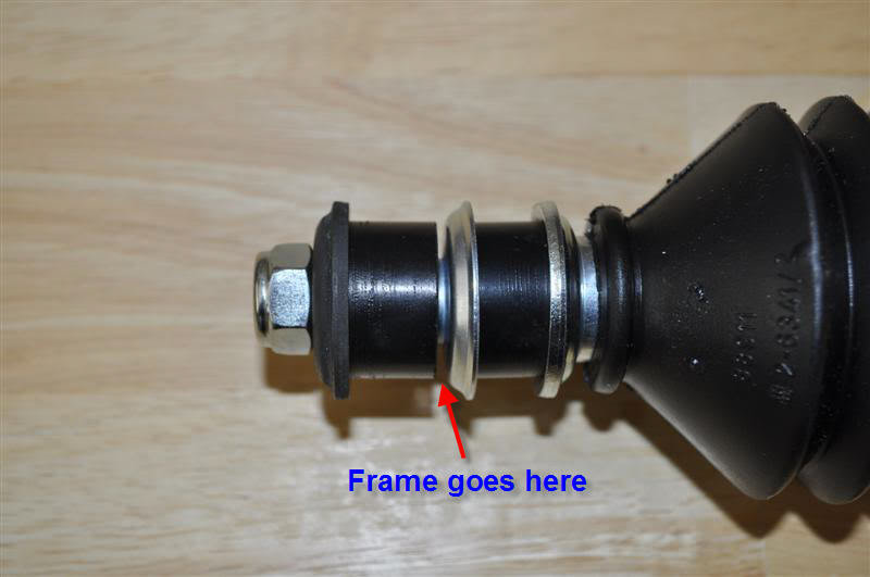

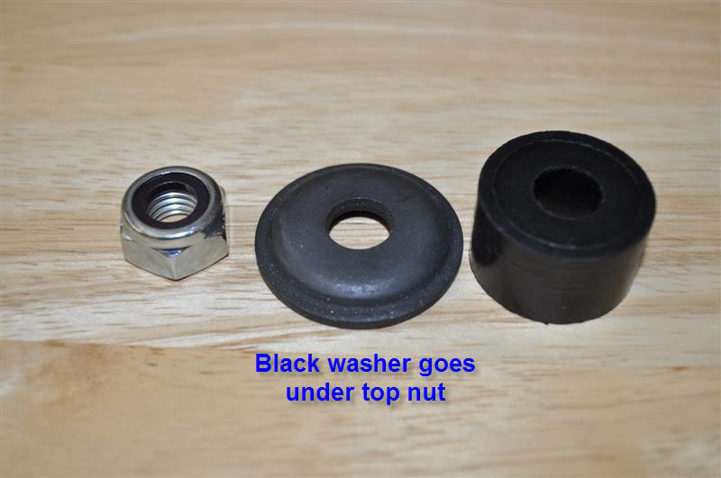

    After 2+ months of waiting for my back order to come through, my rear 5100's finally arrived yesterday. Pics of the install to follow....
    On the same note, I was playing around with them and got somewhat confused by the assorted hardware that came with the shocks. Specifically, there are three different washers and two bushings that must be properly installed to mount the shocks. The washers are a little different from those included with the OEM TRD Bilsteins. No instructions were included and it does matter how they're installed. A call to Bilstein helped resolved this, so I thought I'd share what I learned here in case anyone else ever wonders.
    Here are some pics... as you can see, there are three unique washers. A thick stainless one with a groove along the radius of the hole, a thin stainless one with a lip, and a black washer.
