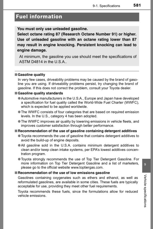

    From the manual:
    Junkhead likes this.
  15. Jan 9, 2019 at 5:53 AM
    #35
    daddy_o
    daddy_o Well-Known Member
    Nov 1, 2015
    #168380
    5,472
    Bossier City, La
    2018 TRD Sport, Inferno, w/tech package
    Factory Blackout package, Soft roll up bed cover, Cheap seat covers, Front and rear dash cam, AVS in channel vent visors
    Well O.k., I never read that page.
