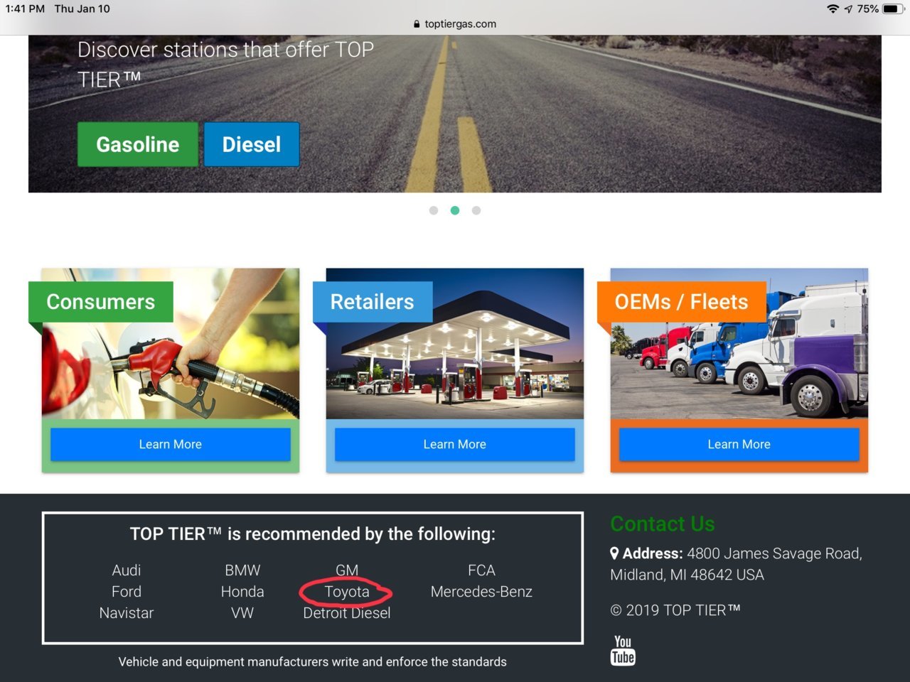

    And of course on the https://www.toptiergas.com/ website where “Vehicle and equipment manufacturers write and enforce the standards”.
    Flatout110 likes this.
