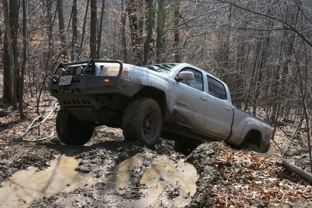

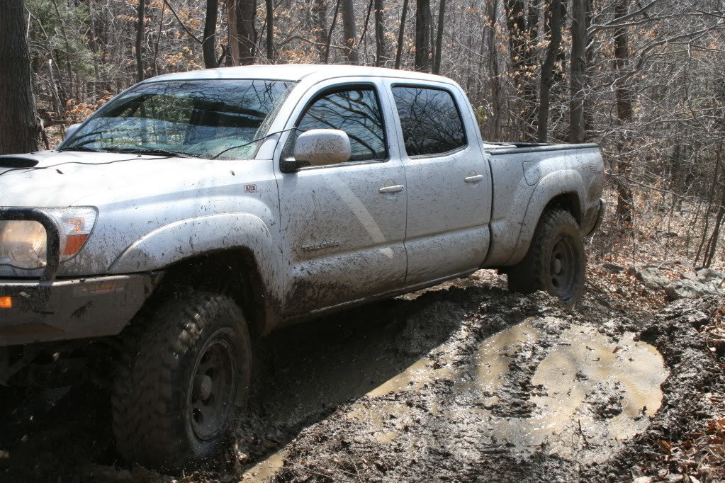

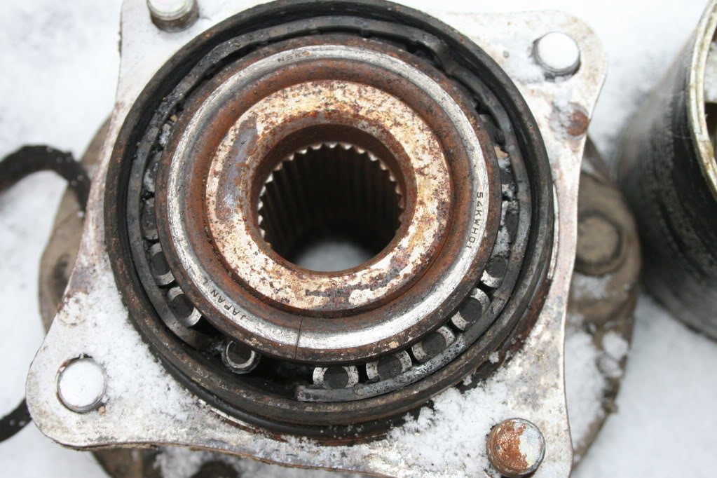

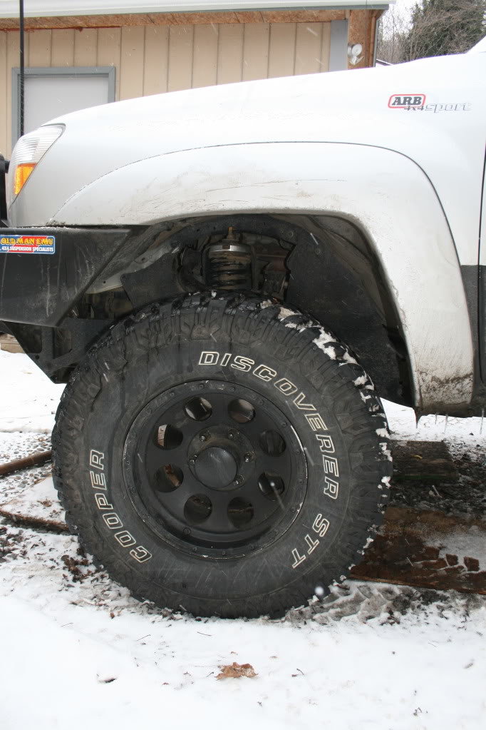

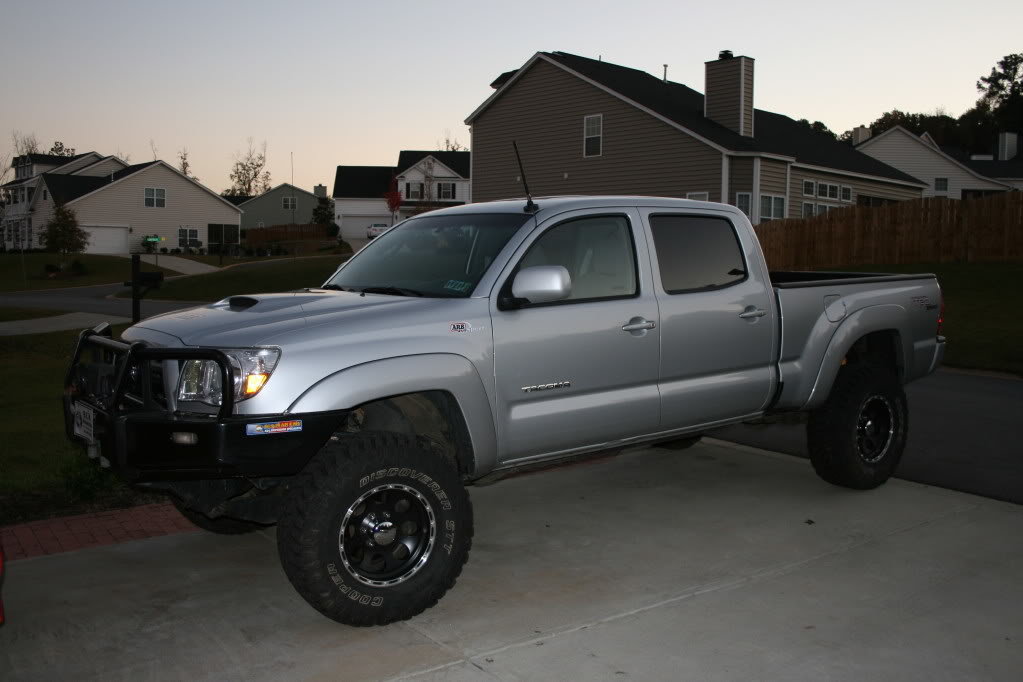

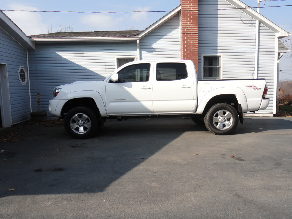

    Only problem with that is a 3" lift only uses a 1.5" spacer so that only limits your travel 1.5" and I would like to add for all you 5100 billies lovers, they may work fine if you ride in sand and your looking for lightweight dune buggy type trucks. If you have a custom front bumper and winch set up that adds weight on the front of your Tacoma, Bilstein (5100billies) shocks may break. Again those set-ups are for light weight applications. It really depends on the type of off-roading you plan on doing. I live in PA and ride rough trails all the time. I use the Old Man Emu struts with OME 886 Springs with top plates. (Note: These struts have much more travel than stock) These struts / springs are made for the weight added by my 200lb ARB bumper and a 10K winch that weighs another 100lbs. Only thing that has gone bad was my wheel bearings and I figure after all the wheeling I do in mud, water and snow I'm doing okay. I bought it new in 2006 and now have 84,000 miles on it.
    Bad wheel bearing I just replaced:
    YES, these photos are over the last year and I have changed a few things on my Tacoma a long the way.
