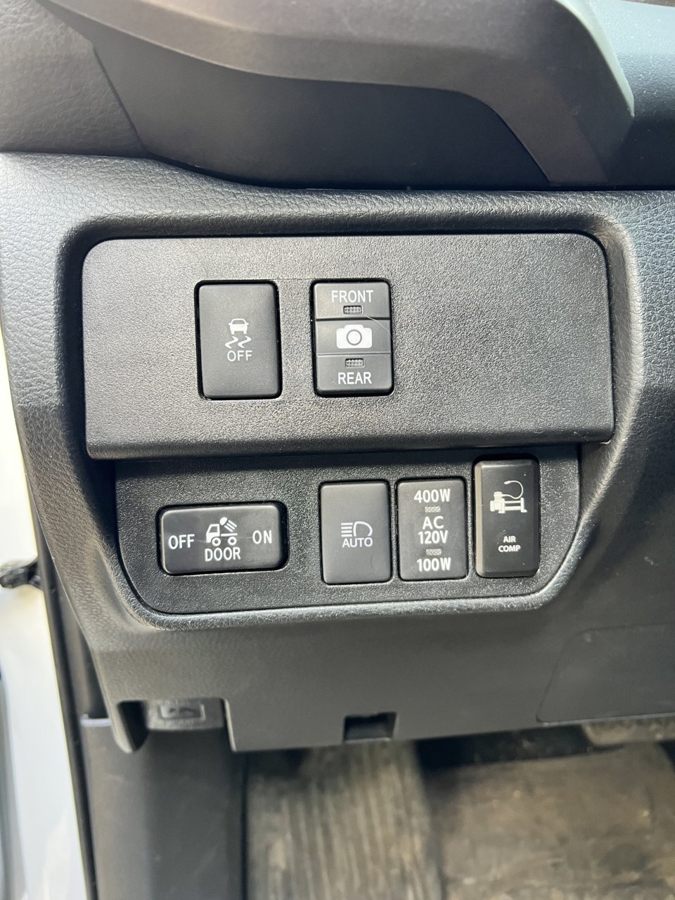

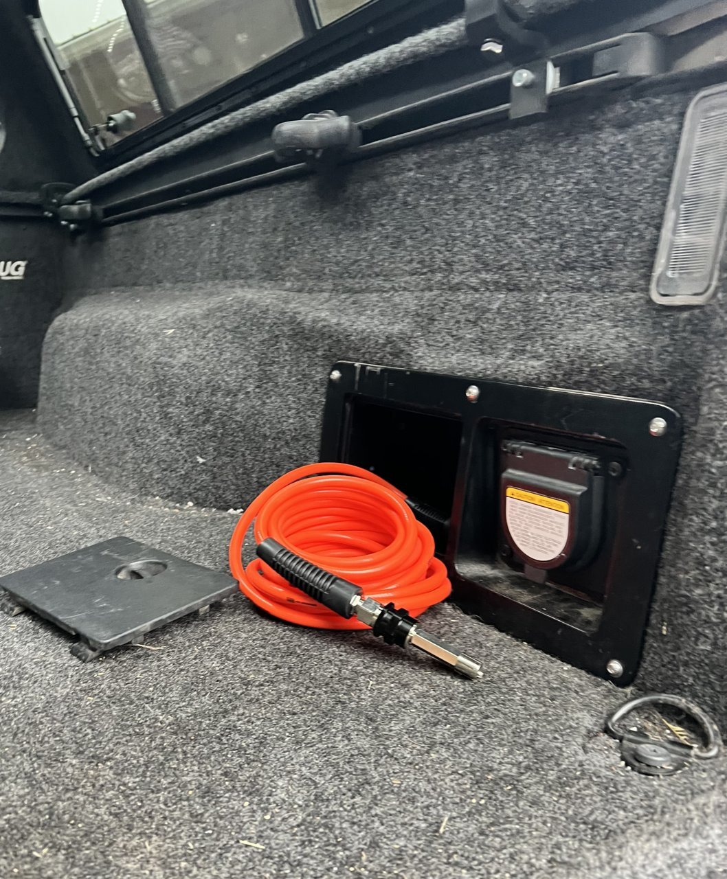

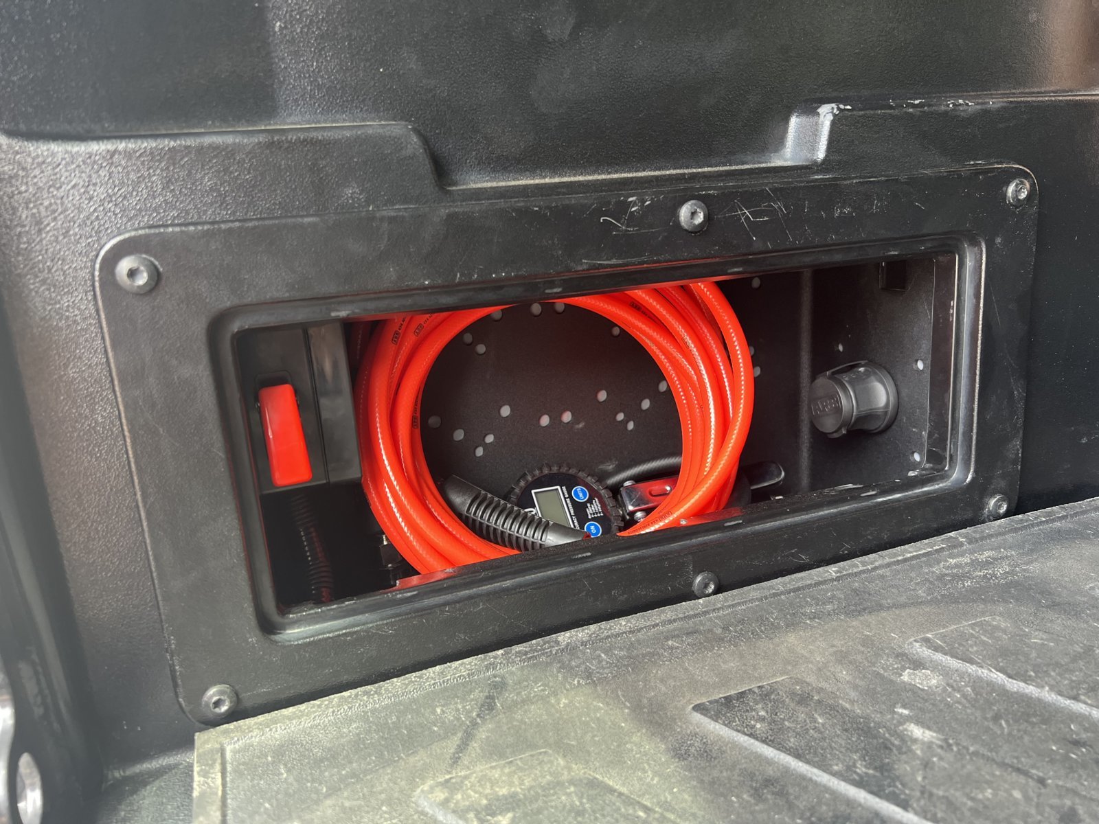

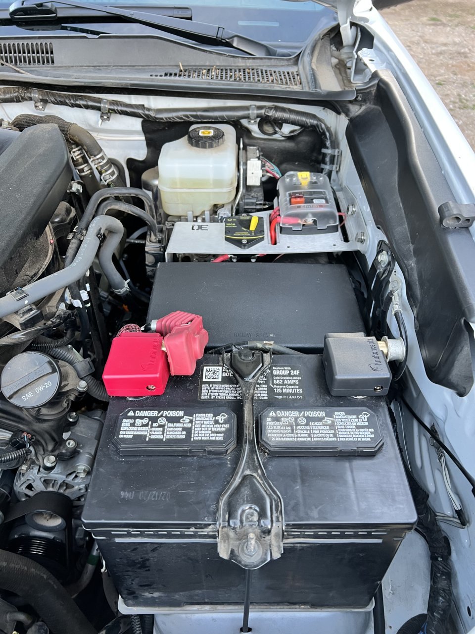

    I installed one a couple weeks ago. Instructions were a little vague, especially using it on the passenger side, but I managed to get a single compressor in there with the power outlet in its stock location and the hose connected and stored. It’s in solid with three bolts out of four right now, because I could not reach the upper rear. I’m going to remove the taillight when it gets nice out again, and see if I can access it from there. There seemed to be missing some “longer bolts” that I had to get for the four corners, but not a big deal. Wiring went smoothly. 54E7FDDD-880D-46B4-A2F7-416AC3A0876D.jpg C9F6FCD0-795A-44A9-97A0-C8492EB19C21.jpg 444CFBF4-ABF8-4445-9EAC-B163F15FA111.jpg

    I can’t quite tell from the picture, but do you have the compressor wired into the Blue Sea box with a 40amp fuse? I was going to try a 30 in mine to stay within spec for the box. ARB shows the current draw at load to be 23A so it may work. I know the in-line fuse is a 40.

    Good Eye. The only reason I used a 40 was because that was what was in-line, and I was unaware of a Blue-Sea 30 amp limit. Perhaps I’ll change that. Thanks.

    I installed this today and fucking around with the expedition essentials one for a few hours and it is way better quality. I think it drops a little lower so I'm not 100% it'll clear a high clearance bumper which I guess I'll find out soon...
    But build quality is higher, the documentation quality is higher and the install method is way better than drilling 6 holes that clip through the box.

    Question, how in the heck did you tighten the upper nuts? I'm real close to drilling a few small pilot holes sending a few self tappers through the bezel.

    I used a 10mm closed end wrench from inside the box. Theres little cut outs so you can reach the backside of the nutzert from inside.

    Ah, that's where I screwed myself by using a smittybilt compressor, had to mount the compressor before mounting up the box itself. I'll give it another try

    I put in an ARB twin and it’s mounted before the box too but there’s just enough room to get a quarter turn on the wrench 30 times.
