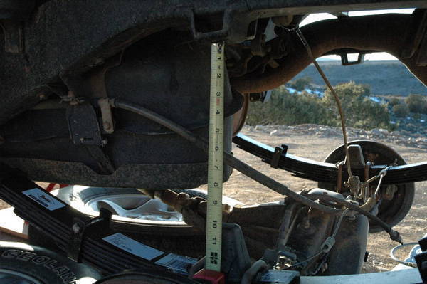

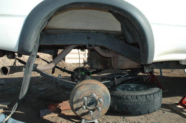

    So I'm getting around to putting some All Pro Exp. Springs on my 1st gen:D.
    The way I've been spendin' money on er' I'm thinkin' of callin' her the "White Horse"
    Anybody got a better name? :facepalm:

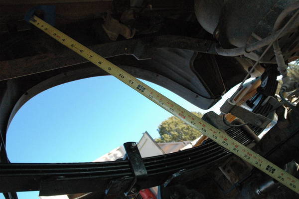

    Full Droop:)
    Full Droop 24.5" I like this for starters anyway:cool:
    Springs have a sweet looking arch huh :thumbsup:
    Putin' some 5125's on er' today

    How those shackles workin' out?:cool:
  4. Feb 19, 2012 at 11:07 AM
    Rucas
    Rucas 1st gen > 2nd gen
    Dec 5, 2009
    #27040
    4,040
    Lucas
    Northern Colorado
    1st gen. 4x4 MANual
    sparkles, fairys, and happy things.
    dont get them. their shit.
    haha
    Install was a pain, because the gap between the shackles was not the right size (and this is how they all are). We had to shave the bushings in the leafs down so their pretty thin and and useless. I would get a 2 peice shackle design if i were you.
    Im looking for some new ones that will work with stock leafs and bushings.
