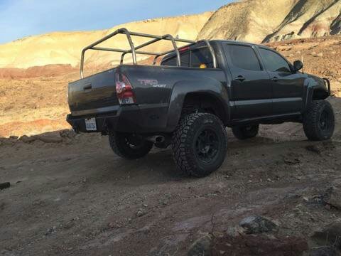

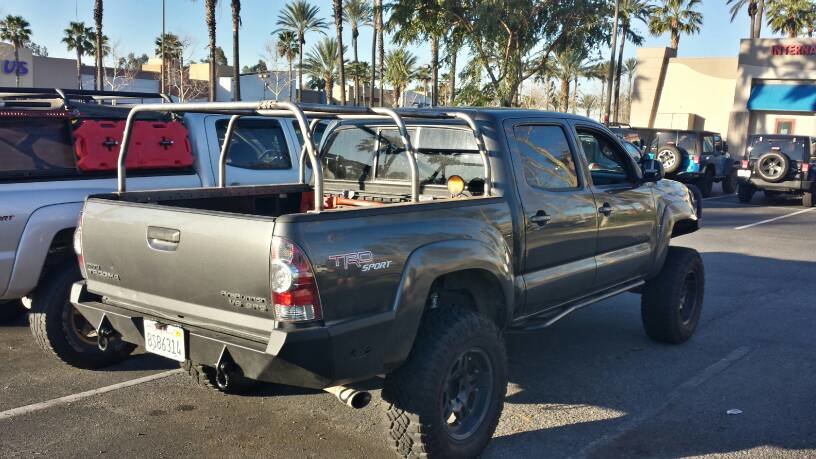

    Just welded mine up yesterday. Waiting on paint and eccessory barsaf09b68e1ccc57d0455697294cc07348_ff7f1bc011375040493a254e1f42ce7a2274be9f.jpg

    Looks great!

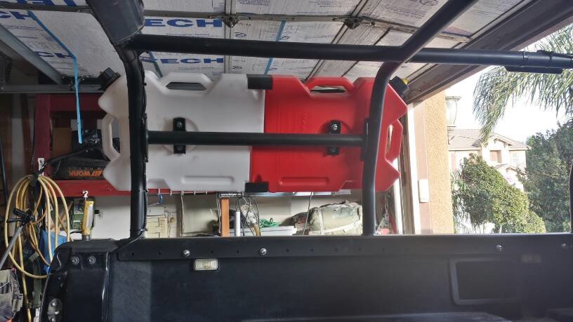

    Is it possible to get a custom order of bed rails, only 2 bars at a specific height and 2 connecting bars at a specific length? Trying to set up a custom rotopax mount system just behind the cab without a full bedrack. 4gallon fuel just behind roof line up top, with 2 gallon water on each side. So 2 crossbars 14-14.5" apart to perfectly house some rotopax inbetween them, then the 4 gallon up top width wise just behind the roof line. Whatcha think? Could we work something out?

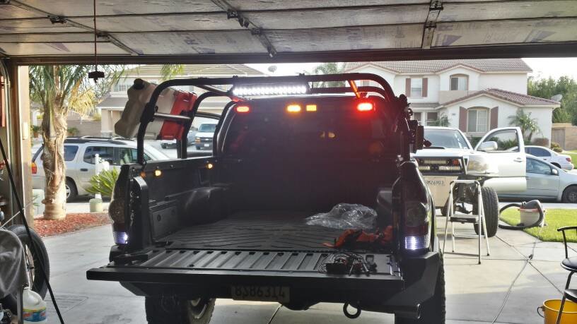

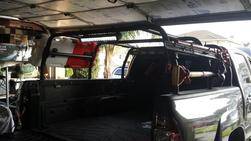

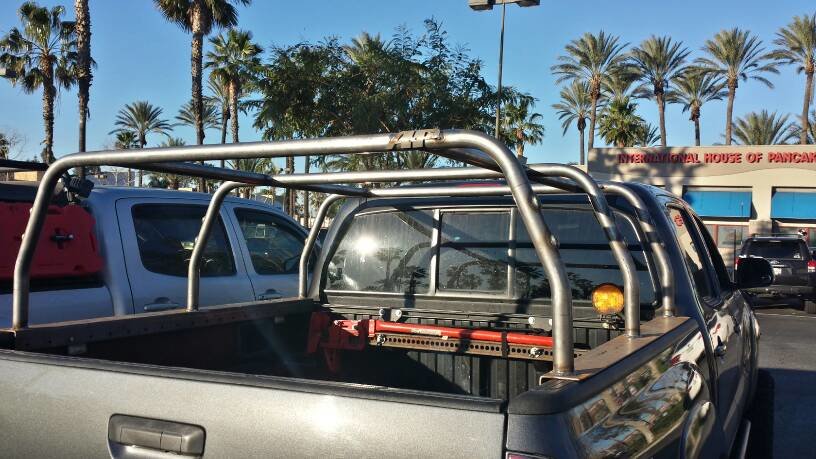

    I dont see any reason why you couldn't. The middle bars would just overlap but still bolt on fine. But if you have s short bed there isnt much use for 4 bars because anything you put on them is way longer than the bar anyways if that makes sense. Heres mine you can see even with a 2nd set of bars it would do me no good

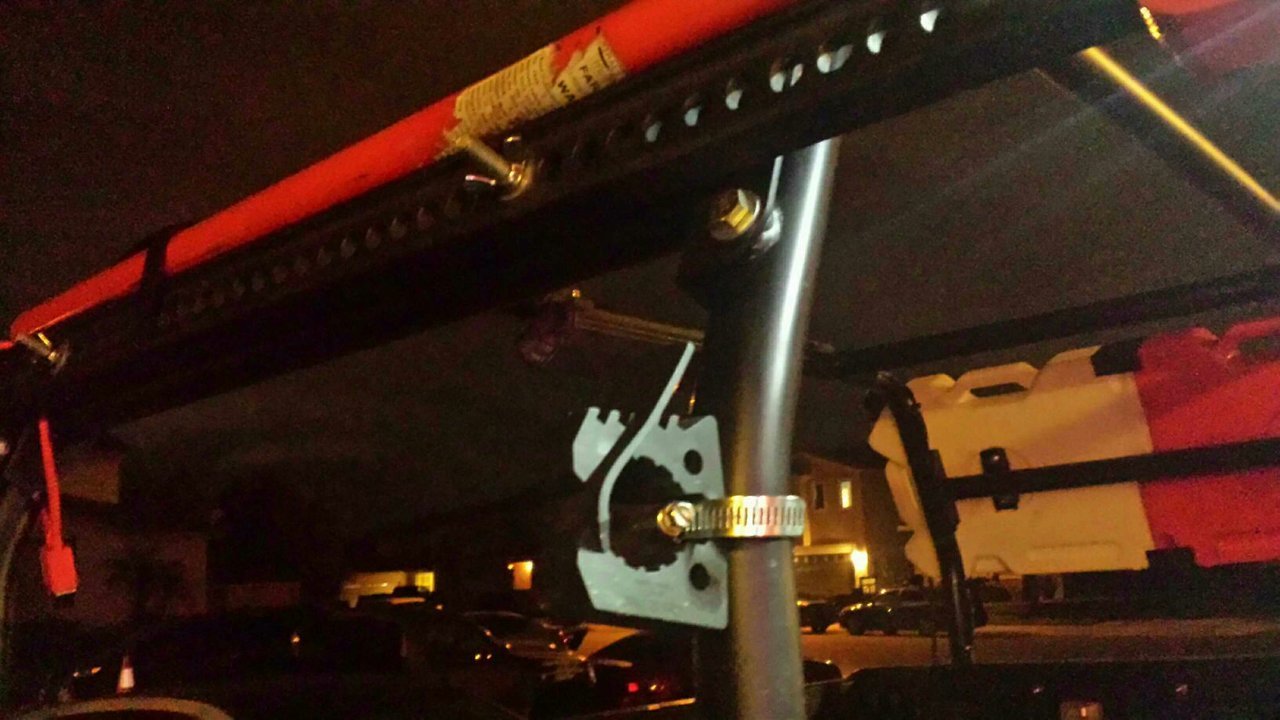

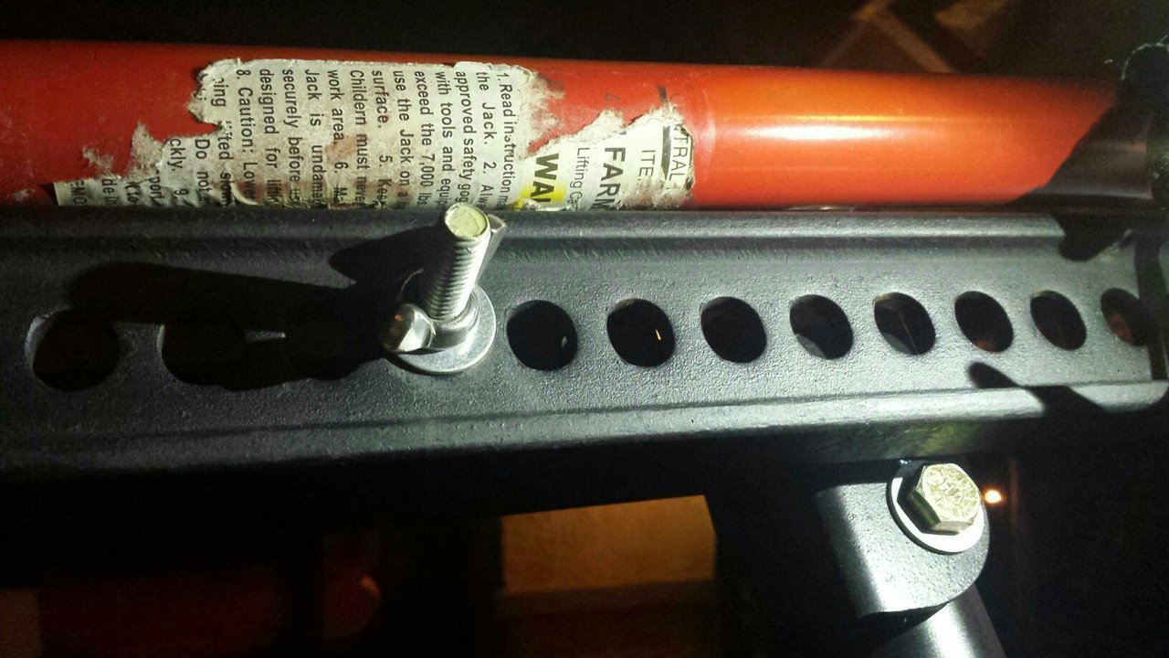

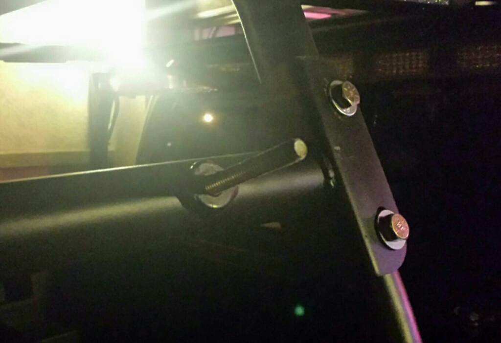

    Very nice setup! what did you use to mount the HI Lift?
    Yea I have a long bed and was hoping to get the rotopax cans on both sides on the rear portion and shovel/axe and HI Lift on both sides on the front portion.

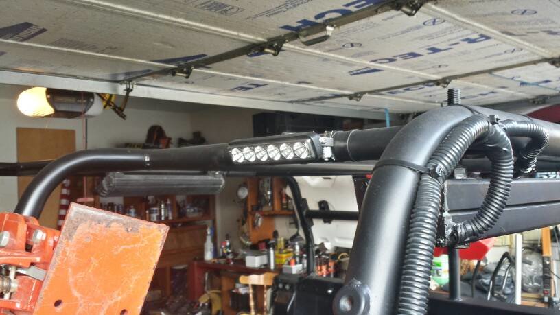

    The accessory bars have weld nut inserts already so i got a threaded stud and some wing nuts for the hi lift. For the shovel i used quick fist mounts attached using hose clamps cuz i didnt wanna drill into it. See pics

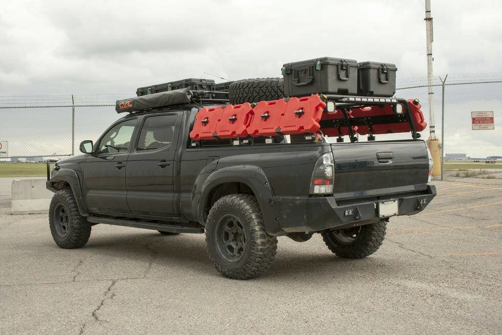

    But even with a long bed you wont be able to fit a hilift/shovel AND rotopax on the same side. You'll be lucky to fit 4 gallons of rotopax on the same side. This is a pis i found online to give you an idea. But that's not an AP rack its custom i think

    I knew that truck looked familiar.... :D, That is in fact an All-Pro rack but all the mounts were custom made. You could get the hilift above the Rotopax but would be more on the top than the sides. I mounted mine on the inside along the bed-rail with a shovel, axe and fire extinguisher on the opposing side.
    Checkout this link for more details about the build and its parts: http://www.keyboe.com/mainsite/beast.html
