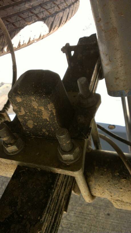

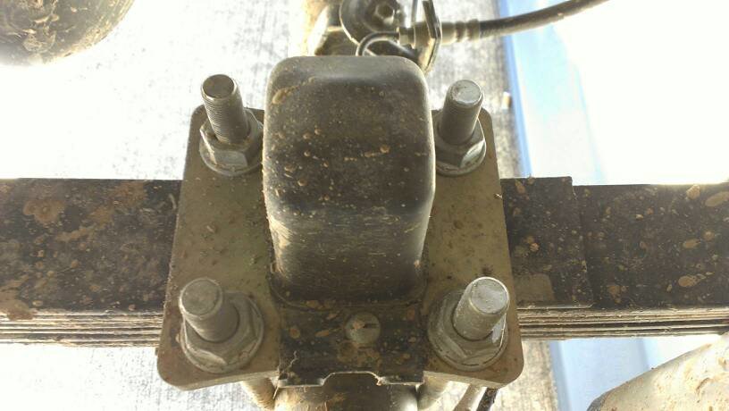

    I have my stocks bumps with the flip kit. They actually sit quit nicely right between the bolts and I just drilled a hole in the plate and used a bolt and nut to hold the bump. You could also tack weld the stock bump to the flip plate. So yes u can easily still use your stock bumps. As for the shocks, I'm not sure what length the walker evens are but that leaf pack yields 11" of travel, so to answer your question, a 10" shock would be the limiting factor in travel. In that instance, limit straps would be a good idea but imo not necessarily needed depending on what u do with your truck.

    perfect man it was exactly what i was looking for. now you say that you ran a bolt and nut to hold the bump or you plate in place? would you happen to have a picture of this?

    Here ya go ......

    ok man thanks i really appreciate it so gow many bolts do you actuallt have that hold it down? from the pics i can imagine you have two. is that enough?

    I actually only have 1. I kinda didn't think about it till they were already on and I couldn't get my drill in on the other side. Lol but that one had been there for about a year now and I drive a lot on road and offroad and they are still there. Lol
