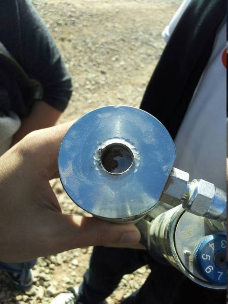

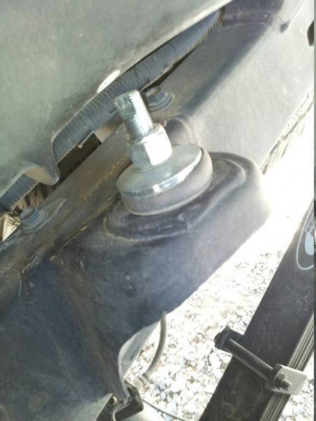

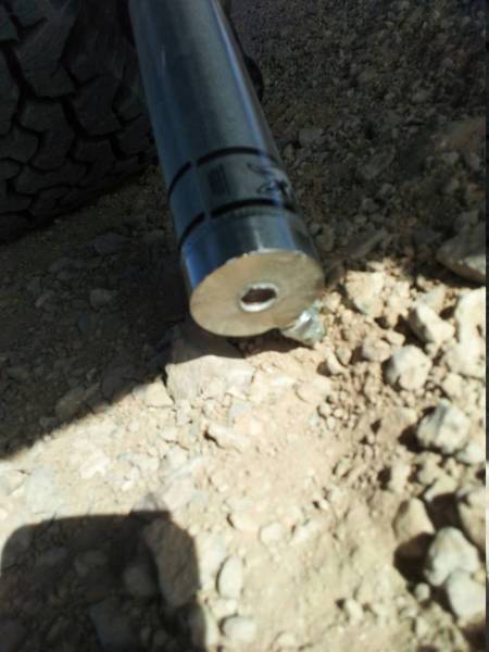

    Ok, so I purchased these shocks for myself and had them installed on 2/7. To be honest, I was quite satisfied with the feel and performance for the two days I had them. I had seen this thread prior to the install and had the shocks installed accordingly. Unfortunately, I was out on a mild trail today (Sunday 2/9) and I experienced an equipment failure with the driver side shock. The top mounting stem snapped right off the top of the shock weld. Inside of this weld was rust and it appeared to have a defect.
    Seeing that it's Sunday, I understand All-Pro and FOX suspension are closed. Hopefully I can get help tomorrow and can get a replacement as these should be under a warranty.
    I've attached pictures. Wondering if anyone else has experienced this problem :(

    well, I've never seen THAT before.
    fox warranty time

    that's not a snap, that stem is pressed and crimp peened over, more then likely was pulled out due to the shock being the limit strap. btw, if your trying to make a case, perhaps removing the photos of you in the air may net a more believable story.

    This is so so so crappy and we are so sorry this happened to you. As you know we just sell these shocks but they all come from Fox. We will be calling you today in order to get all the info we need to get Fox to send a replacement ASAP. We will do everything in our power to help fix this with Fox.

    The jumping pictures are older and taken before this new setup. These shocks were on my truck for two days (an invoice to prove it) and they only saw the street and one trail. The tires never left the ground.
    That aside, there is rust shown in the pictures. That doesn't happen in 2 days. I am confident that All Pro and Fox are both reputable companies who can help correct this faulty.
    Thank you for following up and I appreciate your concern. This post was for a reference purpose and NOT to tarnish All-Pro or Fox. I'll be keeping in touch, thanks again!

    Update: All-Pro handled the situation and got in contact with Fox. Fox will be warrantying the shock.
    However, I'm still worried about how close the resi elbow is to the mount. Hope it doesn't happen again. They say these shocks are meant to be installed on our Tacomas without any modifications and I opted for these because I like the piggyback mounted on top rather than the bottom. Anybody else running these shocks that has done anything different to insure a better fit?
