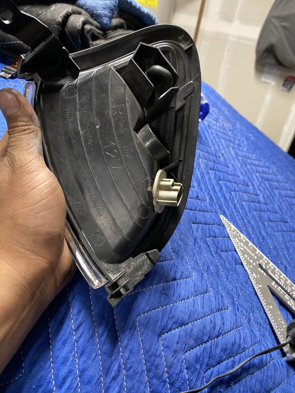

    If you're looking for something to do with your turn signals, try this:
    Just cut off the mount for the light plug from the turn signal housing, then drill a hole just big enough for the bulb to fit through the corner marker light housing.
    It'll take a bit of futzing around with shaping the bulb mount, but nothing a dremel sander can't fix. There isn't a lot of room in the housing, so make sure you leave as much of the original turn signal housing as you can (the grey part).
    Then I used some 2 part epoxy to fix it in place. I "tack welded" it with a few small globs of it to make sure the fit was good, and the bulb fit in the housing. Then just glob on more epoxy to seal it up.
    My CBI bumper came with LED turn signals, so I just spliced those in with some quick splices.

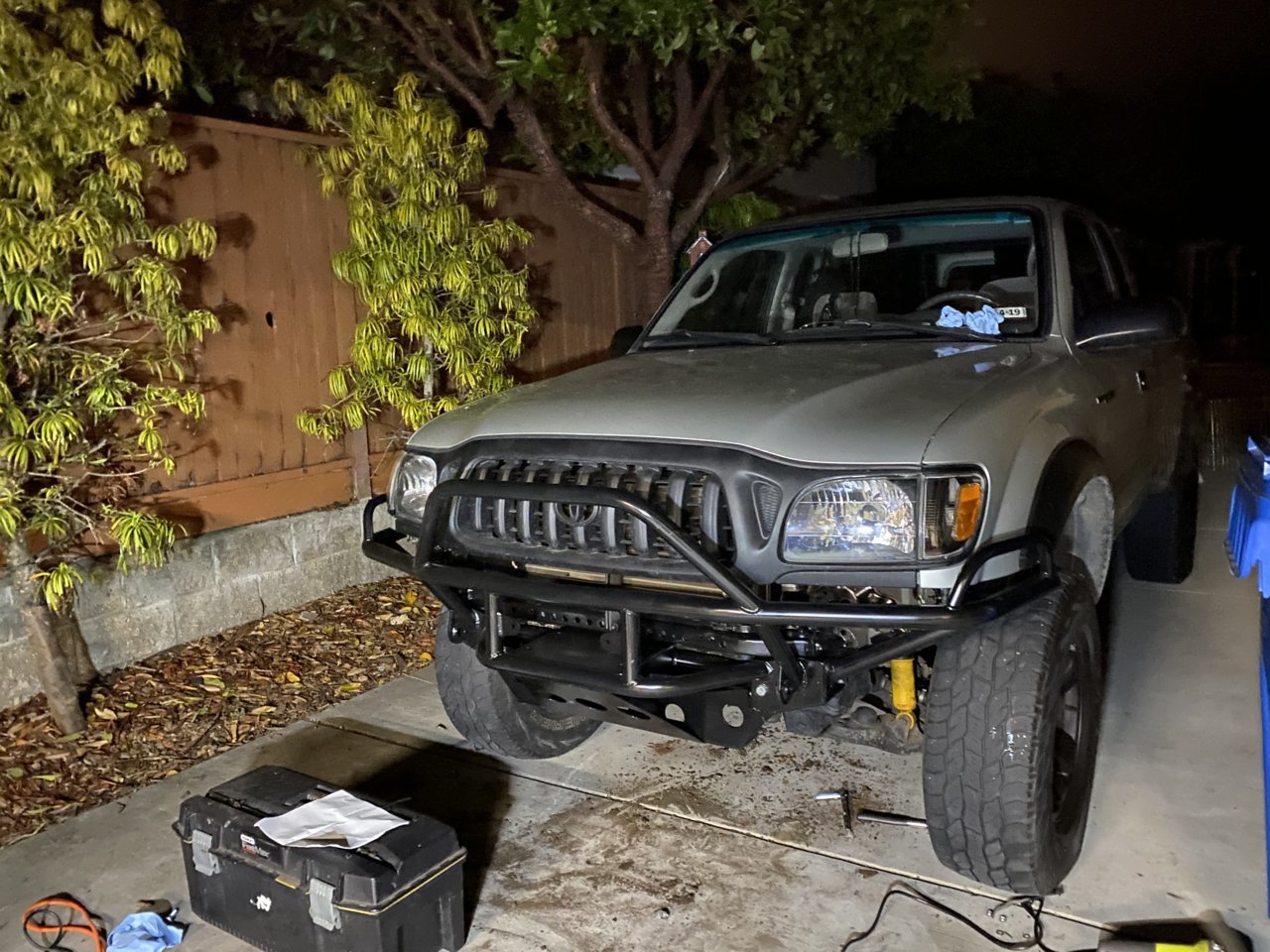

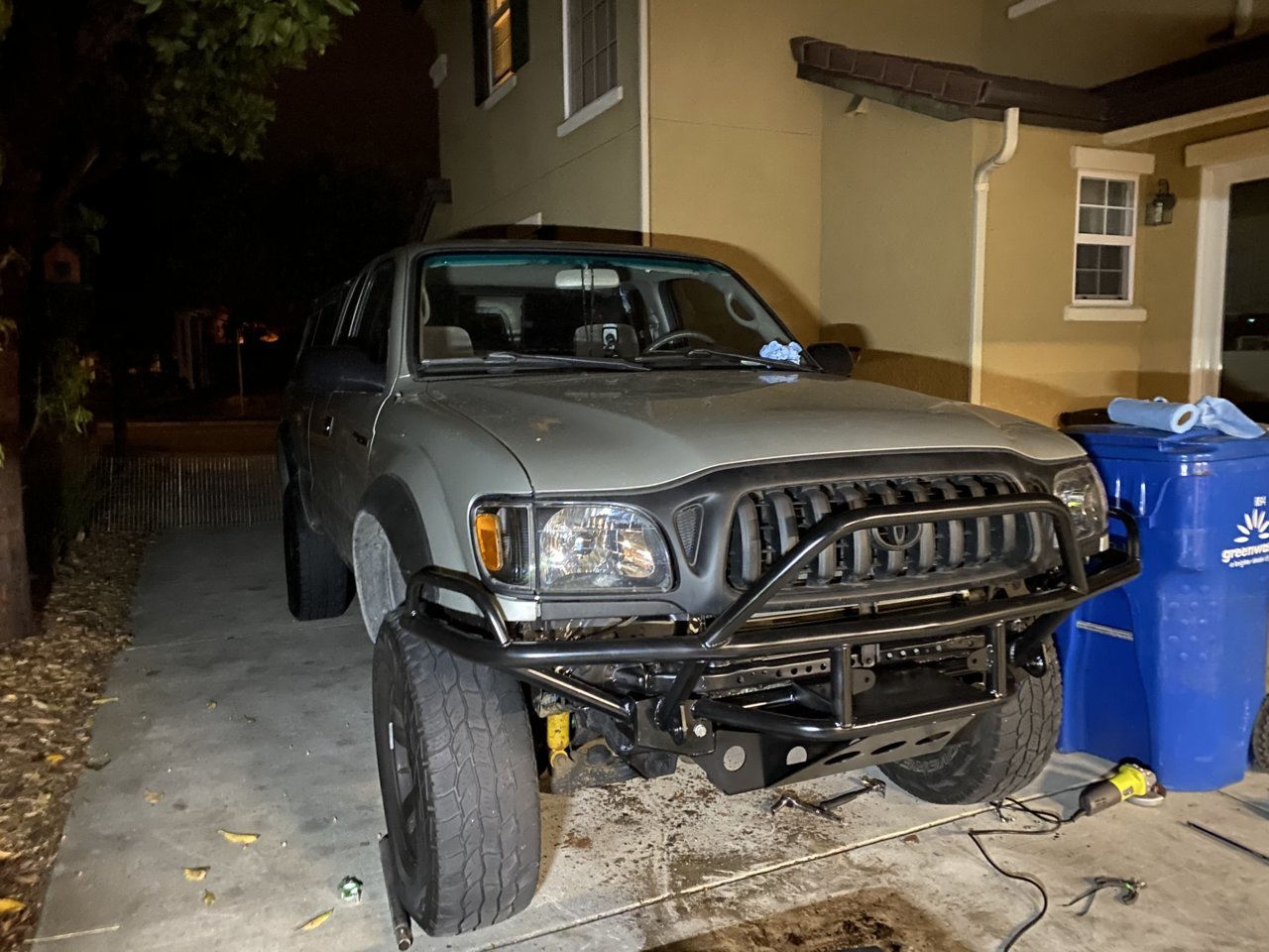

    969B6157-C460-460E-9C03-33A8A0DAE7B9.jpg 28DBEBE7-B5A6-4093-8050-DCD39EEFE661.jpg
    So i just finished mounting it all on and it looks great i will be taking better pictures tomorrow, after i install my winch . Any recommendations on a winch ? And also what did y’all do with your turn signal lights . I was planning on retrofitting my lights so i can incorporate the turn signal to my corner light. Though if theres something better let me know

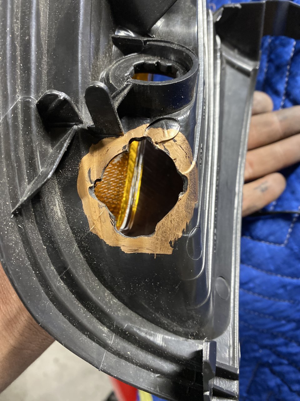

    All these ideas where great i ened up cutting into the corner light housing with a dreml set , was able to get the exact cuts and lines to just push in and twist . Now i just need a shorter light or led , or just push it futher back
    It aint the pretest but its working great

    Nice!
    That's another method I've seen too. Only reason I didn't do that is I just didn't want to bother with to bulbs. And LEDs would require a new flasher too (to prevent hyperflash)

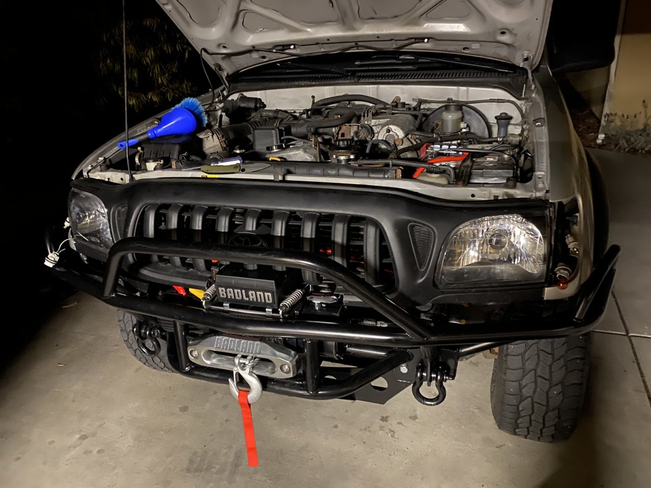

    I just finished putting on the winch i ended up going with Bad land brand .. my buddy has one and hes been using his for a year now And no problem. Ik its a harborfrieght brand but if it works it works . Here are some pics im putting my prinsu rack on tomorrow and the led bar ,

    looks great, I'll be interested to see how that Badland Winch is for ya. I've stayed away from those for fear of getting that famous Harbor freight quality;). I've heard good stuff from a lot of people though so I hope it does well for you.
