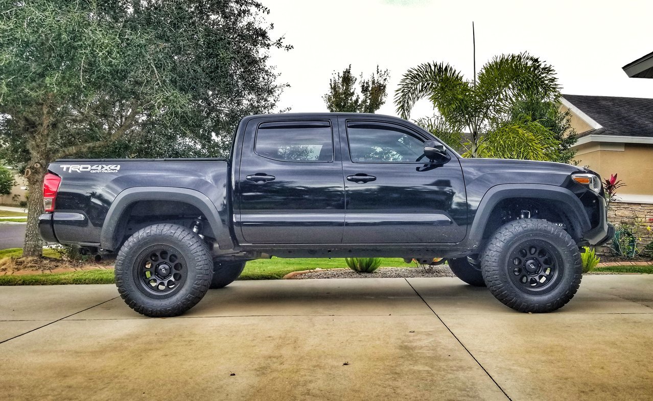

    Anyone on here have the All-Pro standard leaf pack on their truck?
    Mine make a lot of pops and clunks and it is highly annoying. I tried using some dry lube spray on them which hasnt helped at all.
    I'm wondering if I'm the only one and if so, I'm wondering if I should email All Pro and see if there is a fix.

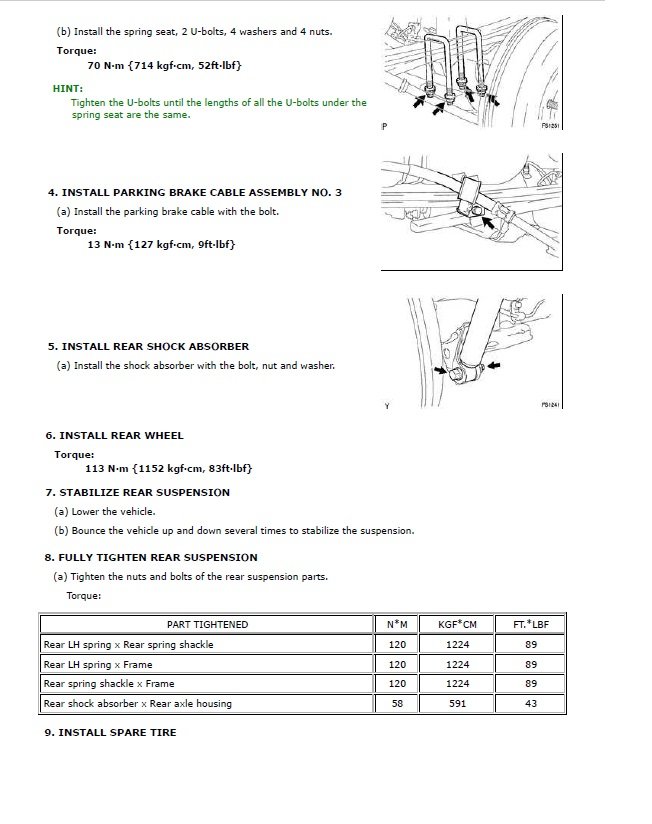

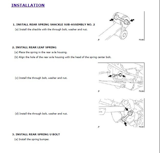

    I just want to clarify that in your first post you said you were having pops and clunks and people started suggesting solutions to squeaks (which could likely be a completely different issue). Although still really good info, squeaks would come from friction (usually metal to metal) but clunks would most likely come from sudden movement and contact. You said you only have 1000 miles on the pack-did you re-check torque on everything after install? I would highly recommend you check the torque specifically on the u-bolts. I don't know the exact spec but I used a breaker bar on mine and torqued the living shit out of them and it solved my rear clunking.
    (edit: posted by @splitbolt above: 53 lbs, but mine are a lot higher than that)
    It seems that the solution might be at your fingertips and people could have unintentionally steered you another direction.
    Just to cover your bases, give the leaf pack a coat of fluid film making sure to spray the spring retainers and places where the u-bolts could make contact with the pack near the axle.

  19. Feb 16, 2018 at 9:50 PM
    #19
    splitbolt
    splitbolt Voodoo Witch Doctor
    Mar 7, 2010
    #32761
    7,858
    NW Arkansas
    2016 TRD OFFROAD DCSB MGM
    Are you using shocks compatible with the lift?
    I posted the OE instructions...
    I just wanted to add aftermarket are usually up around 100ft/lbs; not 52ft/lbs like the OE.
    Are your shocks compatible with the lift?
    GHOST SHIP[QUOTED] likes this.
