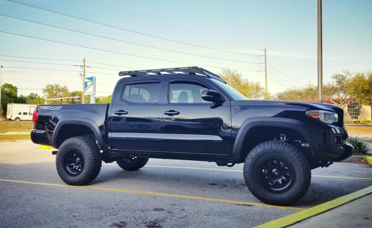

    20181007_105516.jpg Any luck with the original issue? I'm getting the same thing. I sprayed with lube and seems better but still get it. I got the exact same setup. Also put in the 3 degree shim because of vibration.

    Can’t stand my all pro leafs. The pack is too thick, with super bumps and flip kit I’m definitely losing travel. Mine pop constantly. I don’t think OP has anything wrong structurally or with his installation. I think all pro had shotty manufacturing over the last year or two. I’m switching to Dakar’s

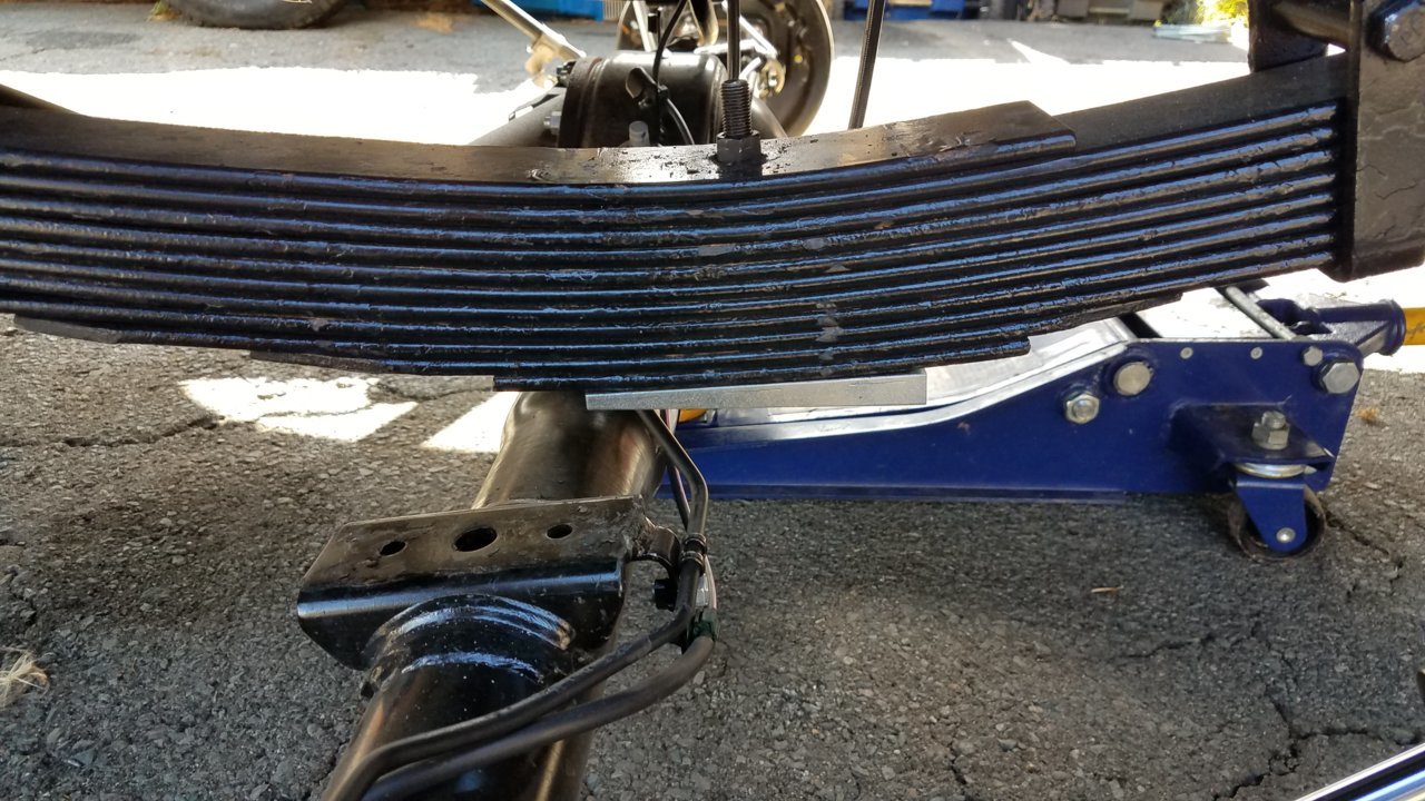

    upload_2021-4-12_7-44-23.jpgI installed the RXT leaf pack at option two on my double cab long bed and got 24 1/2” on the driver hub to fender and 24 3/4” on passenger hub to fender. I gained exactly 2” of rear lifter over the Deaver 66 that I took out.
