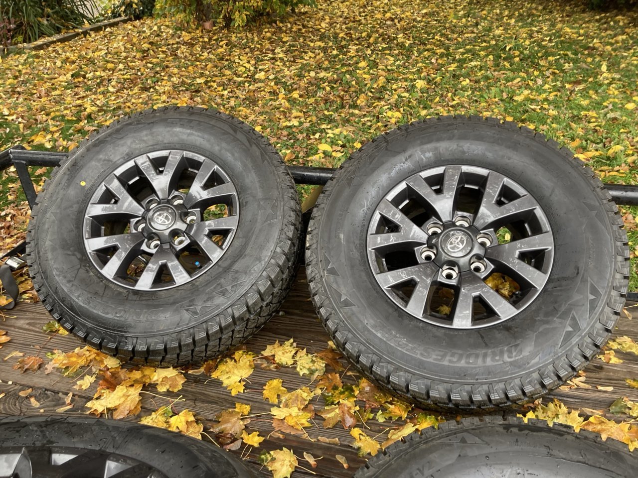

    These are my stock alloys that have been my 2013 since new used Vermont. Exception was 2 Winters I had another dedicated set (14 &15 Winter).
    Now I only run one set because the truck only gets used in Winter primarily. I feel the old TRD OR faired better than the Sports. Many sport wheels were warrantied in 2GEN.
