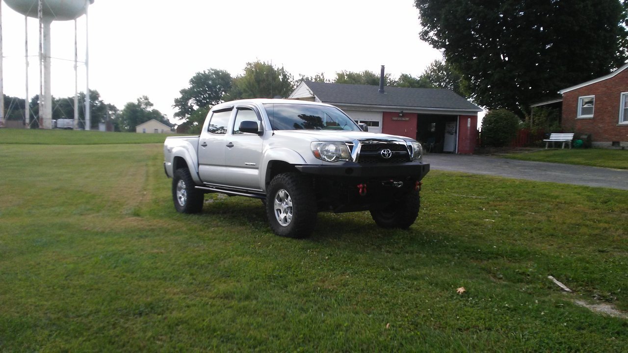

  4. Aug 20, 2017 at 7:12 AM
    Bluegrass Taco
    Bluegrass Taco Politically incorrect low tech redneck
    Jul 27, 2015
    #160391
    23,081
    Bill
    Mt Washington Ky
    2011 DCSB, TRD OR, 5100's, 885's 285/75r16 Cooper STT PROs.
    Only pic I have access to at the moment. Just put mine on last week. After some fussing and fighting, I managed to draw them into place with vice grip welders clamps. All the bolt holes lined up with the help of a drift punch. I got the bottom web almost tight against the frame, then drew it tight with the 4 countersunk head cap screws. Long story short, they fit, just with some struggle. Solid as a proverbial rock! I've used a HiLift jack and raised both sides of the truck from the sliders.
    Instructions say there may be some extra hardware. There is..... Always nice to have a few extra grade 8 bolts laying around!
    Worst part of install was drilling those 8 holes....(4 per side) into a weld seam in the hardened frame. I snapped a few drill bits....

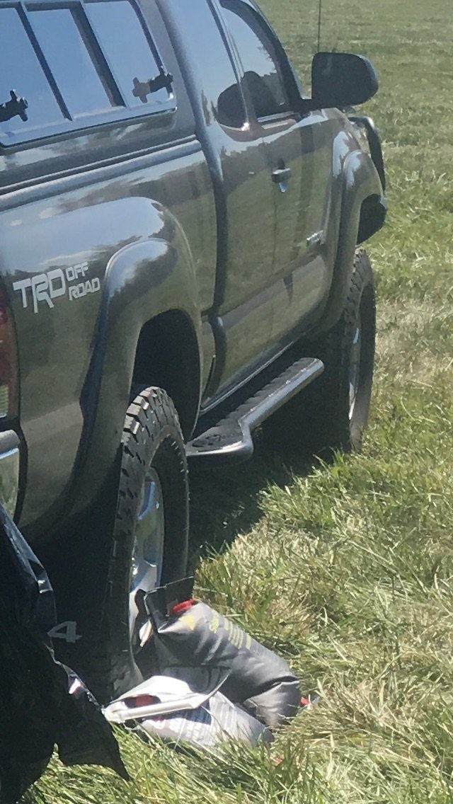

  8. Oct 31, 2017 at 8:53 PM
    TWENTYCO
    TWENTYCO Tree top flyer
    Mar 29, 2016
    #182739
    412
    Tim
    North FL
    2015 TRD Off Road 4X4 Acess Cab
    Plenty mods on many vehicles since 1982. Current: 15 Tacoma 4X4 V6 TRD OR Access Cab Pyrite Mica- Icon full stage 7, All-Pro APEX sliders & rear Expedition Springs + custom Tampa Springs leaf spring upgrades, Timbren bump stops, u-bolt flip, Road Armor front stealth winch bumper & rear steel, Warn Vr 8000, Nitto Terra Grappler 285/75/r16, Off Grid Engineering Dual Battery system, SPod 6 switch, 2 pairs Rigid D2 spot & flood in bumper, ARE Expedition Cap, bedglide,Tru Cool 45K GVW add on transmission cooler, Re-gear to 4.56, rigid rear bumper floods, scan guage II, rigid ditch lights. full size spare on matching factory wheel, seat mods/insert, CB w/magnet mount.
    1C754C56-B62B-43AF-9F1A-D244E92D5770.jpg No matter how you have them mounted, bolted or welded, they look great and work perfectly!
