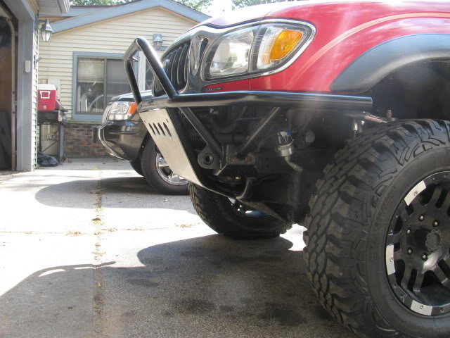

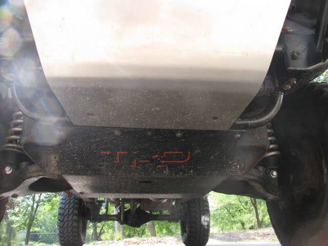

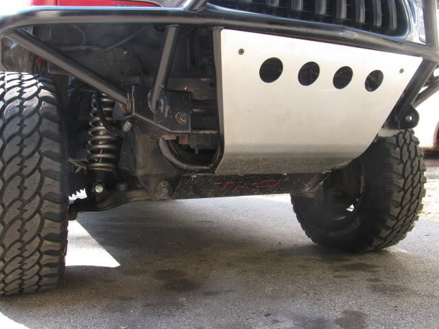

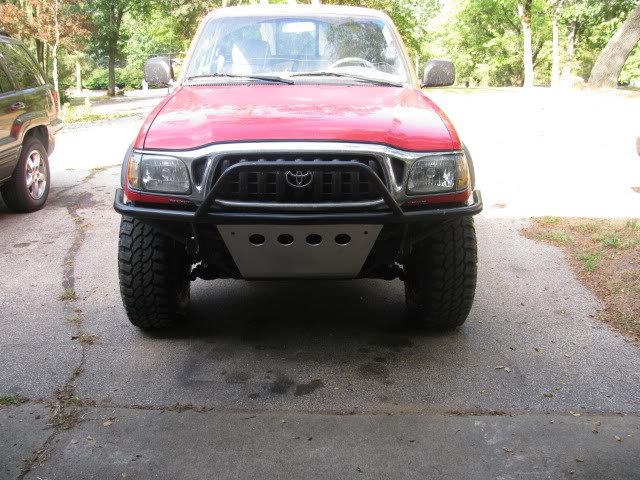

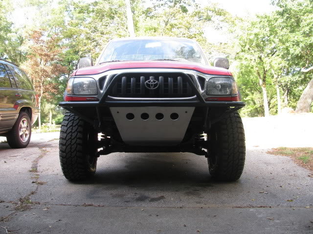

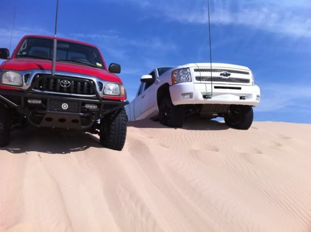

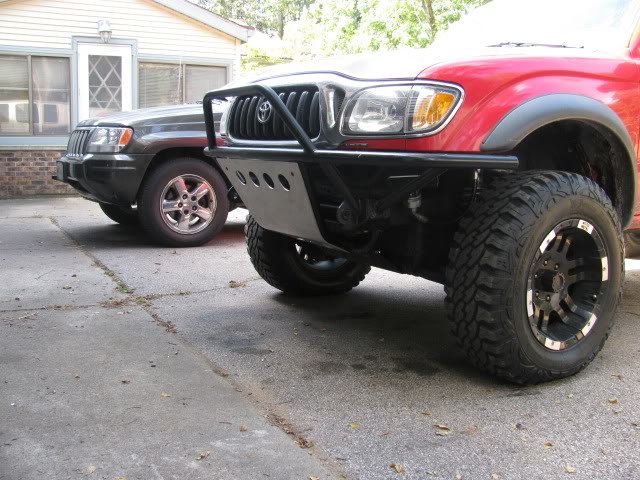

    So I have a few PM's wanting info and pics of what we did to my bumper. The bumper started life as an allpro without the side hoops. I was always looking for a more prerunner bumper.
    66490_439982776645_503491645_5831837_172_4da2f0f62212fc810511fbb9a839375c91395888.jpg
    The winch setup on the allpro makes the bumper stick out in spots. This caused me to smash the front skid alot in the dunes. Since I changed my mind about a winch there was no need for it.
    I had Lenger Racing [http://lengerracing.com/] in Grand Rapids, MI change it into something that better suits my needs. They cut out all the winch plate stuff, moved back the lower hoop, cut my allpro skid back to tie to the lower hoop, bent tubes to go from the upper and lower, and made an skid. Cant be happier with it I was even able to keep the clevis points and the approach angle turned out great.
    After a weekend at the dunes a didn't even hit the bumper/ skid once. Before I had to take the bumper off after every trip and bang the 3 hole skid out.

    Looks like they did a great job!
    I'm sorry, probably a stupid question but it's driving me nuts... what the heck is that?? haha

    Guessing the "Supercharged" decal that comes with the TRD s/c

    looks good!
    The way the skid on the AP bumper sticks out is a reason why I am probably going to go with a trail gear lo-pro bumper when it comes time.
  5. Sep 12, 2011 at 2:37 PM
    fsbrain03
    fsbrain03 Well-Known Member
    Feb 26, 2010
    #32179
    2,848
    Plus it looks like the skid would crumble the first time it touched anything.

    There actually just little led strips.

    any fabricators out there want to make me a similar one?:D

    I'm guessing those are now your turn signals?

    yea I slapped them on for turn signal to keep me legal until I got a chance to do something else. I just kept them after I finally moved the bulb to the marker.

    glad i found this, i have always wanted to change my AP bumper to this style. i hate how they have that stoopid winch mount, it looks ugly

    Agreed. I am much happier with my bumper in its current form.

    Yea I wish mine looked like yours!

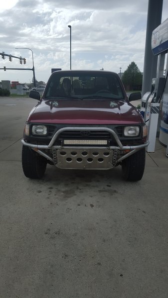

    It's all black noooe but that's we built

    It protrudes 4" and I drive a toyota.. meaning I don't need a winch. I've never done something I haven't been able to get out of. I'm not hatin on winches at all, just not my thing
