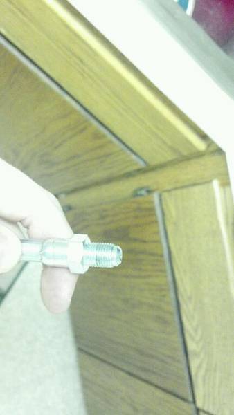

    Ok so this is the Male end (end that connects by the axle), of the AllPro rear brake line. The flare on the end is different that stock (stock one is flat, no bubble flare). Will it fit? If you have the AllPro one like this (hopefully) on your truck, please chime in to tell me if it works or not! Thanks!

    So I was told by a couple people the Bubble flare won't work, so I'm thinking of ordering a different brake line. I was thinking of getting the wheeler's one: but it says it's only 19". How much longer than this is stock? Is it long enough for the 4.5" of lift I got in the rear with the AllPro expo packs? Help!

    Yeah I was one of the positive reviews. Jon personally delivered my Expo packs and shocks to me here in Wyoming all the way from Cali on his way up here to go elk hunting last week. I know he's a cool guy, but I got kinda a lousy response from one of the sales guys (Kurt maybe?) It wasn't bad, just a little unhelpful... I just keep getting people saying "No way don't use it" and others (including allpro) saying "yeah it will work fine." Even my buddy who is a master mechanic, and all of his friends (WyoTech graduates) helping me said "No way it will leak." I'm just so confused.
