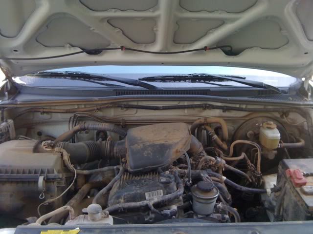

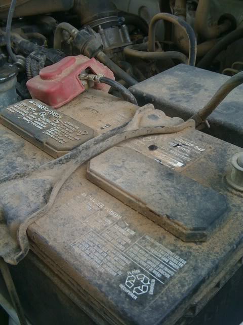

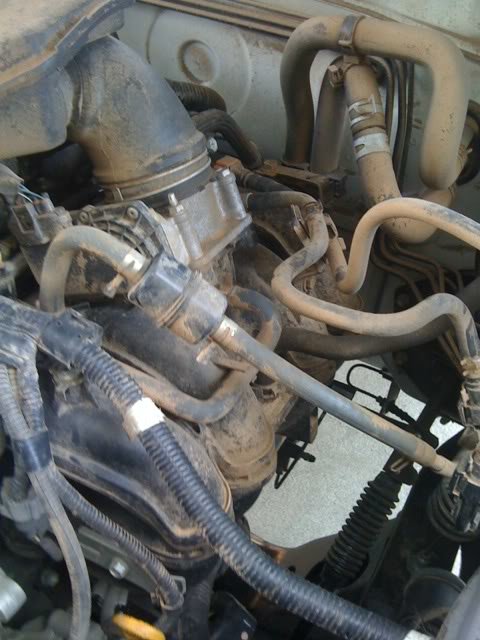

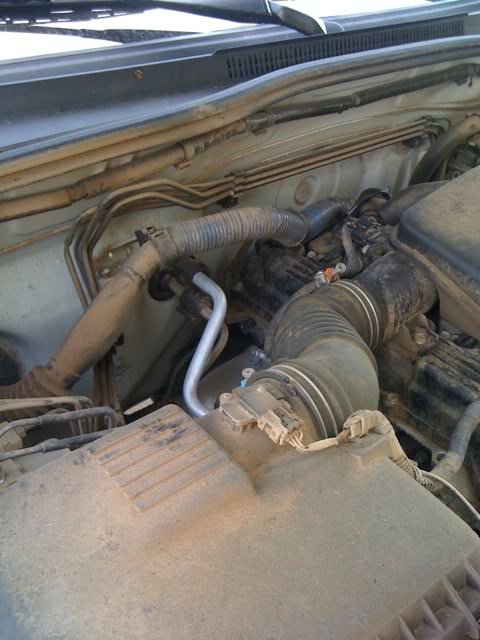

    Okay so everybody says to buy the engine cleaner and wipe it down with a damp rag, but if you can see by the pictures I have a lot to clean in many hard to reach places.
    I know many of you do desert runs and I'm sure you get this all the time....what do you guys do? Do you take it to those self car wash places and spray your engine bay with that stuff? I don't know. Help!
    Thanks for the help guys

    Did you try using a pressure washer?

    pressure washer... on low

    You bought engine degreser right. Leave truck on spray the engine stuff on then like solus694 said low pressure. Once clean I used to spray armoral all over. of course engine still on then rev engine few times. you want to leave your engine on if you get your plugs too wet it wont start.

    Alright got it
    • leave engine on
    • spray degreaser
    • pressure wash all the stuff off on low
    • keep engine running to dry stuff off
    Thanks for the info guys!
