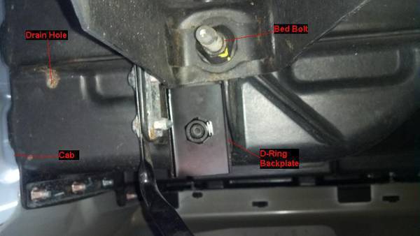

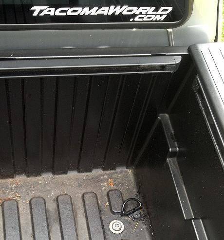

    I like Neubs' write-up on adding D-Rings to the truck bed but had my own reasons for not installing the D-Ring thru the bed bolt (my bed bolts are rust magnets, need rings to swivel, preferred not to dremel). Also wasn't a fan of the OEM location inside the wheelwell/sidewall as I wanted the D-Rings (PT278-35054) on the floor and a position where the backplate couldn't freely spin.
    Found a spot next to the bed bolt where the backplate fits with no wiggle-room, allowing for easy tightening.
    Tools:
    7/16" masonry bit
    T40 bit
    Torque wrench (set @32N-m)

    That's good, I wish I'd thought of that before I installed mine. I put them in the sides according to the directions included but your way seems like it would have been easier.

    How did this mounting location hold up for you? Is there a similar tight spot like this on the driver's side?

    Curious why a masonary bit

    5+ years and running strong. Have used multiple times and no issues/loosening this far
    Cause I didn't want to chew up my wood bits
