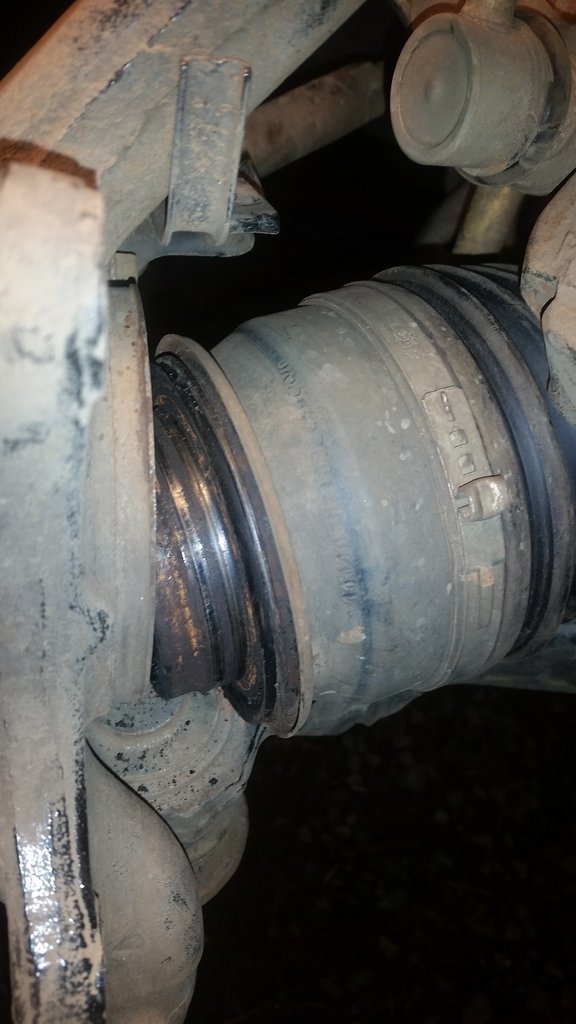

    I accidentally got into too much mud last weekend and now both of my front diff seals are leaking. While I'm doing it, I noticed the seal on the CV axle (90304-A0001) has NO rubber left on it. Dealerships near me don't have any. Does anyone know of a decent alternative from the parts stores?

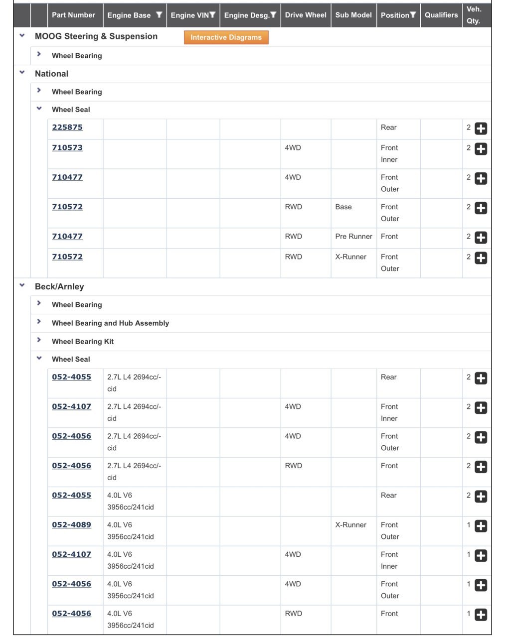

    Hm, I'm not sure that's the same seal I'm talking about? This is the one that actually presses onto the outer CV joint.

    The one on the CV is the outer seal.
    The inner is the one in the spindle.
    @6 gearT444E can correct me if I’m wrong here.
    I’ve always just match up the seals I pulled off.
    Toyota doesn’t make reference to Inner or Outer.
    They just call them Seal. I usually just point it out to the guy at the dealership on the screen.
    Or order the parts my self online off of a diagram.

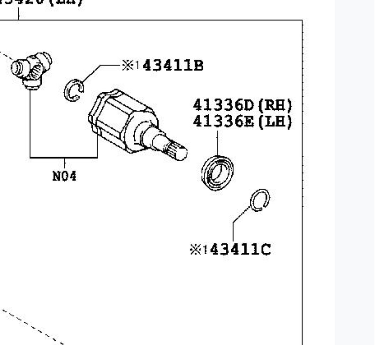

    Toyota calls that a dust shield. Although it’s more of a seal. I’ll have to see if I can find a PN when I’m at home. I don’t think there are any aftermarket suppliers of that but somebody must make it since you can get aftermarket CVs

    Part number is 4133604010

    That's the inner CV, isn't it?

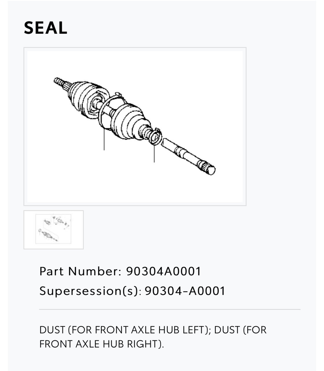

    Here is the outer “dust shield”

    yes I assume that what you were asking?

    Yea, that’s what I call it.

    If you can’t find it locally. Buy a cheap aftermarket CV and pull the dust shield off that.

    This is the seal I need. The thread posted above says it's 90304-A0001. Looks like there's no aftermarket alternative? Is that still the case?

    none I am aware of.

    You are correct.
    The link above doesn’t refer to that seal as the outer.
    Further research shows no results for an aftermarket option.
    Not unless you buy the whole CV axle.
    If you don’t have the money or time for an OEM.
    I’ve heard the NAPA HD Axles are pretty good for the money.
