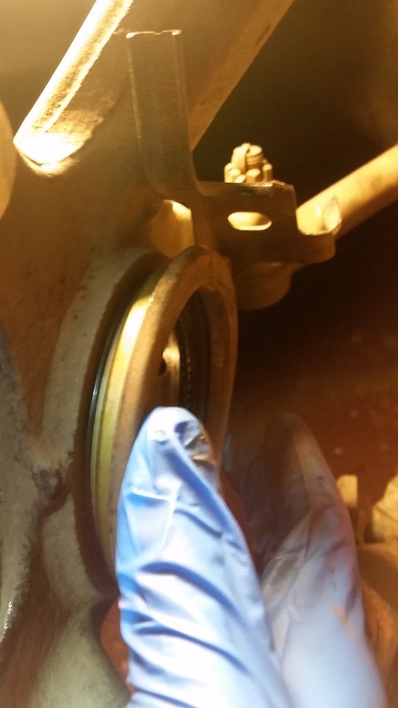

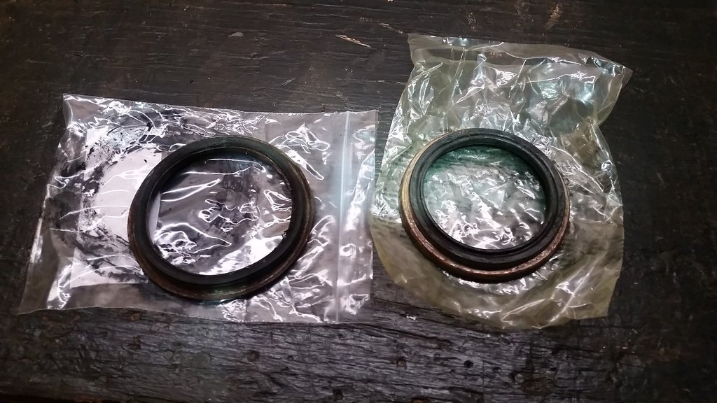

    Thought I'd share this trick I devised for installing the new inner hub seal (p/n 710573) and CV dust seal (p/n 90304-A0001)
    Utilizing the old seals, to install the new ones.
    Old CV dust seal on left, old inner hub seal on right

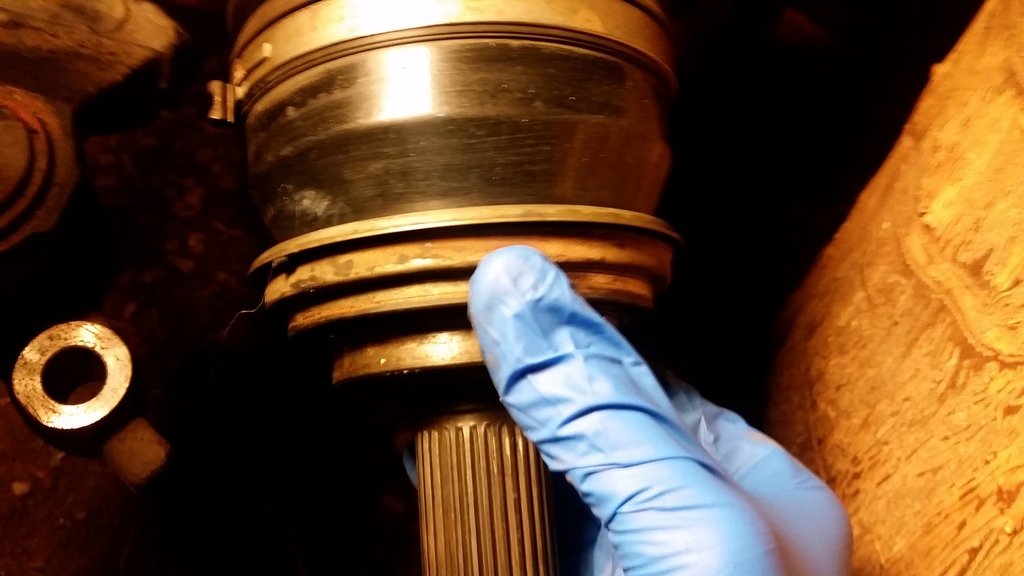

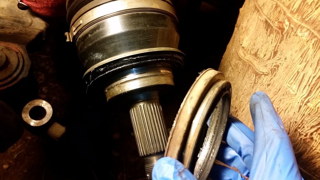

    First install the new CV dust seal using the old inner hub seal
    Place the inner hub seal over the new CV dust seal

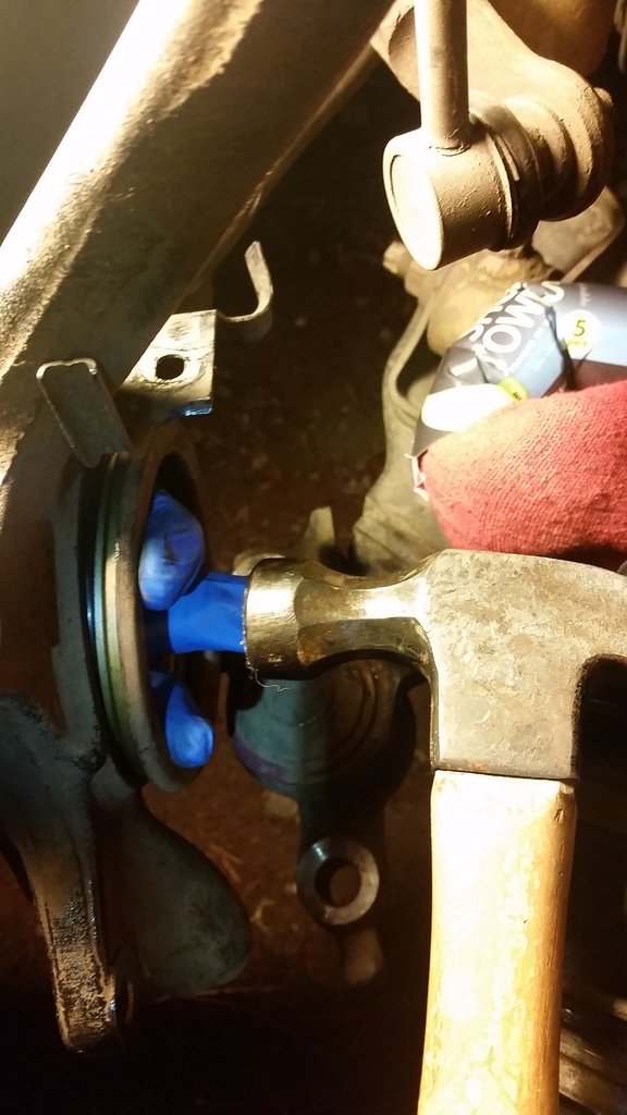

    Use a piece of scrap wood and a hammer and tap on CV dust seal until fully seated
    Fully seated

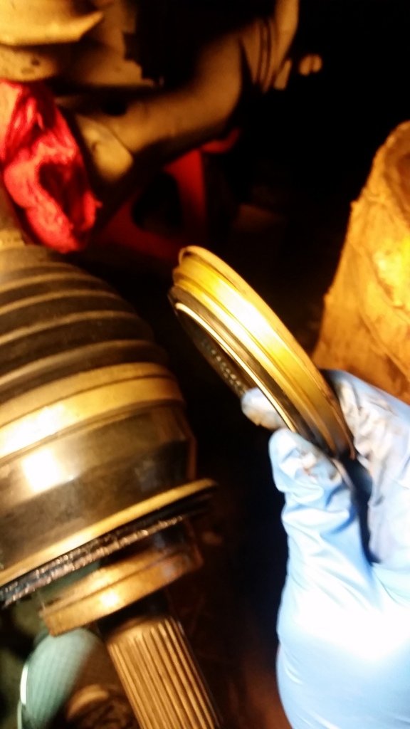

    Next install the new inner hub seal, utilizing the old CV dust seal by placing the old seal over the inner hub seal and place in position
    Next use the hammer and tap all around until fully seated
    Done! Hopes this helps, it made it pretty slick without seal damage

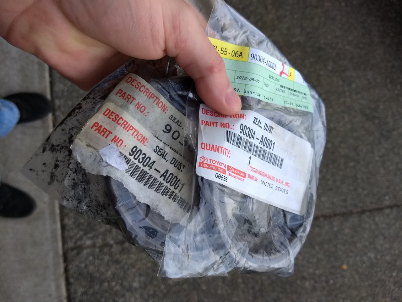

    Curious, are these Toyota part numbers or auto store numbers?

    Parts numbers referenced are Toyota parts numbers from the dealership. Glad this is helping folks:thumbsup:

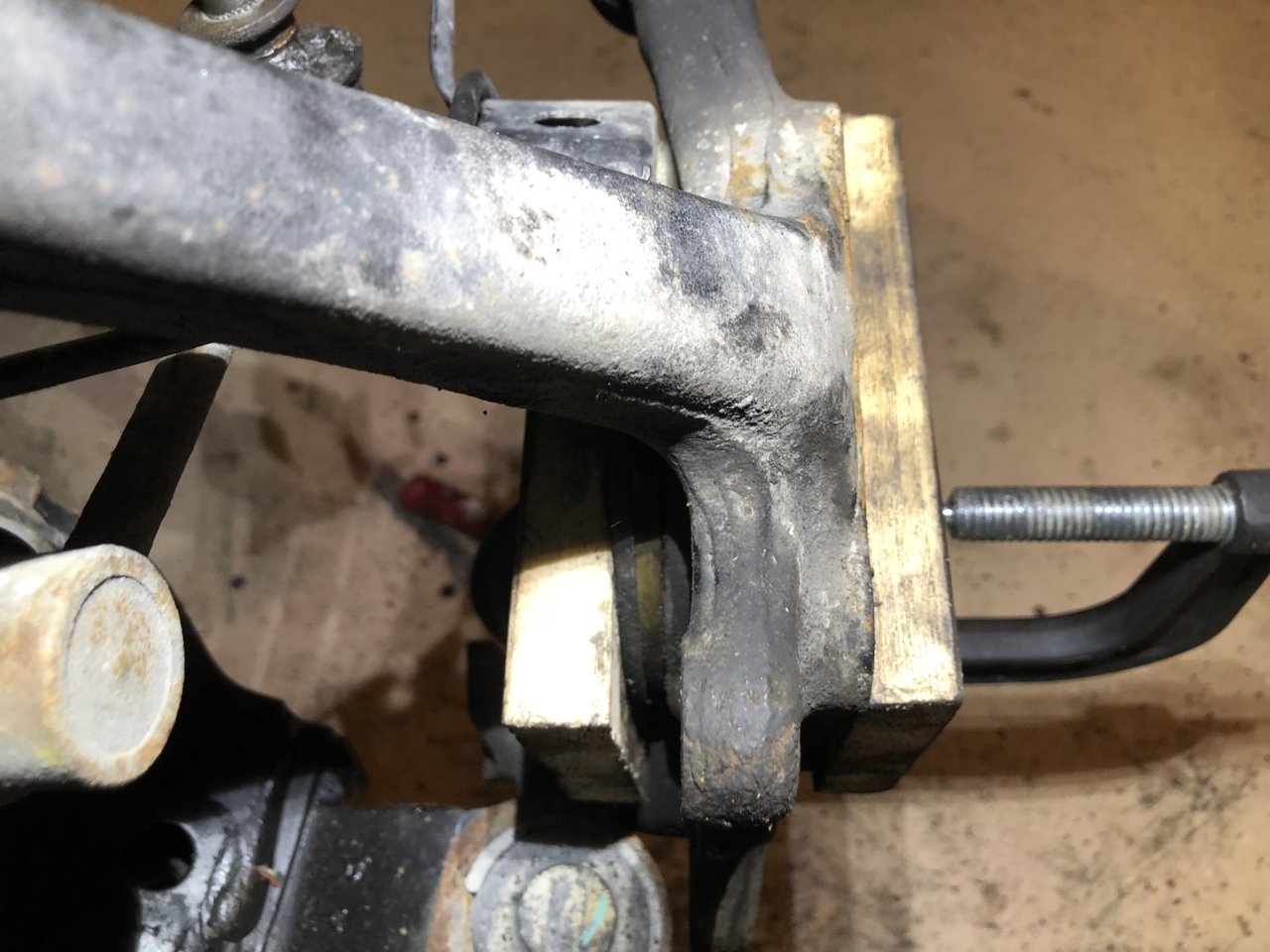

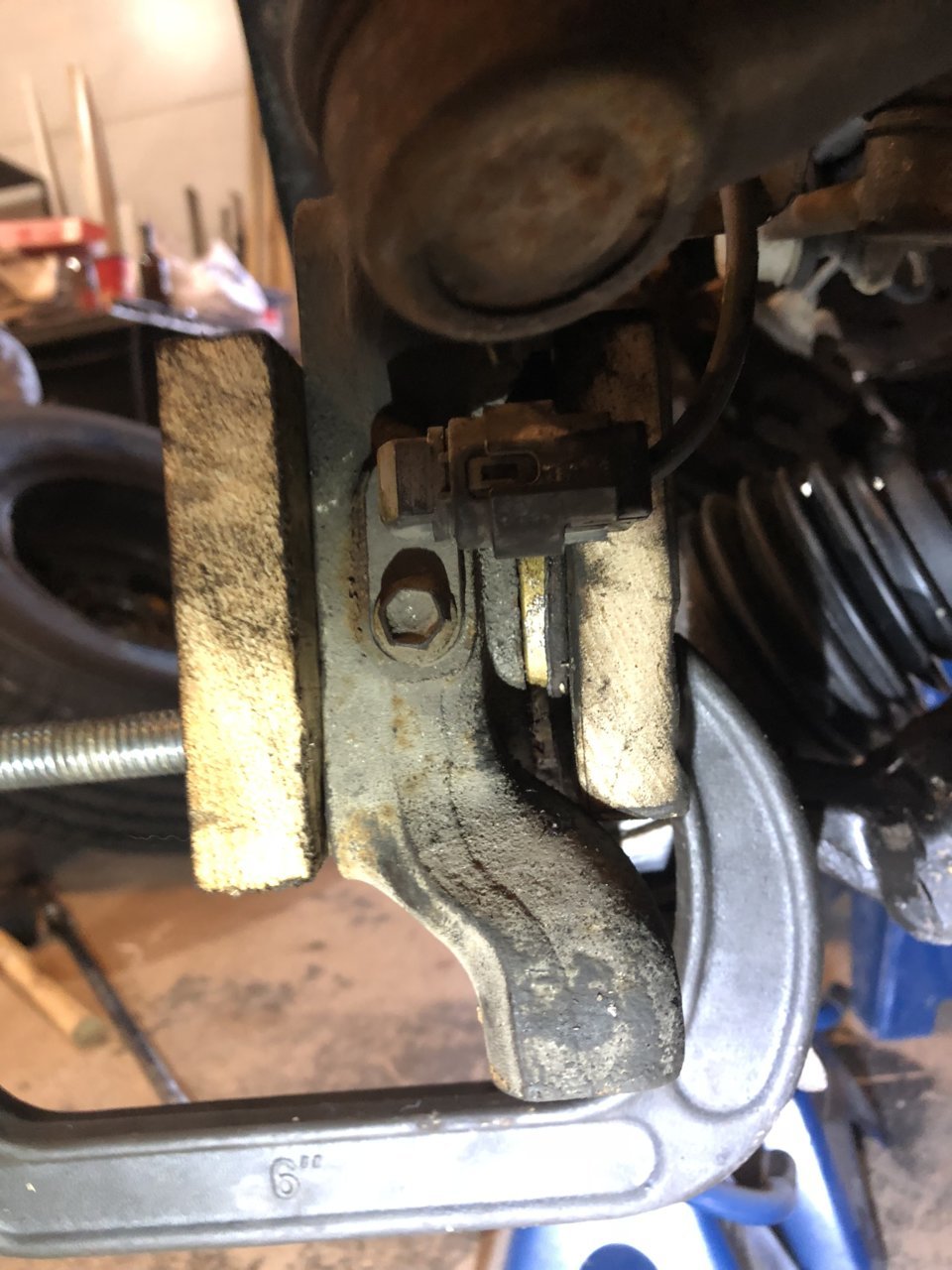

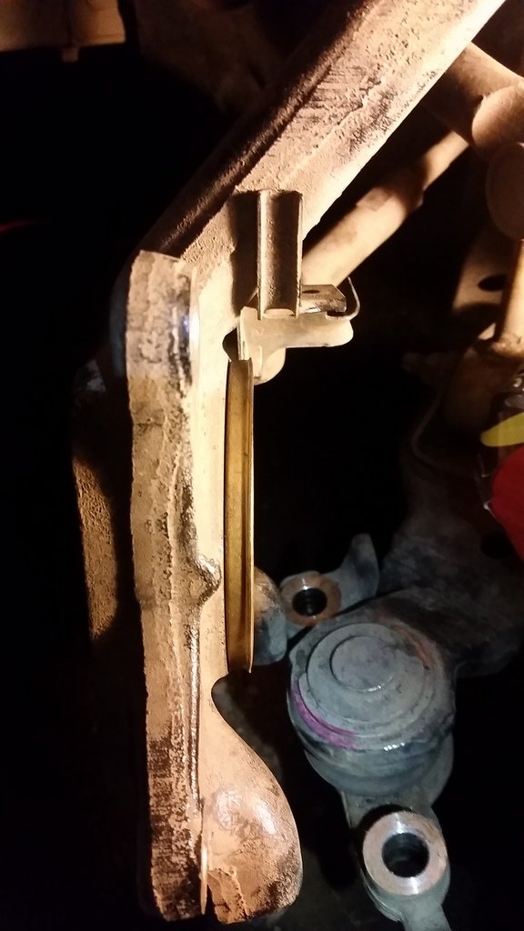

    Great tip OP! I used it today, but I tweaked it a bit for the inner hub seal. I combined your trick with what I did last time. Used a 6” clamp and 2 scrap pieces of wood to squeeze mine in. I always fight with it when hammering around the horn and side to side. The clamp method keeps it from popping out where you aren’t hammering. Hope this helps someone else. Thanks again OP!

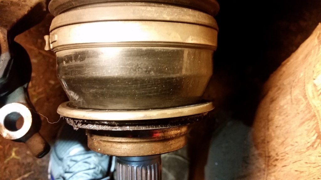

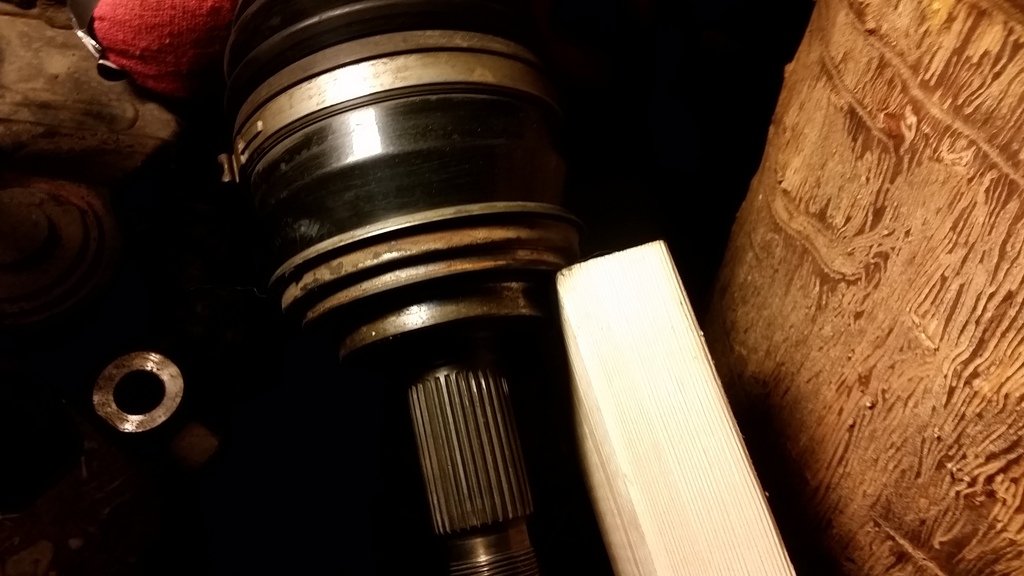

    Any idea why the outter CV seals came COVERED in some black grease? Is it just to stop rusting while it's in the packing?

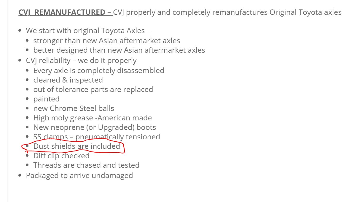

    Are you trying to replace the entire CV axle and go through Toyota for OEM parts, and you're also replacing all seals while you're at it?

    Yes. I’m getting the replacement CV Axles from CVJ though

    I ended up replacing all seals.
