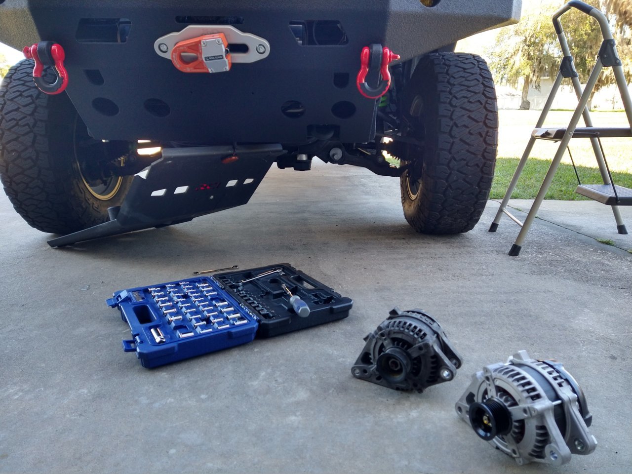

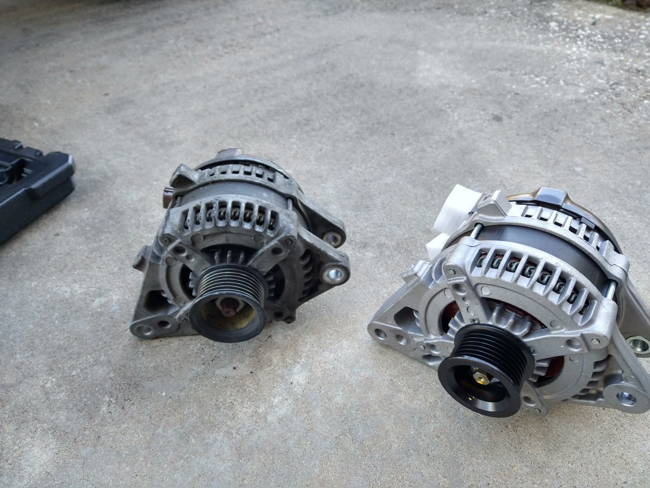

    Did this today after 130K miles.
    The only things I did different was removal and install from the wheel-well......and I smashed the back of my hand pretty good. Ha! Great video.
