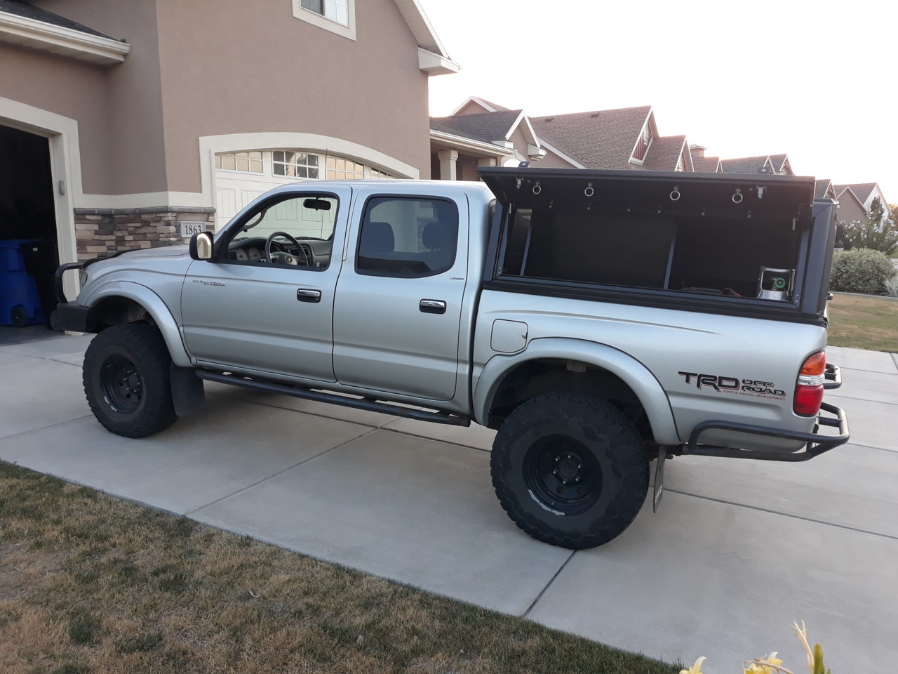

    I have an Alu cab shell on my 1st gen dbl cab. I've had it on there about 5 years now. It was meant for the 2nd gen Tacoma dbl cab. I ordered it when there was only 2 dealers in the country and asked online for lots of measurements before ordering to make sure it would work. I was very pleased with the fitment and think it fits better on the 1st gen. Front to back and side to side it is a perfect fit. The back hatch fits over the tailgate like it should and it sits about 1/4" inside the bed rails. The only thing that bothers me is the height is about an 1"-1.5" below the roof line. To help some I added a 1/2" rubber on the bed rails to help it sit up a little higher. I had to get creative with the mounts but I'm very happy with it and have only seen a few 1st gens with this shell. I can share some pictures tomorrow if you'd like.

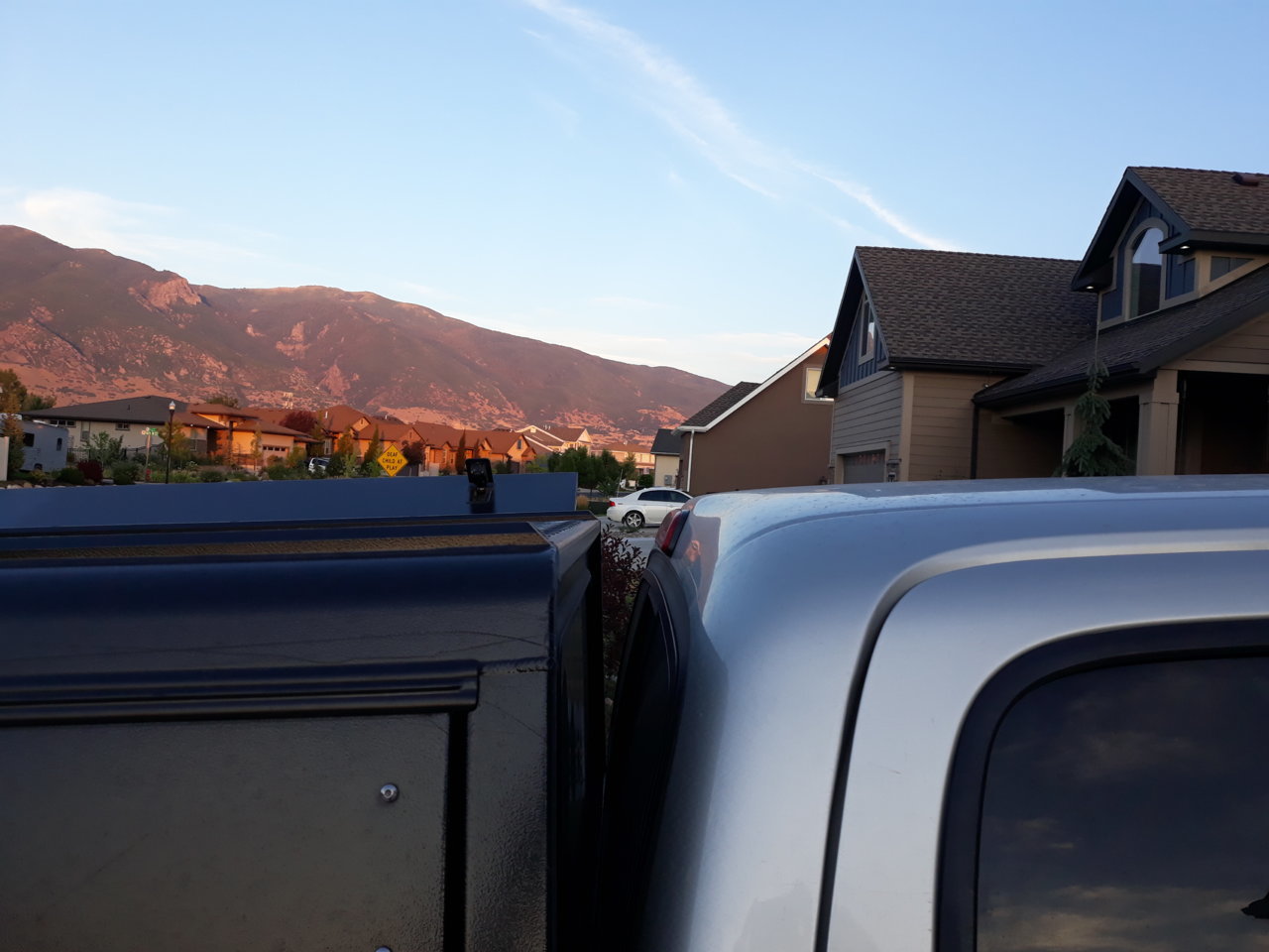

    20220803_202920 (1).jpg 20220803_202835.jpg 20220803_202714.jpg 20220803_202744.jpg 20220803_202733.jpg 20220803_202518.jpg 20220803_202604.jpg 20220803_202632.jpg 20220803_202504 (1).jpg
    Probably more pics than you need but hope this helps. Sorry about the bad pics but was running out of light.

    Looks great, thanks for posting those!

    Thanks for the pix, @UtahTacoma02. Most helpful. I've often wondered about the cross-fitting of Alu-Cab canopies. (I modded my Gen 1-original Mountain Top aluminum tonneau so it would also fit on my Gen 2 Tacoma, where it's running now.
    Did you have any discussions about sizing with Alu-Cab before ordering? The reason I ask is that they've made a TON of different canopies over the years and even today have some that are taller than the Gen 2/Gen 3 Tacoma shell. Here for example is their Land Cruiser 79 pickup shell. This one looks to be a LOT taller.

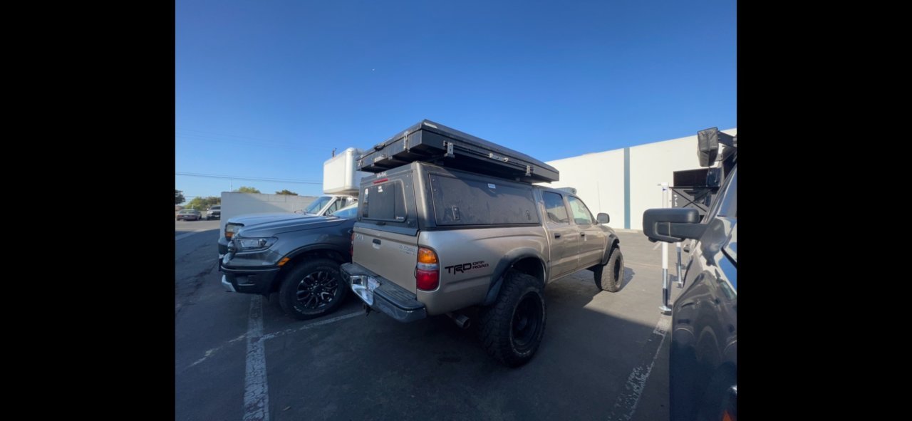

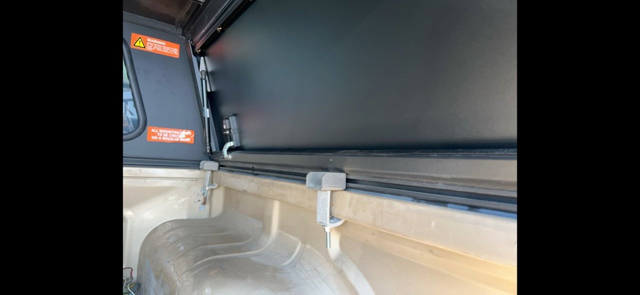

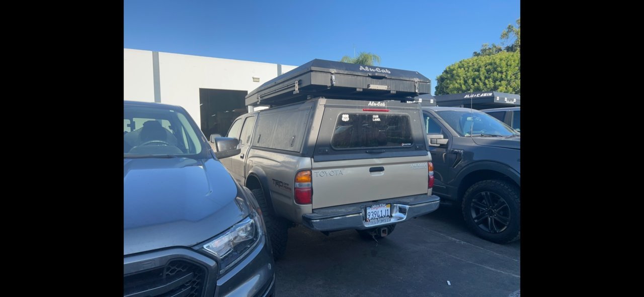

    @Beater_Bimmer Did you end up getting an AluCab? By those photos it looks like a different Tacoma. Would be curious if you know how they adapted those clamps to fit under the rail. Also wonder if they ran a spacer like @UtahTacoma02 did to get a little extra height.

    I haven’t got around to selling my GFC but still plan on this. The local vendor said it fits as pictured with no issues. Comes with the appropriate bed rail clamps for 1st gen too.

    Cool, looking forward to seeing photos of how it looks! Do you know who makes those bed rail clamps? Doing my homework for if/when I ever go this route. Thanks!

    #212184
    172
    San Francisco, CA
    2002 Tacoma 4x4 DCSB
    AFAIK they come with the purchase from AluCab

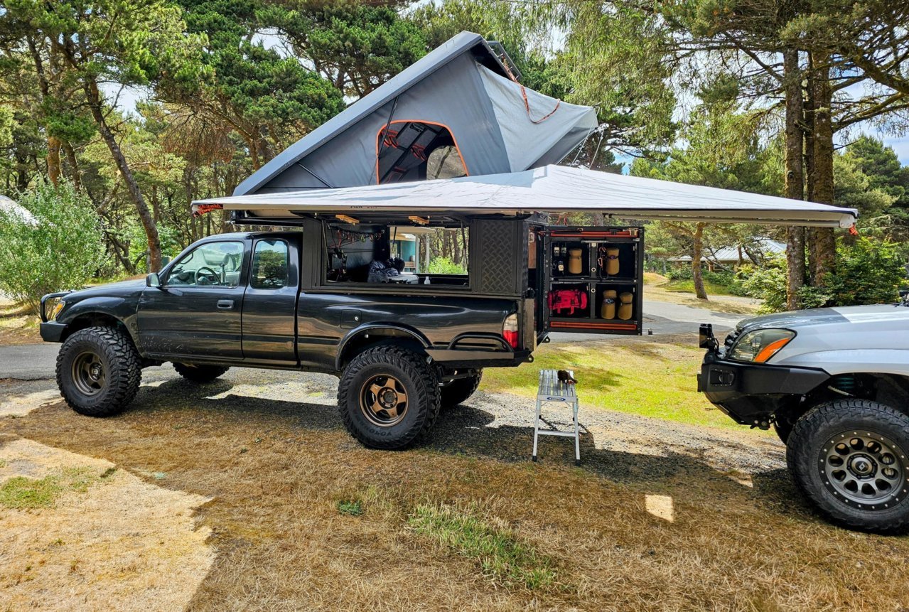

    There's a dude on expedition portal with an alu cab camper on a first gen

    Yup I saw that one. From what I read it sounded like a bit of work but looks like he did a really nice job making it fit. I'm looking at the basic Alu Cab canopy without the wedge camper. Found drawings with measurements buried in their site for the Explorer for the 2nd gen Tacos and the Contour which is like the Explorer but with windows and only offered for the 3rd gens.

    I'm still wondering who made those clamps in the first post lol. Would prefer not to drill any more holes than I already have in the bed if I end up getting the Explorer.
