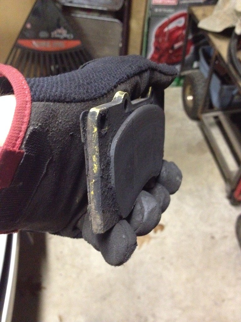

    Really pleased with the braking performance on the EBC yellow stuff but they really do get chewed up fast. This is about 27,000 miles...
    Glad I checked these out when I was doing the last tire rotation!

    They ran out quick!

    I thought the same thing but looking back at my travel log over 3,000 miles were with the trailer on the back. It has brakes that help but it's still 2,500lbs of additional mass to slow down plus camping gear. Bottom line, it's a tradeoff for the performance - they don't last long and they dust up my wheels bad within a few days of a wash (at least the dark gray wheels hide it well).

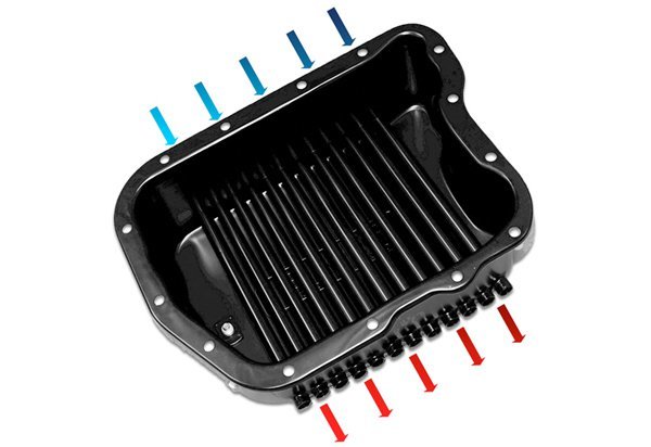

    I still need a good day to do the t-case fluid, belt and hoses and maybe a coolant flush but I was able to squeeze in an oil change, air filter and spark plugs last week after work. Ideally I'd like to re-evaluate my transmission cooler setup as there were a few instances last year that fluid temps still reached 210 plus in the appalachian backroads. The temp always dropped down 30 to 40 degrees within minutes but I know those spikes are hard on the fluid and the internals. I'd like to investigate adding a thermostatic fan to my existing cooler or maybe enlarging a factory pan and perhaps porting it like one of these to increase cooling area and fluid capacity.
