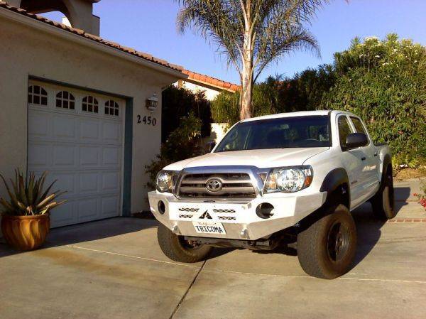

  11. Aug 10, 2010 at 8:51 PM
    TRICOMA
    TRICOMA Tacoma with the TRI package
    Jan 20, 2009
    #12770
    4,886
    Tri
    Carlsbad, CA
    2010 Tacoma DC SB 4x4 TRD Off Road
    King Off-Road Shock Coilover 2.5 with Resi in the front. King Off-Road Shocks 2.5 with Resi's for the rears, Rear Spring TSB, KMC XD Enduros 16x8, Black Vinyl Fenders, Bed compartment locks, Cobra 19 DX IV with Lil Wil mag mount antenna, CoverKing Seat covers front and rear, Built Right UCAs, Aluminess Expedition Bumper, GY Wrangler MT/R with Kevlar 265/75-16, Custom hybrid style rock sliders.
  12. Aug 10, 2010 at 9:08 PM
    Yoytoda
    Yoytoda The Little Truck That Could
    Oct 2, 2009
    #23690
    4,947
    Roland
    Big Bear,CA / Upstate NY(Saratoga)
    2010 Tacoma Regular Cab 4x4
    completely stock
    amazing Tri. I like!!! Perfect for keeping my 4 banger light without sacrificing strength

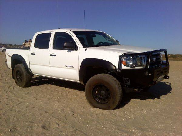

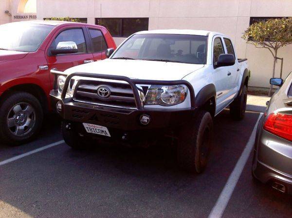

  13. Aug 10, 2010 at 9:11 PM
    TRICOMA
    Jan 20, 2009
    #12770
    4,886
    Tri
    Carlsbad, CA
    60 lbs I believe...it didn't do anything to my front suspension...It is still in the testing phase. But only to make it stronger.
  14. Aug 10, 2010 at 9:35 PM
    TRICOMA
    Jan 20, 2009
    #12770
    4,886
    Tri
    Carlsbad, CA
    The bars are brushguards...if you look at Shrockworks and ARB they are the same. You can get it without if Expedition style is not for you. They are strong but not like steel strong. But you weights about 1/3 of a steel one.
    ARB 175lbs
    Aluminess 60lbs
    Some pictures of the Shrockworks
  15. Aug 10, 2010 at 10:23 PM
    Yoytoda
    Oct 2, 2009
    #23690
    4,947
    Roland
    completely stock
    thats normal. It gives the bars a chance to give a bit instead of hugging the body and when you hit something have it go into the truck.
    Its not a bad thing and pictures dont give it justice. I wish i had a bumper like this Thursday when i went on a run up gold mountain trail here in big bear. Got a little tight lol
