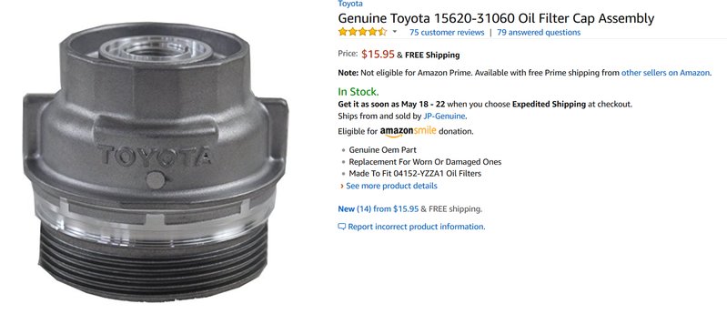

    You can see in the picture of the device on Amazon that there are no locking tabs. The stock unit has one big tab on each side and 2 extra tabs on one side for the lock to sit between. This metal unit just has one tab on each side.
    From what I read here, the wrong tube is longer than the stock tube, so unless they hit it with a hammer to crush the tube, the correct tube is in there.
    The service writer said this unit was better than the stock unit because it's metal and won't strip when taking it off.

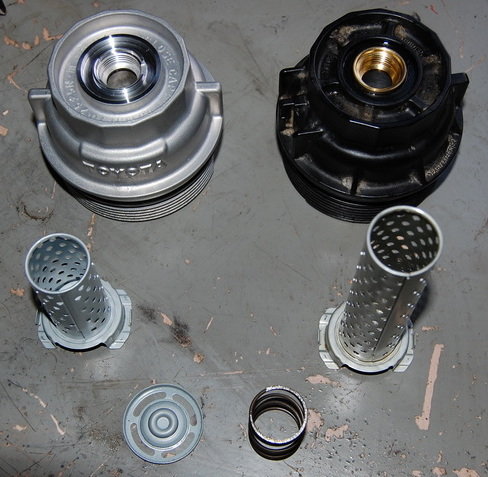

  13. Jul 13, 2017 at 1:38 PM
    #73
    Z50king
    Z50king DCLBOR4X4FTW
    Jun 9, 2015
    #157056
    8,402
    Eric
    Southern California
    2016 DCLB Off Road 4x4 Super White
    Stock and loving it
    Compare these two pictures. The tube that came from GP's truck has 4 sets of holes going along the seam. The 'other' tube has 7 sets of holes along its seam. There is no way the tube I had in the box with the metal unit was 7 sets of holes long. I opened it and it wasn't sticking that far out of the unit. And unless they took a hammer to the unit and banged it on to crush the tube, I have the correct tube installed.
    I don't care much about the locking tabs. There is a rubber gasket and metal on metal contact.
    GPsevinSixx likes this.
