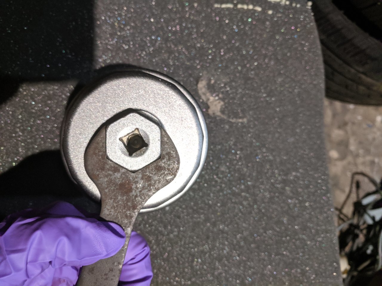

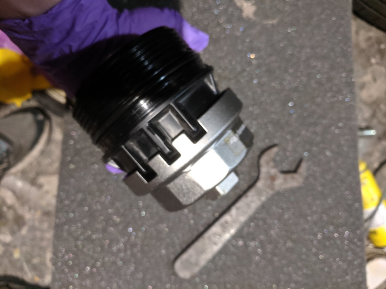

    Use 27mm to remove the filter housing
