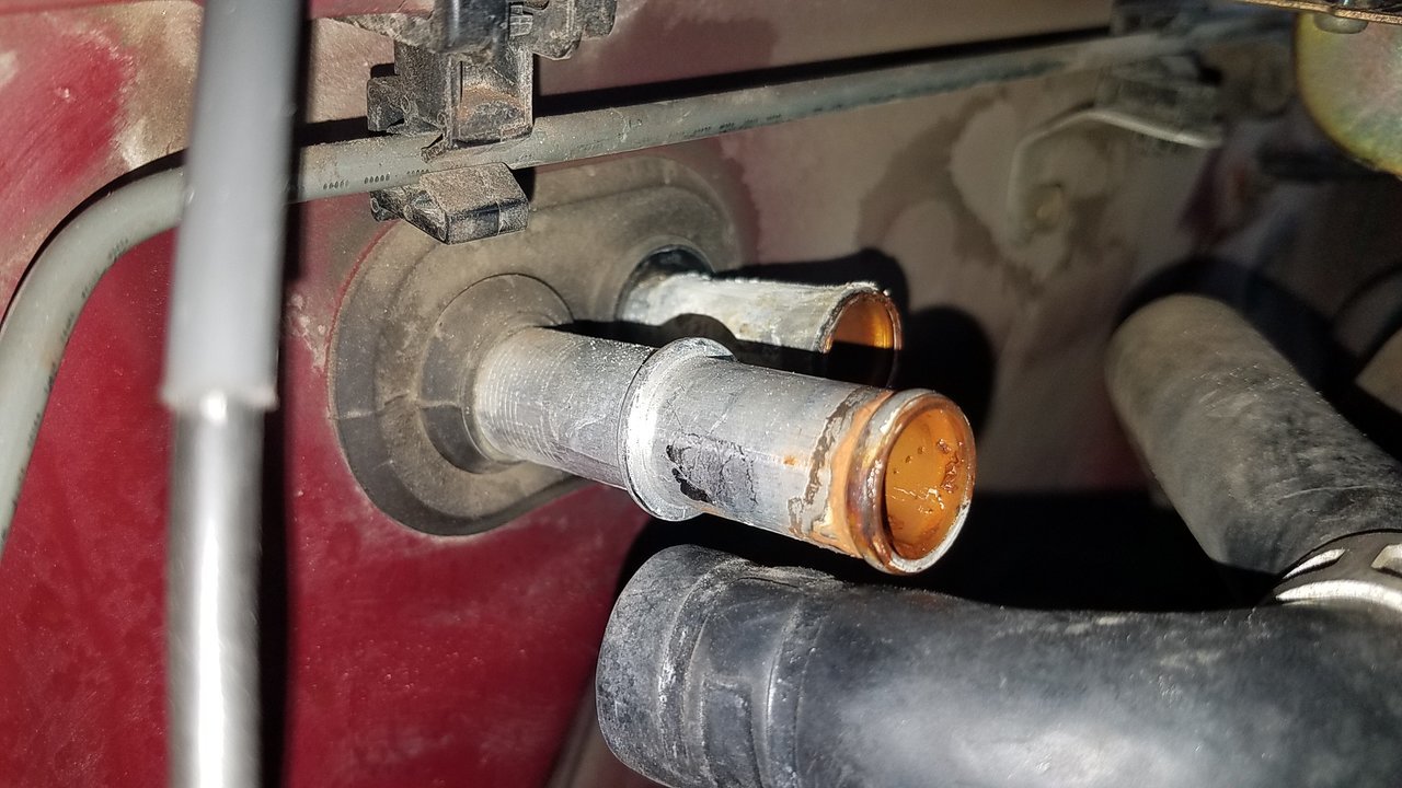

    careful, you might end up bending the inlet/outlet of the heater core.
    El Taco Diablo[OP] likes this.

    You are correct to point that out. I can see how someone might do that. The hoses were on there SOLID... Fortunately for me, I was patient and carefull and did not have a problem getting the hoses off.
    You just have to take time with it.

    Since I was replacing them I just cut them off,

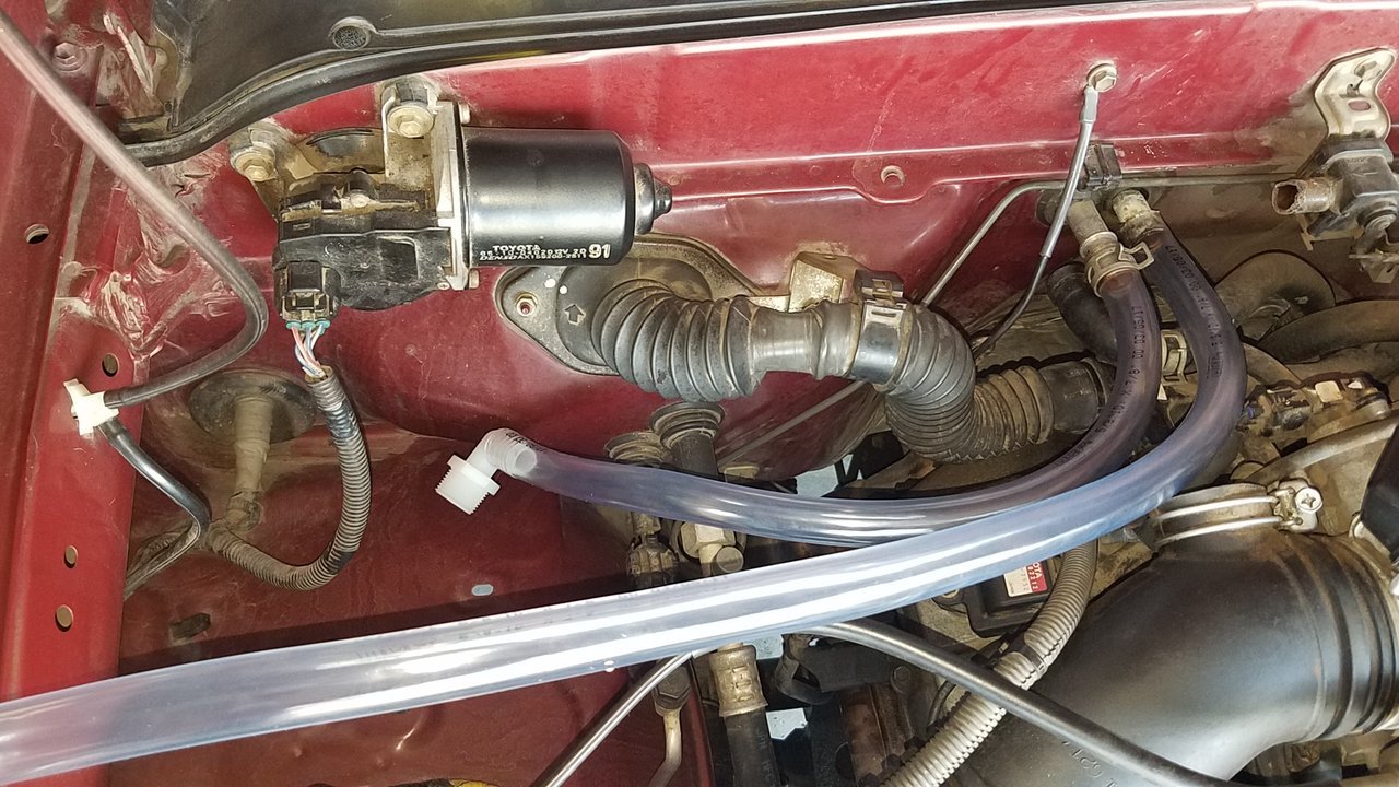

    So here's how I'm running hoses for the heater core flush. It is 5/8id hose and some 5/8 fittings.
    I'm going to flush reverse of the normal flow till I get clean water (that is the way it's run in this picture.) Then I am going to flush with the normal flow till I get clean water again.
    Following the advise in the video NOT to run too much pressure.

    I'm curious why your flushing the heater core separately, then the whole system.

    Here is a better picture of the inlet and outlet on the heater core. As you can see, they are thin aluminum. @tony2018 made a very good point to be careful with these.

    Because I want to make absolutely sure it's clean. It's the biggest pain in the ass, in the entire system, to replace (in my opinion). And... if you flush with the whole system and there is garbage in the heater core... you will only be flushing it further in to the heater core. If you flush reverse of the normal flow, the garbage (theoretically) will flush back out easier, and better.

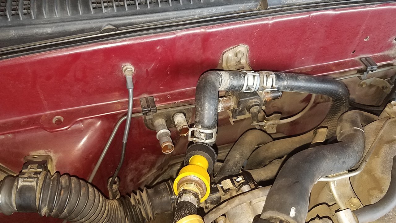

    Ok... so now that the heater core is clean, I bi-passed the heater core and switch and re-flushed again. I didn't want to force the old garbage right back in to the heater core. Then I ran the truck up to operating temp full of distilled water and flushed 2 more times.
    I think we're good. I did all this, as a preventative measure, so I don't just pump old dirty coolant in to a brand new radiator and water pump.

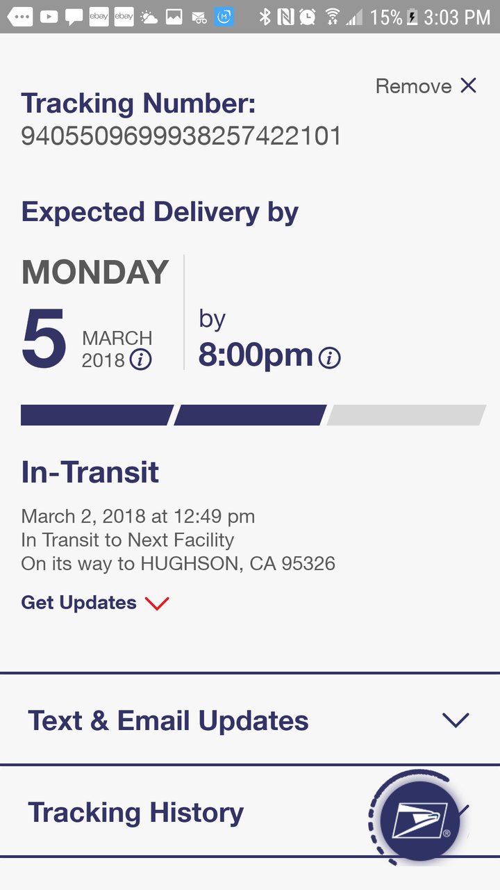

    Checked tracking on my items from Aircabinman. It's still saying the estimated delivery is Monday... but the package is on it's way to my local Post Office right now.
    My mom went down there to see if they can make sure to get it here tomorrow. They know her by name down there. It's a small local office and my mom is always sending packages to her "Soldiers" (two of my sons) in Iraq and Korea.
