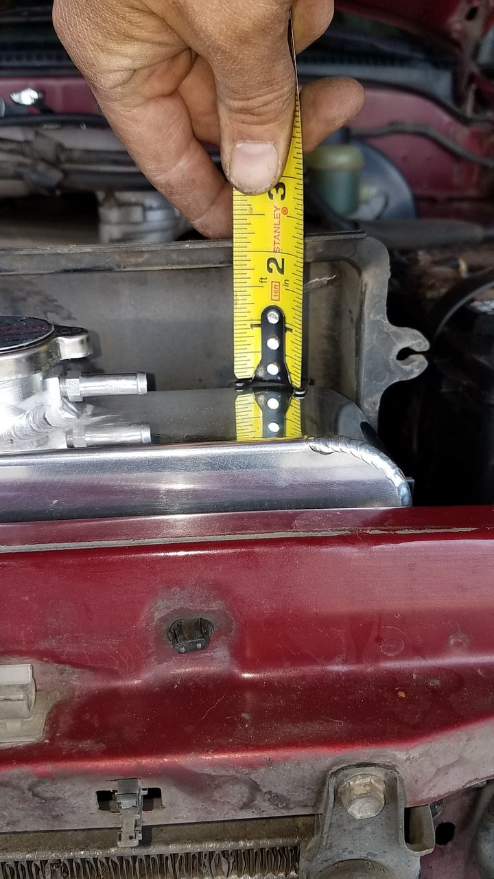

    It's 18.something.

    Yeah, we talked about them in another thread. This one, 18 7/8 is the one Toyota specifies for the 5-lug. The middle height one is for Prerunners and 4x4s with a manual transmission. The tallest one is for Prerunners and 4x4s with the auto.

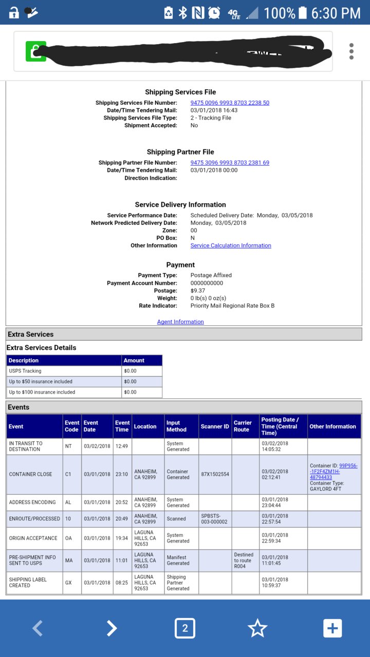

    20180302_183951.jpg @Uphillshunter Took a look at the tracking for you. Network prediction is expecting Monday the 5th.

    Ya... that's what it's saying. But the Post Office here said if it get's to this Local Office by noon, they'll make sure I get it tomorrow.

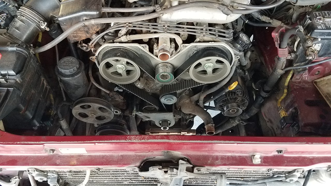

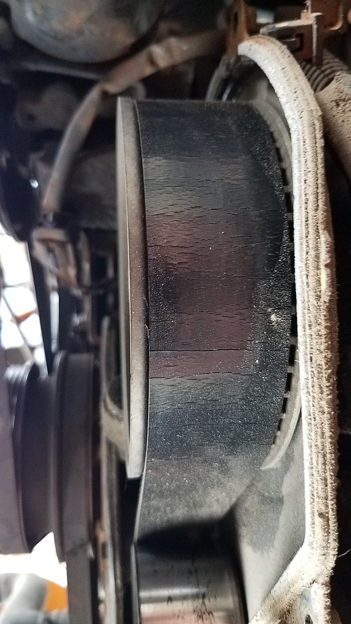

    Here's some progress pics... Ya, I think it was time for a new timing belt.

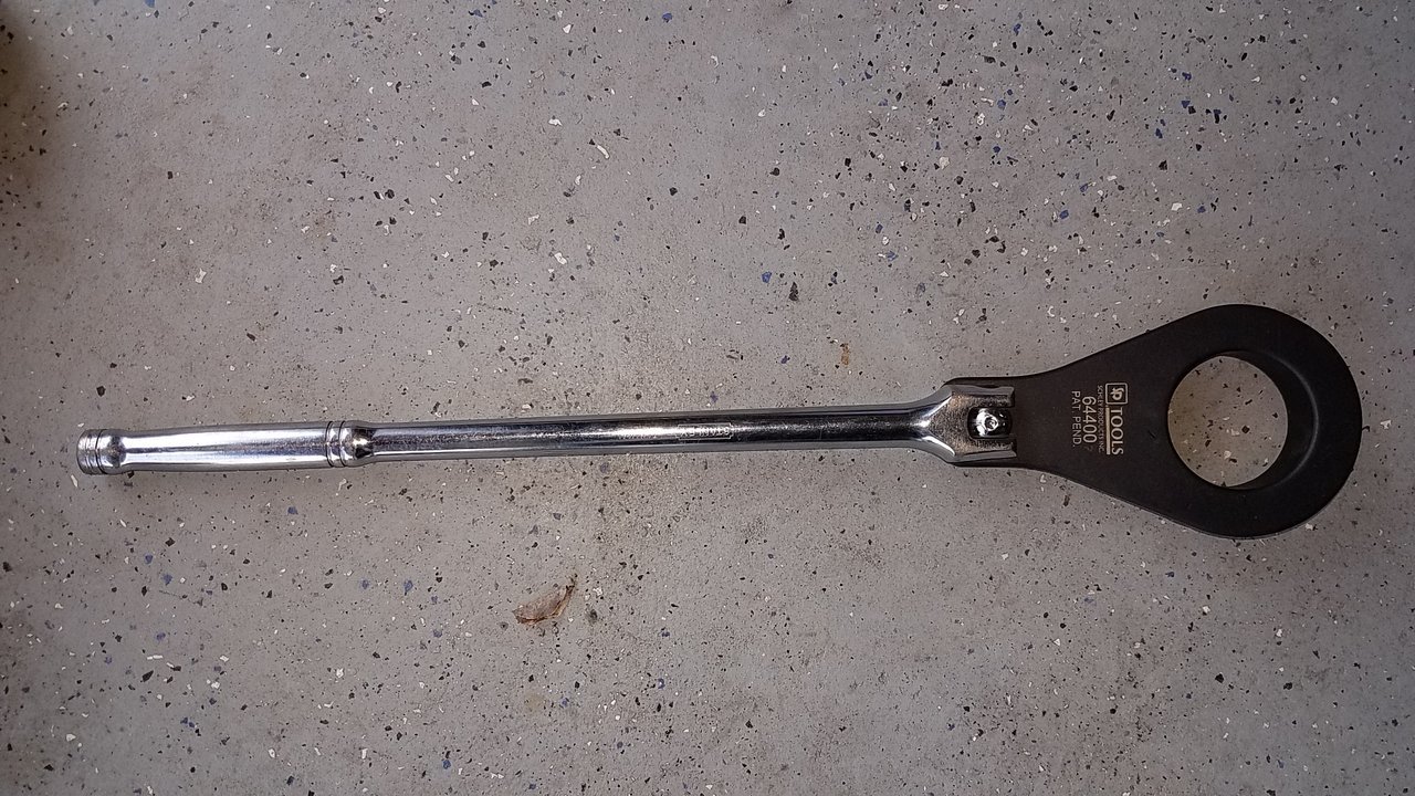

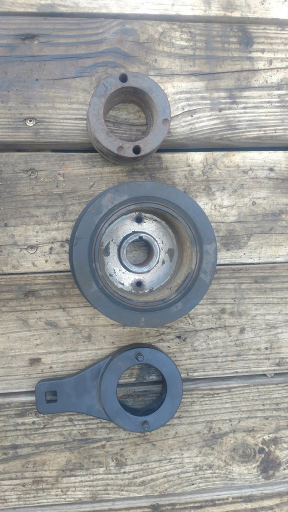

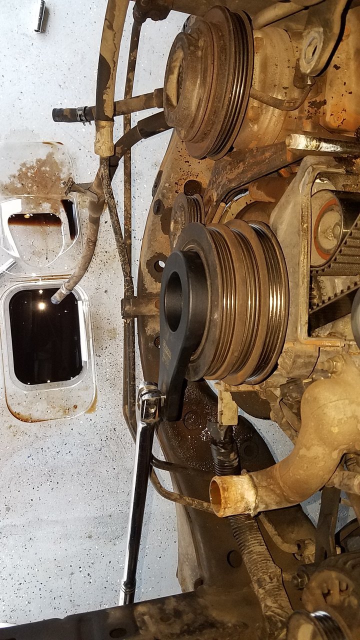

    I highly suggest spending the $65 on this tool. You only need it for about 5 minutes but it's worth it. (For removal of harmonic balancer).
    TrentonTDG likes this.

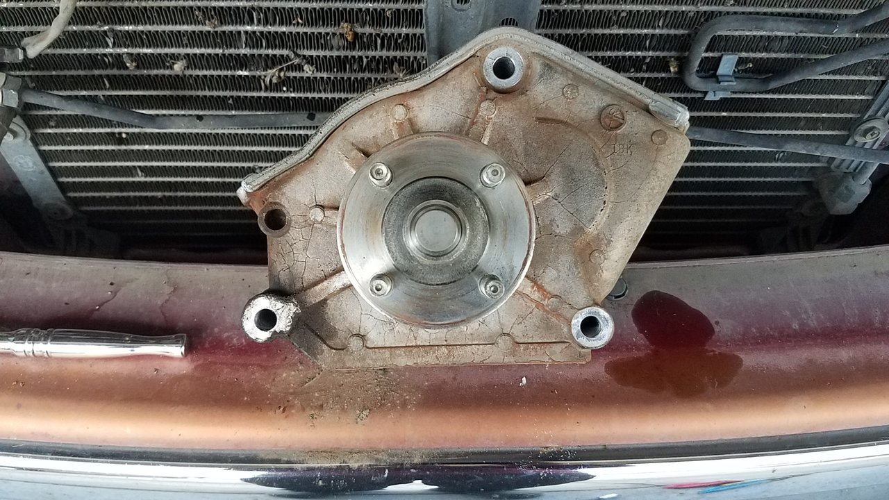

    I did buy a new Fan Support Bracket... but it turns out this one appears to still be good. No play in the bearing, it turns free and smooth. BUT, it has 265,000 miles on it, so the $100 I spent on a new one is just cheap insurance.

    Random progress picture.

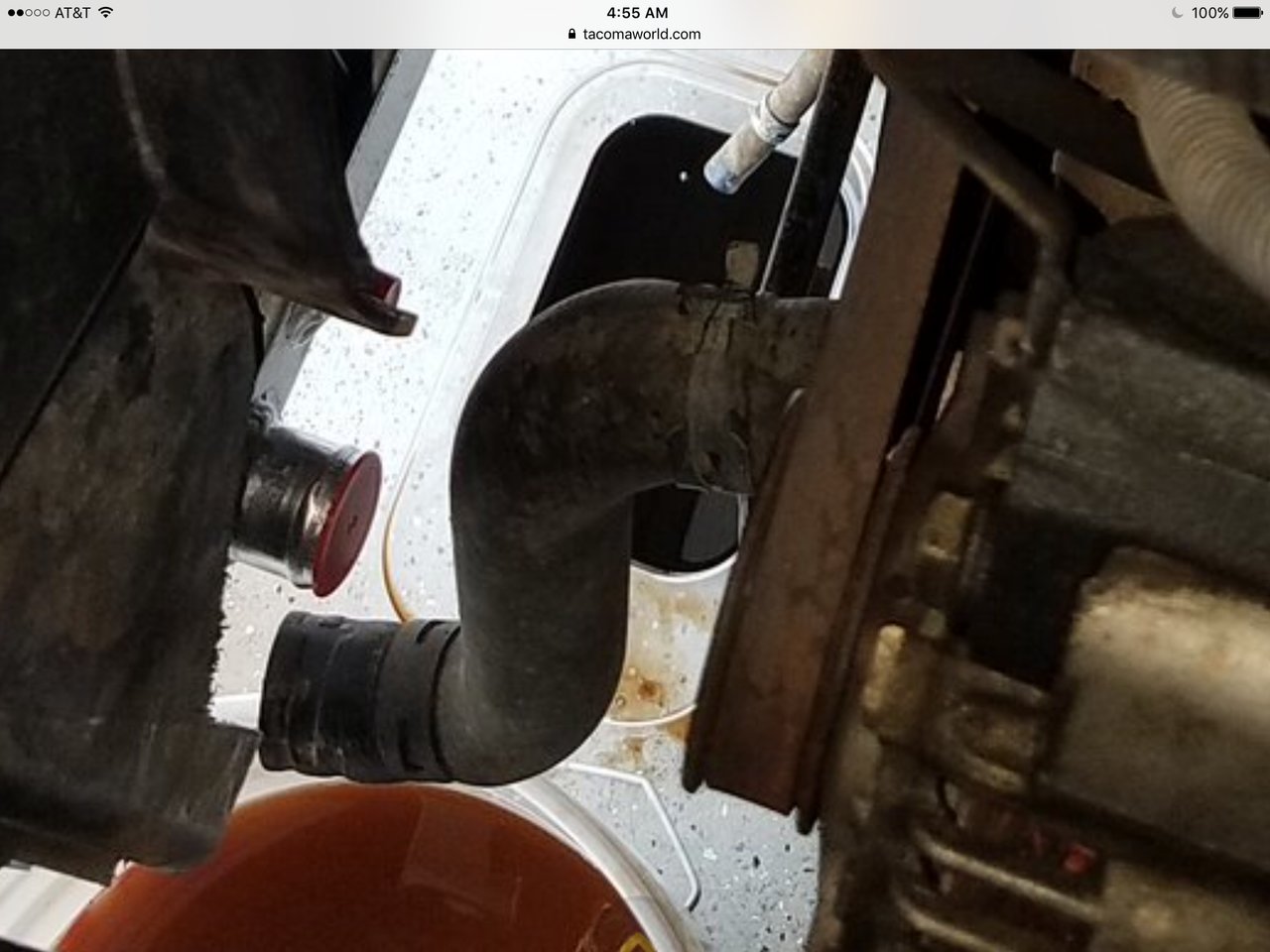

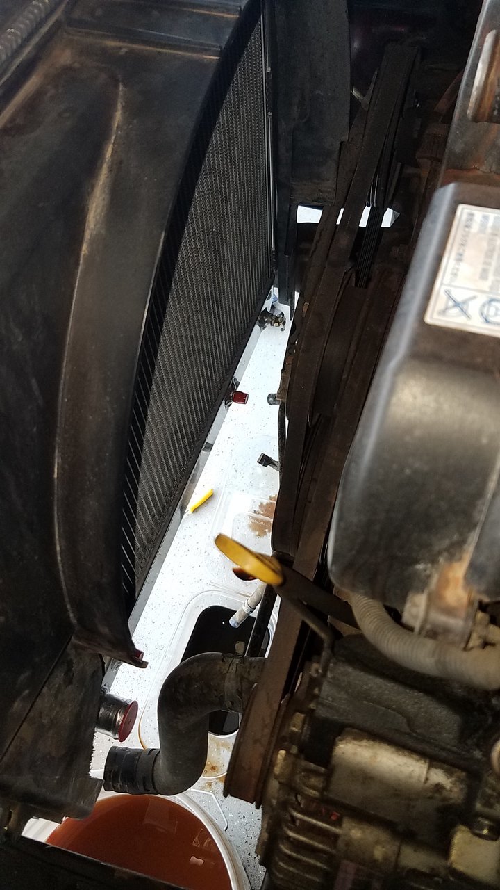

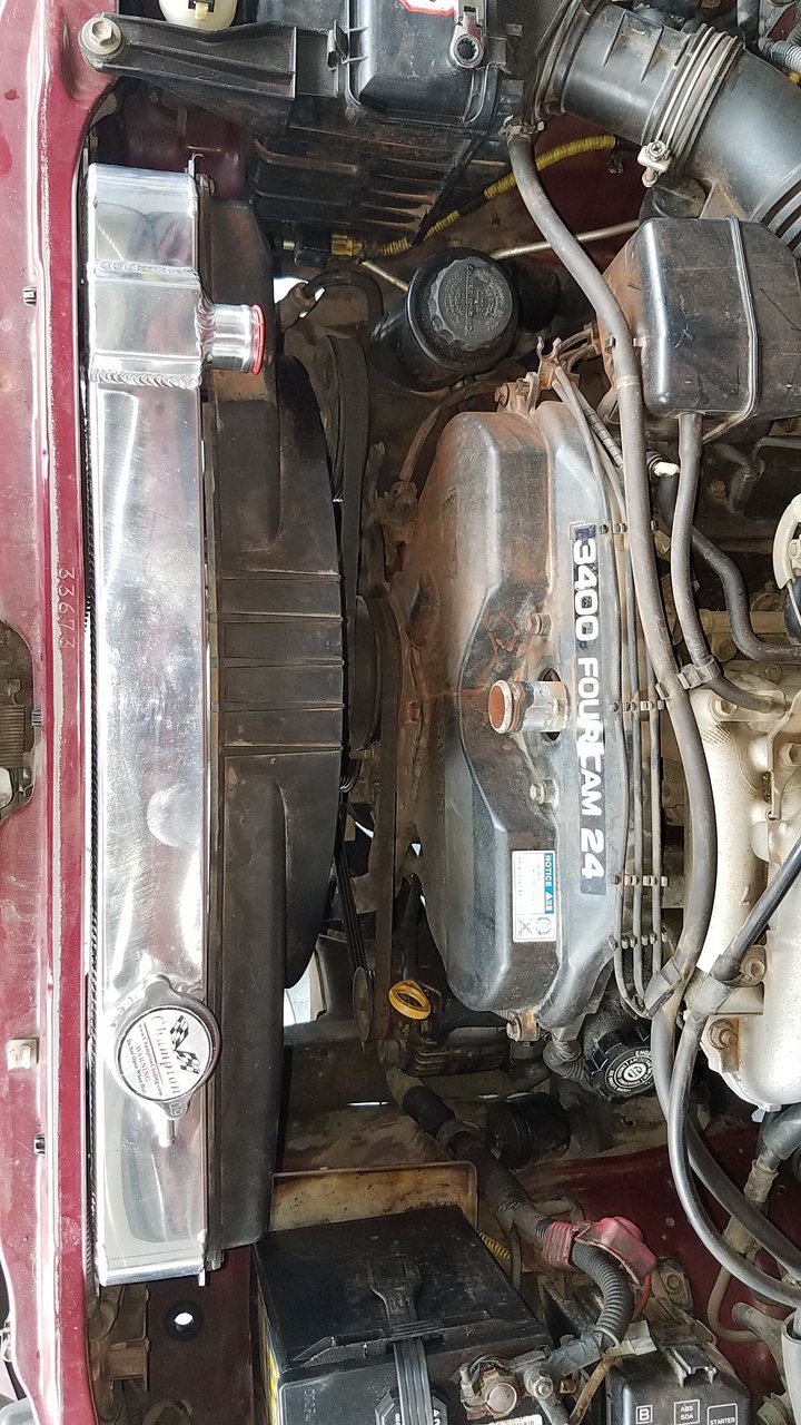

    Is that lower radiator hose going to fit now that the new radiator is 2" or more shorter for you??

    Sorry I didn't answer sooner. Good catch. The lower radiator hose has no chance of working. I mocked it back up and the stock hose doesn't come close. I'll know more when I get the rest put back together.

    I used the tool once... It tore the rubber and separated the pulley. I have used a socket right on the bolt and long breaker bar with wedged against the frame. then bump the starter to break the bolt loose. It has worked perfectly ever time. Just make sure the breaker bar is on top of the left frame rails.
    Not saying that tool does not work, just something to keep in mind...

    Look at Gates 22120 lower radiator hose, from a dodge neon i think? Works perfect, you cut one side a few inches off, the curve and I.D. is the same as the lower tacoma hose. Been running one for 2 years now.
