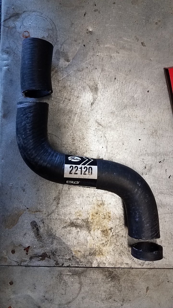

    You've been running that lower hose to a Champion radiator?

    Not to the Champion yet...still need to bolt mine in, but to the toyota 2.7l radiator I swapped to(same core height and dimensions as champion) Champion and toyota radiator have the same size outlets.

    Why not just get the correct Tacoma hose?

    According to a quick rock auto reference, there are at least two lower radiator hoses for a 3.4. one is 13"s and the other is 11". I wonder if the shorter one will work?
    I'm pretty sure Toyota put a 3.4 in the 5 lugs. That combo I assume would get the smaller radiators... And IF so, there has to be a hose for it.
    Edit:. The S-runner hose is my guess...

    Never thought about the s-runner, just lumped that in with all the other 5lug 2.4l minis. The top 2 look like the "drop" portion is too long, but the 11" might be an option.

    Just got back from O'Reillys... I got the Gates 22120... that definately looks like it's gunna do the trick! Thanks! :thumbsup:

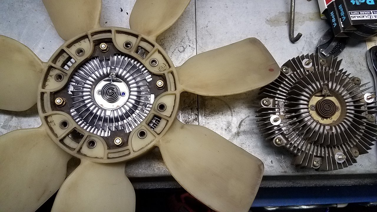

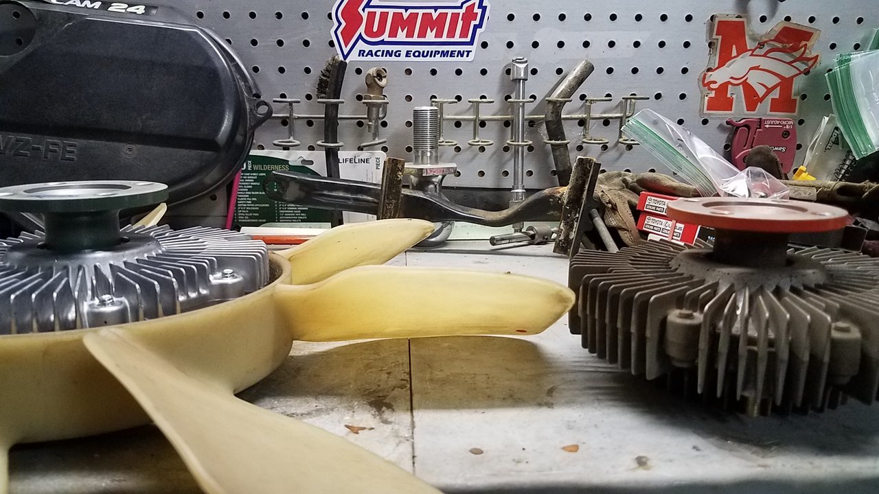

    Figured I'd add a couple updates while have some coffee and wait for (hope for) it to get a little warmer before I get back at it this morning.
    So, when I was getting the parts together, to do this, I went back and forth on whether to order a new fan clutch. I did end up going ahead and getting one (as I posted earlier, Rock Auto was by far the best price).
    Turns out, it was a good thing I did. While I was flushing the coolant system, I was watching what the fan was doing, and according to Timmy's video, my clutch was definately bad.
    https://youtu.be/WzhlACxqeqQ
    The fan was not stopping when the engine stopped at operating temp, and it was easy to move when the truck was off at operating temp.
    I replaced my old one with a Fan clutch "with tow package." I would have assumed that's what would have been on my truck already, but, it appears, that was not the case. My original fan clutch had an orange flange, the "tow package" clutch has a green flange.

    Here is what the Gates 22120 looks like to start. We had already mocked it up. The silver lines are where we were going to cut it.
    We cut it the first time like this.
    It was still a bit too long so we cut it again.
    That was the ticket.... looks like it was made for this application.
