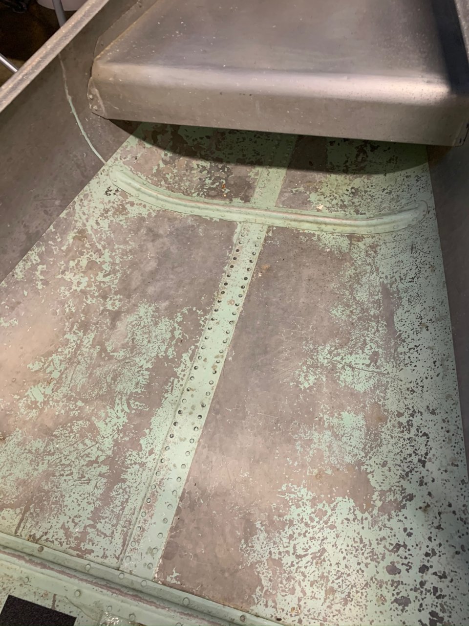

    We used to use powdered comet or Ajax and a stiff brush to clean our aluminum canoe years ago. Is this still the best way or is there something newer/better to use? This scanoe has been hanging in a shed for 10 years at least and needs a good cleaning.
    What’s the best thing to do to the floor to cut down on heat/glare from the sun on the inside? There used to be some type of coating years ago but most of it is now gone.

    I'd take a knotted wire wheel to it to get rid of the existing coating.
    Acid wash it with phosphoric acid.
    Pre treat it with Alodyne. The same stuff they use on aircraft.
    Prime it with whatever primer you like.
    Then use whatever boat top coating color you like mixed with a bit of grit for traction.
    I really like how my Navy blue turned out on the drift boat. The top coat paint is very durable. We wear cleats on our wader boots and it is showing no wear.
