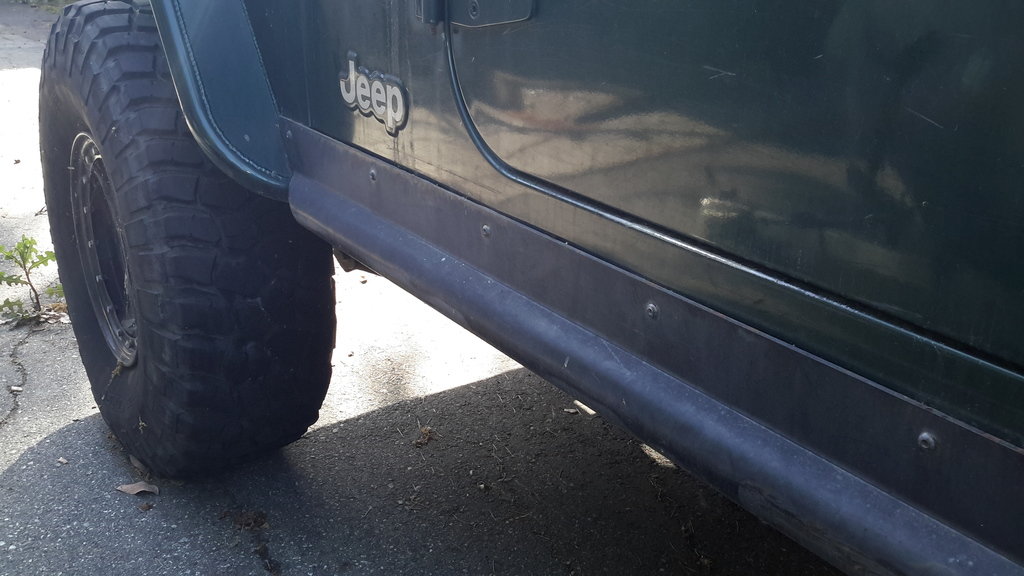

    Here's the ones on my Jeep that I would like to emulate; these are steel but the concept is the same. The corners of a jeep are obviously much easier to match as they are just a 90 degree profile. Matching the Taco would be much harder and might not even be doable without a custom extrusion. All of this is kinda a thought experiment into the feasibility at this point anyways so...
    tmp_10267-20150508_091855649577599_zpsu8_128fc6bf428f31accc4aad0ddeb56995fddcc927.jpg
    These are body mounted, have better ground clearance than any frame mounted slider, and use less material which makes them lighter. They have taken more than their fair share of hits and are still straight and doing there job protecting the body.

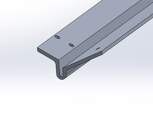

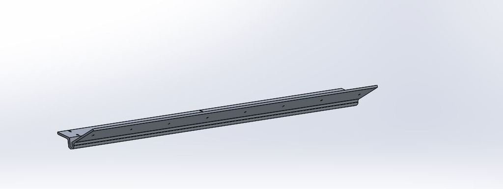

    As long as we're talking CAD
    Here is a VERY rough idea of what I have in mind, don't focus on proportions or the lack of a kickout, that can be added later. Similiarly, increasing bending resistance would need some attention. I drew this just to convey my thoughts and I realize that machining this is pretty much an exercise in futility.
    These would be picking up the factory mounting holes used for the factory steps and would require some kind of nutsert in the 9 holes (on my DCSB) that are currently plugged with rubber feet. As currently drawn, SW thinks these would be about 14 lbs a piece if .250" thick and 21.5 lbs out of .375" thick.
    I agree with Plurpimpin that without at least moderate kickout these would be much less useful due to the body shape. That being said, someones gotta think out side of the box every once in a while.

    Well it would protect the bottom of the rocker but you might still get a doording or two ;)
    ETA: Jeeps don't have that problem cause you can readily take the doors off. WRT producing them, I don't think bending would be a good option as most aluminum doesn't like to bend. I think they would require a custom extrusion.

    I have worked with aluminum before and never had any real luck with bending a plate without causing structural integrity issues at the bend. I have always welded all my aluminum joints but at the same time have never put as much stress on the welds as we are referring to here with plates and sliders.
    I guess I just don't understand the functionality of the sliders as you suggest that the ones in the link above would not be useful? What flaw do these have that the others don't? Aren't sliders made for just that, sliding? It is just used in the event of being high centered against the body/rocker pannels, no?
    What would be the biggest challenge of making these, the radius right? So why not mill a tool and die to forge these? A press can be out sourced and depending on the pounds needed to forge aluminum, (don't know, never tried) I may have access to the equipment itself. With this information would it be feasible if we had enough interest?

    Bending something 80" wide and 1/4" thick is no small feat. I am going to keep playing with this design and keep examining options for making something like this.

    I'm very interested to see how these turn out. I'm still having trouble seeing you getting much protection without having them stick out a substantial distance. Plus aren't Jeep bodies made to have sliders mount to them unlike our pinch weld?
    Either way it's definitely an interesting project. I do agree with your points about bending though and think you're on the right track with milling it.

    What about cutting out the pinch-weld area and replacing it with tube going around it. Would be simpler to build.

    I like your thinking here but we are back to welding which is less than desirable for aluminum. I suppose it could be a bolted assembly....hmmmm.
