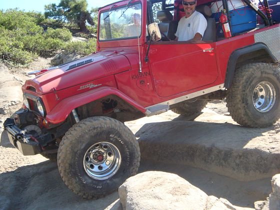

    Not sure about actual sliders for the Tacos, but I have run some 1/4" thick T6 aluminum "sliders" (2 x 3 angle) on my 40 for decades and they have held up quite well. Yes they get scratched up on the bottom, but the 40 is about 5k and the sliders simply reinforce the cut off body panel and no issues.

    Thanks...I've had her for almost 30 years...bought it fairly stock in 87 and built what was then a Bad Ass Rock Rig...now she is simply old school with all the wild stuff folks are building, but still a lot of fun and will do most of the nasty stuff as long as you take your time...the Marlin Toy Box at 140:1 helps make up for the "puny" 35's I'm running.
