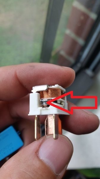

    I can solder... But not sure which relay it is... Can you PM me a pic?

    Wish I took pics when I was tearing stuff apart, but for anyone sitting on the fence, that panel is pretty easy to pull. (At least in my '14.) Yank the coin cubby to the right of the steering wheel. There's a 10mm bolt to remove on that side, and another on the left down low. A few tugs across the whole thing releases the friction clips. Loosen the fuse block (4 bolts, iirc) and ease it forward and down a tiny bit. (No need to unplug any harnesses.) The relay is easy to yank with finger pressure.

    What exactly did you solder?

    What exactly needs to be soldered in the relay?

    It's pretty obvious when you pop the relay open - there's only one circuit to solder closed.
