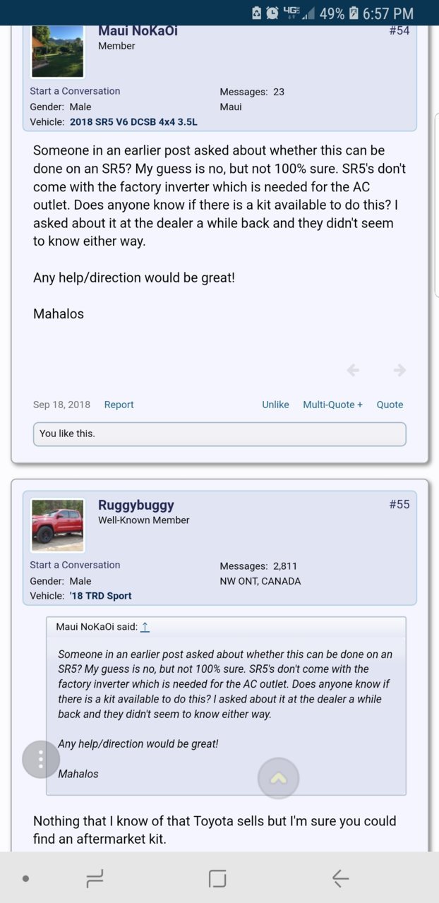

    I read the post you tagged for the 110v Ac and seen this
