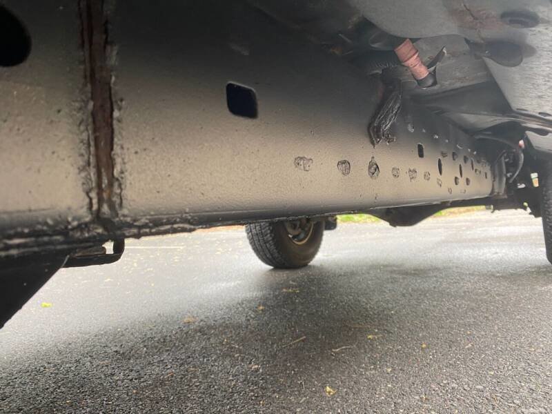

    I typically prefer to work with private sellers, but there seem to be slim pickings of late 2nd-gen MT Tacomas in the tri-state/northeast area where I live.
    I came across this one but I'm hesitating because, well.. it's used car dealer. The best I can do with my limited knowledge is take it to a local Toyota dealer for an inspection.
    Any thoughts / red flags I should be aware of...?
    https://www.paautoworld.com/details/used-2012-toyota-tacoma/75388931
    Many thanks!

    I’d definitely get a good look at the underside and more of the frame, especially the insides of the rails near the cats.

    But eyes on frame everywhere underneath

    From the pictures it kinda looks like someone spray painted the frame over some suspicious looking imperfections? 2012-toyota-tacoma-base-4x4-4dr-access-cab-6-1-ft-sb-5m.jpg

    The Carfax shows the following.. maybe explains the appearance?
    12/16/2020
    • Toyota Motor Sales, USA, Inc.
    • Manufacturer Service Campaign issued
      • Campaign #K0D LIMITED SERVICE CAMPAIGN K0D (REMEDY
      • NOTICE) - CERTAIN 2011 - 2017 MODEL YEAR TACOMA -
      • FRAME CORROSION RESISTANT COMPOUND (CRC)
      • APPLICATION
      • Campaign expiration date: 01/31/2023

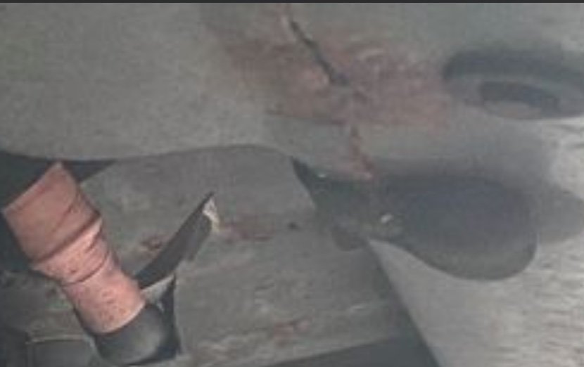

    Also something suspect there in the top right in that undercarriage shot...

    Looks like a spot of rust. But I don't think that's a structural crack if that's what you're worried about. Tough to tell from the photos though.
