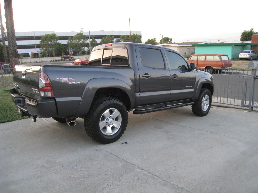

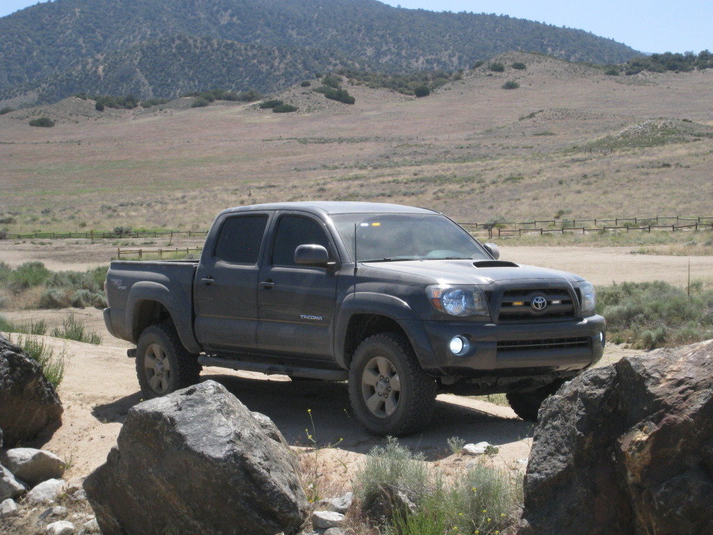

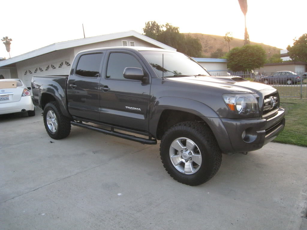

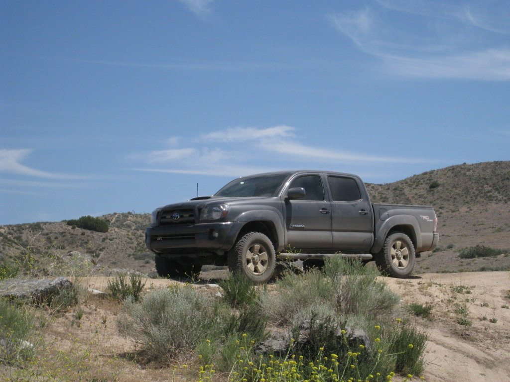

    I have the TSB leaf pack in my 09' which should be the same pack yours came with standard. I added standard length 5100's in rear and front set at 1.75" My truck is level now and rides way better than stock IMO. No vibes or anything and bump are WAY smoother. Since your doing this for weight/towing, I think you should get an aal i back to make it 5 leafs with extended 5100 and set front at 1.75 still. You will still have a rake, but it will be equivalent to what you have now. The front and back will go up in proportion so your not really changing much. Then when you tow, the back will get weighed down and it looks level again (theoretically) :) Ignore the AT tires, but just to give you and idea, this is the oem 4 leaf pack with standard length 5100 and front set at 1.75 with stock UCA. I love the ride and no issues
    Its not too high at all. Take these pics posted and imagine another 1" - 1.5" in back... itll look great. The front will ride wonderful and the back will be super still if you add a leaf, but once its under weight it should be better
