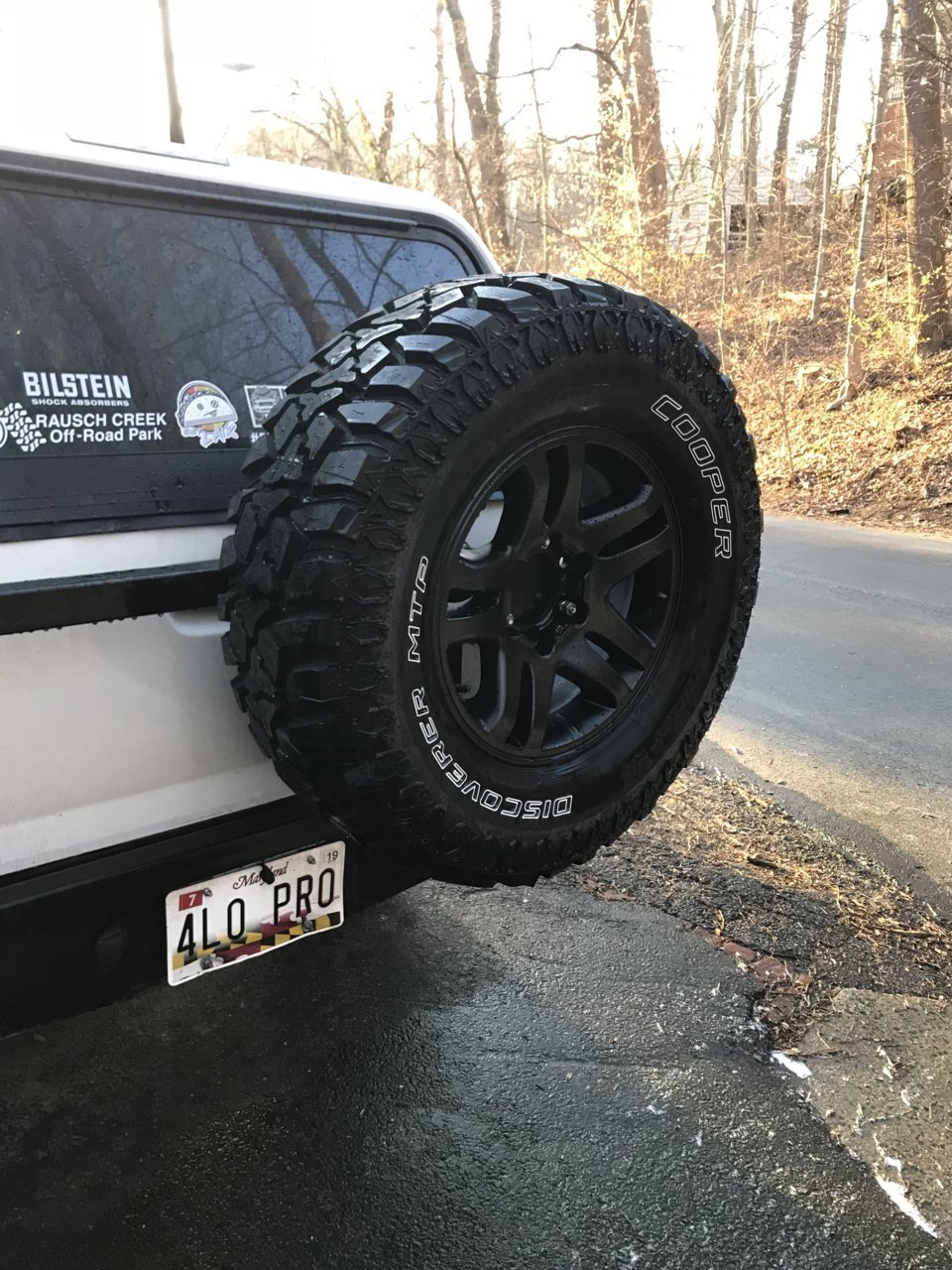

    Those are really nice rims and tires. Very aggressive

    I used warm water with regular car wash soap, and a stiff bristle brush. Came off super easy
