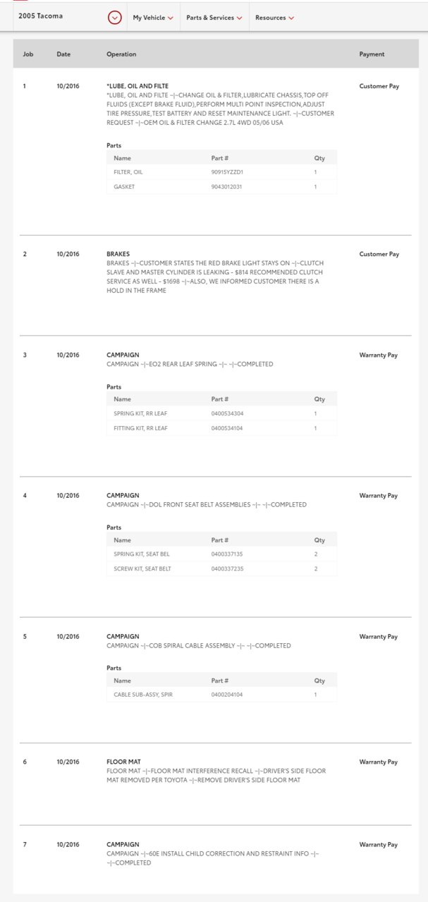

    It was in in 2016. No other toyota service recently.
  13. Aug 2, 2020 at 12:15 PM
    #53
    smithc2768
    smithc2768 [OP] Well-Known Member
    Aug 1, 2020
    #336279
    49
    "ALSO, WE INFORMED CUSTOMER THERE IS A HOLD IN THE FRAME"
    So they had it on their racks within the time period of the extended warranty program and just told the customer without offering to fix it?

  14. Aug 2, 2020 at 12:24 PM

    Wow. I'd go see the guy about getting your money back, or go talk to a lawyer.

    :popcorn:
    It seems like this should fall on whoever owned it when the dealer found the hole.. Or, maybe the dealer that found the hole should have replaced the frame then?
    I hope Toyota takes care of you, @smithc2768
