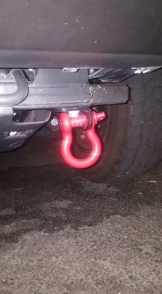

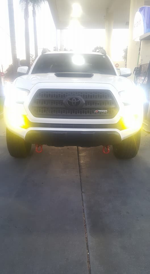

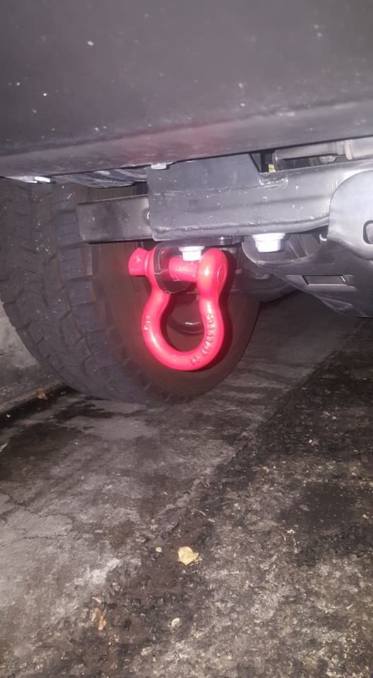

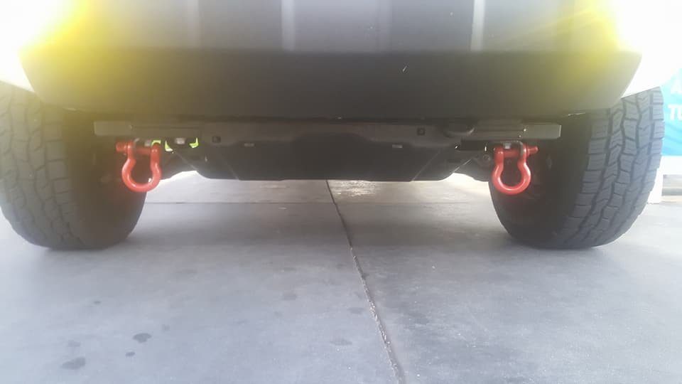

    i don't think I've seen anybody install 2 shackles in the front without modifying their bumbers2.jpg 3.jpg 4.jpg 5.jpg like mine..

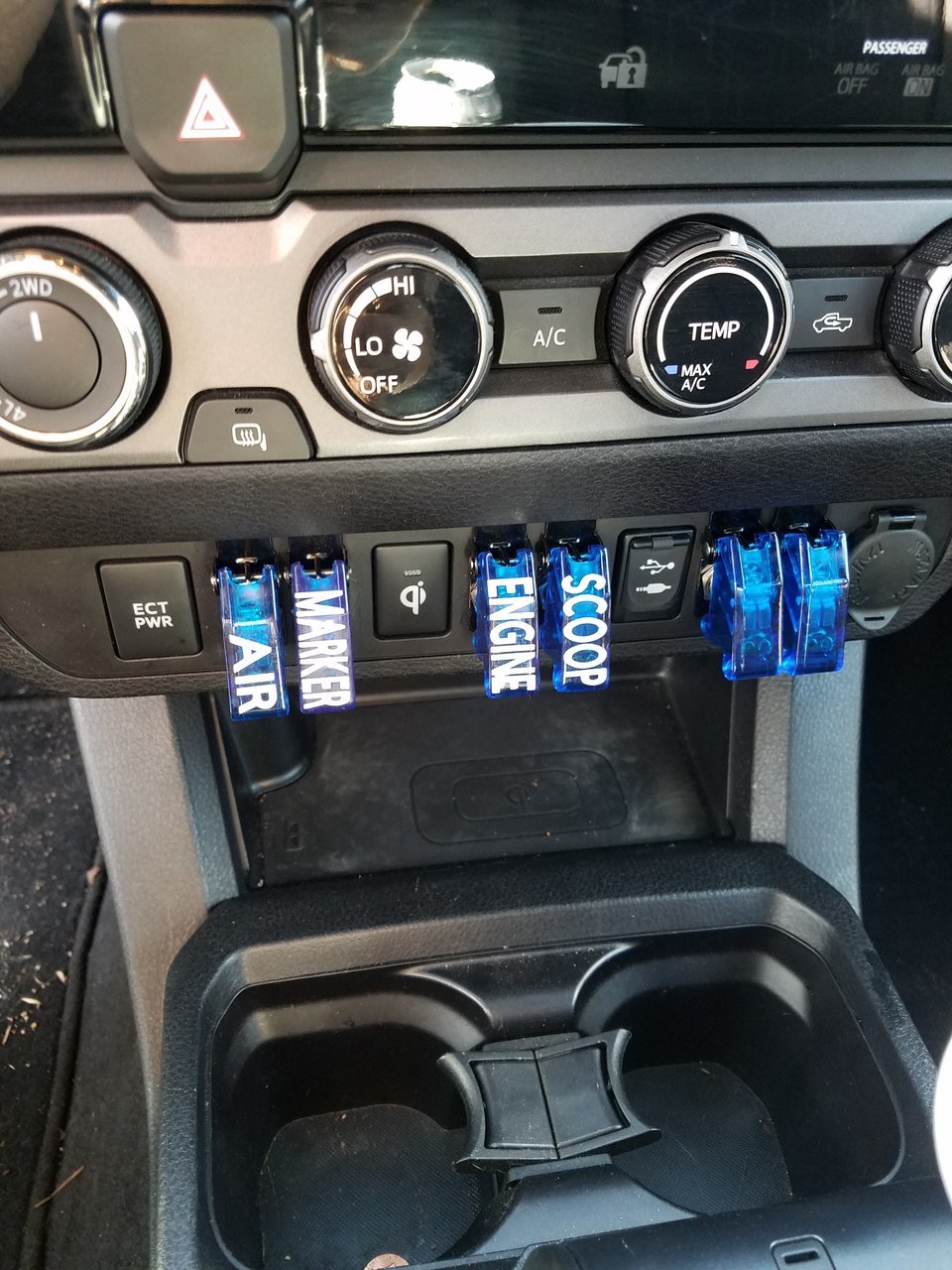

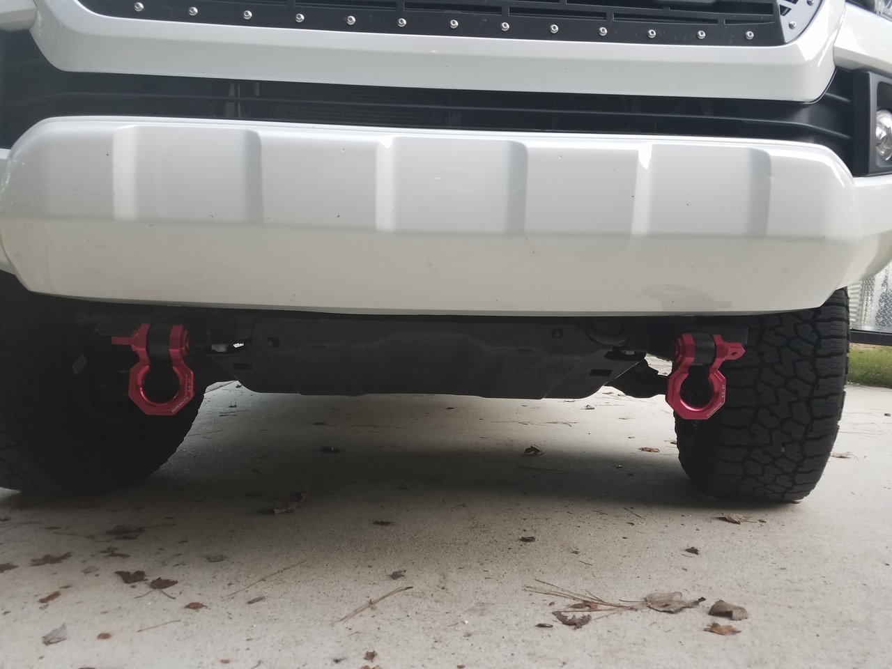

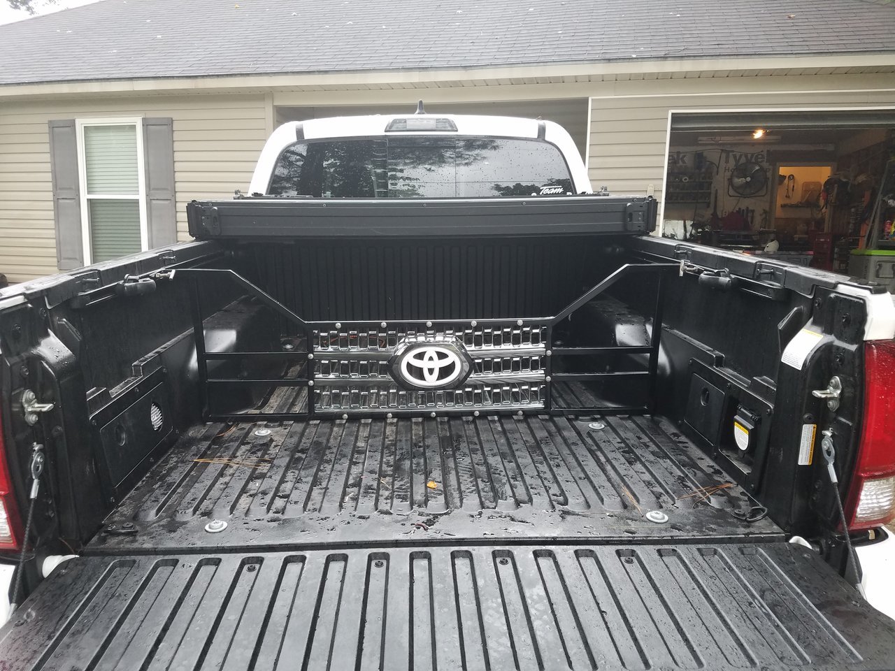

    Couple of my diy's. Shackle mounts, cheese grater turned into a bed divider, and switch panel 20180125_154053.jpg 20170917_182409.jpg 20170829_134114.jpg

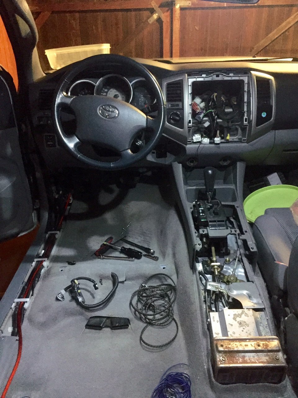

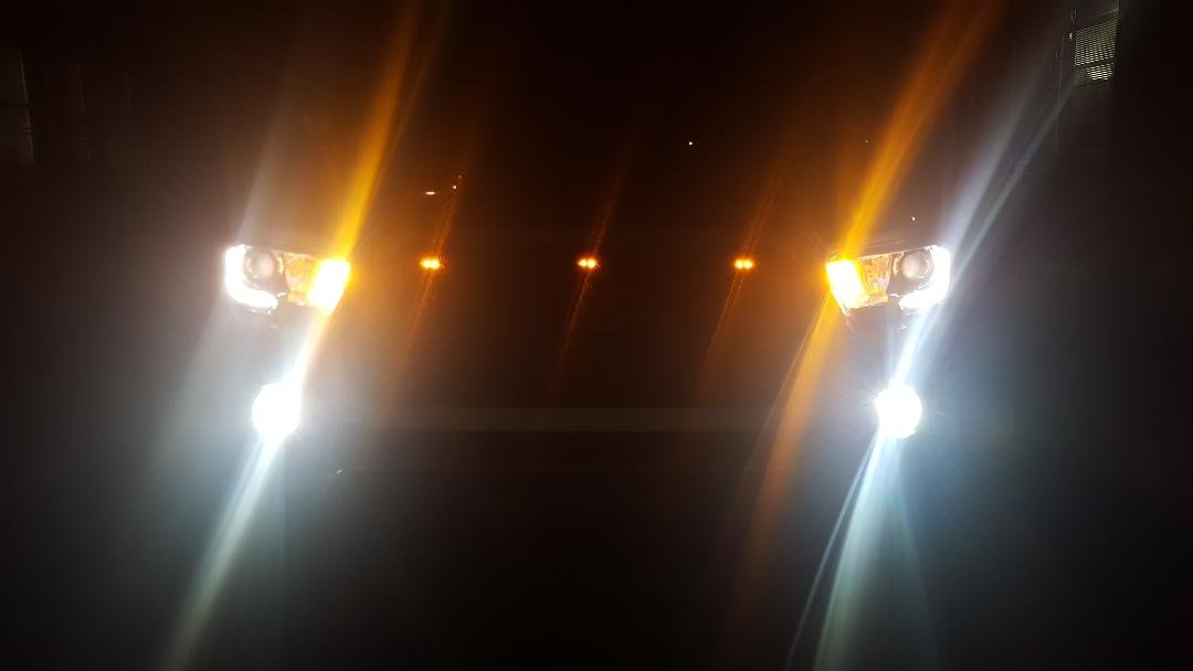

    Shame I couldn't find more pics of the full install but this is the most "custom" thing I've done, at least have a pic proving I did it myself as I am pretty proud of it lol.
    From all the research I did at the time I seemed to be the ONLY person to fit a 10" JL W3V3 behind the driver's side small cubby. This was a full depth sub not the shallow mount ones almost everyone else uses. I don't like the sound of the shallow mount so I was DETERMINED to fit a full depth sub back there. Curious if anyone since has been able to do it as well... This was back in 2014
    I used a custom box from ********* and had to dremel out the rear an extra 5mm or so to fit the magnet. I then put on a grill guard on the woofer cuz it was within millimeters of the back seat... also had to stack 4-5 washers under the rear seat mounts to tilt them forward ever so slightly so that the box BARELY fit it. Tightest fit I've ever seen but it worked! And proved you can fit a full depth 10" JL sub behind the driver's seat only.
    Amp was mounted under my driver's seat, also threw in a pioneer head unit and backup cam although getting the JL w3v3 sub to fit was the only true "custom" part of it. I wanted to keep the bigger passenger side cubby open for storage.
    Edit: just realized this was in the 3rd gen section but whatever... I'm gonna try the same thing soon on my third gen!
