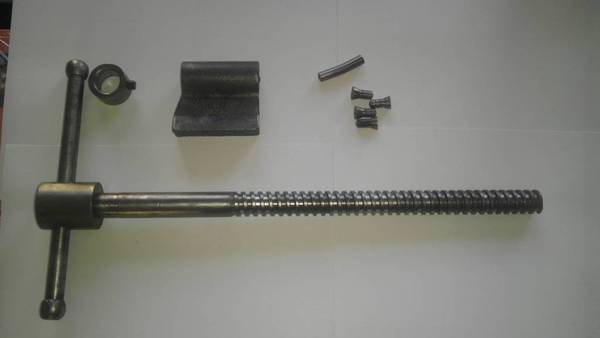

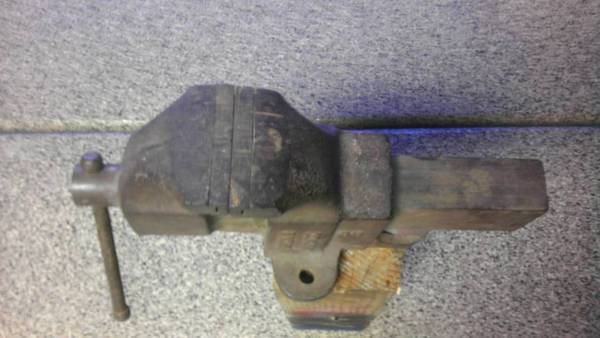

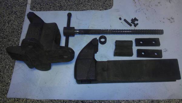

    So I recently got into old tool restoration. Its was something to keep me busy in the evenings after work that wasn't car related and cheap. So far I have done two vises just started a third today and almost finished with my tackle box lunchbox. For the two Vises I finished already I didn't take many pictures so I have a few that I can post this one I just stated I'm documenting more. Every part comes off and gets refinished to good or better then new. I'm also going to start doing ratchets and wrenches when i can find them. Feel free to post your old tools :)
    Fuller 5" Made in Japan 1970s:
    Before:
    After:
    Starrett Athol 614 4" USA Made 1920s
    Before:
    After:
    Morgan Chicago #35 3.5" USA Made 1930s
    Before:
    Broken Down:

    Thanks! The Fuller is mine that's why the slide and handle are painted. The Starrett Athol is one I bought for my dad as a father's day gift so I matched the paint to his Matco Tool Box. He has been wanting an old vise after he saw mine refinished. The Morgan will get painted the factory blue.

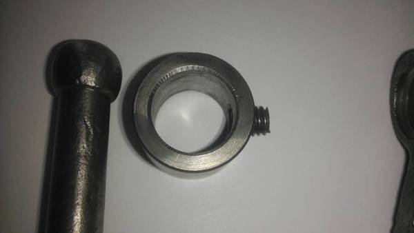

    Did you replace the vise jaws with new parts?

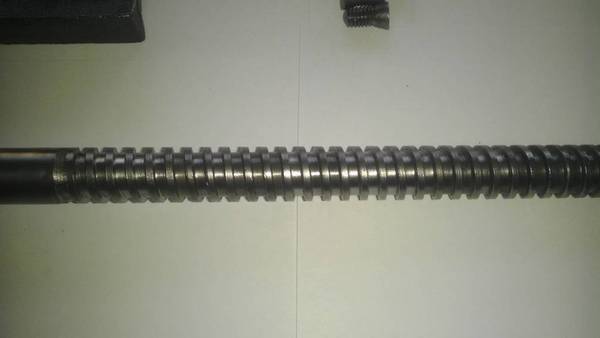

    The jaws on them have been perfect so there was no need to replace them. I did have to make a screw for one. Got a screw the was close then cut it and ground it down to the right size. To give it the look i heated it with a torch and then put it in motor oil.

    Yup. The Starrett I had to make a tool to put the handle back on. Its spring loaded and held with a pin and the only way to get it back on was to make a notched tool out of some 1" conduit to compress it and put the pin back in. It was also missing one screw on the jaws so I went to Copperstate and got something close enough and made it the same size the others. To give the old look like the others I heated it with a torch and then dunked it into some old motor oil I had around. Then mared it up with a flat head screw driver. you'd never know it was a replacement.

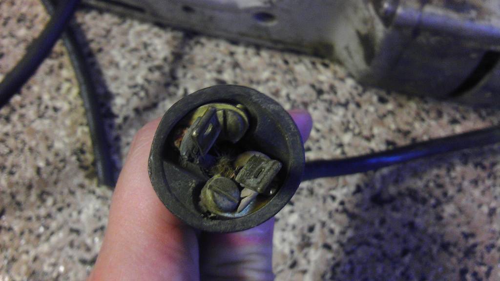

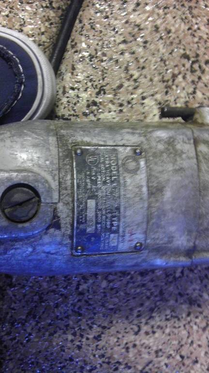

    He found this Rockwell Recipicating Saw at a flea marked in CO for $10. Its all metal. It will be my power tool.
    Already bought the stuff to make a new cord for it at Ace Hardware.
