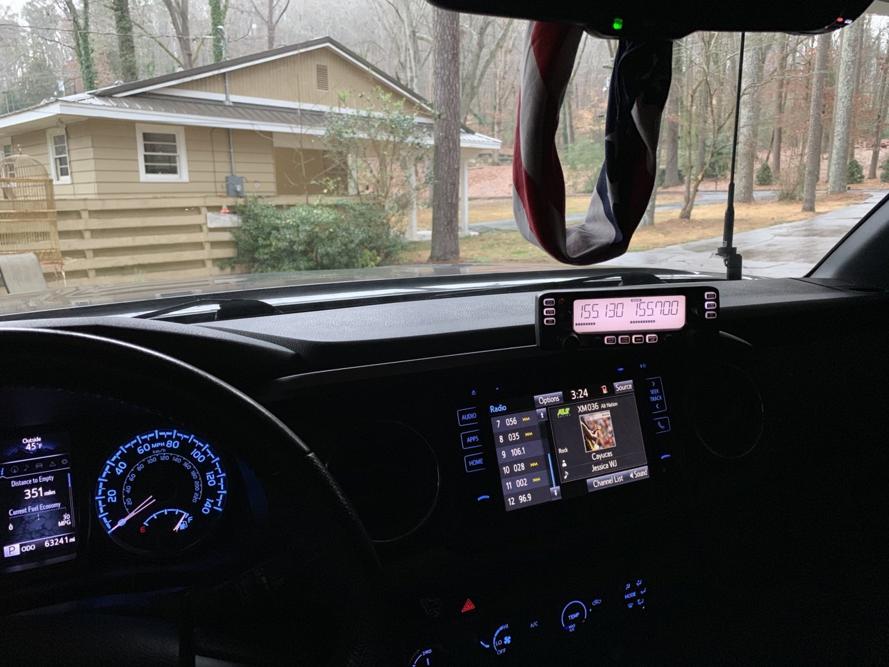

    #4418
    Leman
    Leman BROverlander
    Nov 29, 2008
    #11139
    632
    North Alabama
    '16 TRDOR4x4
    Finally got my radio installed.
  19. Jan 13, 2019 at 7:06 AM
    #4419
