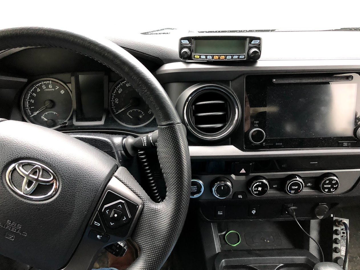

    Great pic! That location is where I am thinking of putting the head to my Icom IC-2730. I was thinking I could pull the trim out, then just zip-tie a plate in that my head can attach to (it has magnets). That is what i did in my previous truck. How is your's attached?
  10. Mar 21, 2019 at 6:05 PM
    #4890
    Lost In The Woods
    Lost In The Woods 4 out of the 5 voices in my head say go for it!
    Jul 11, 2016
    #191800
    1,394
    Eric
    Buckley, WA
    21 Gladiator Rubicon Diesel
    An unusually high amount of pinstriping.
    I have it attached to this https://www.ballsoutoffroad.com/product-page/3rd-gen-tacoma-accessory-mount. It's designed for ram mounts, but it works good for a head unit also. It's a little on the expensive side for what it is, but if your not the best a fabrication (me) then it might be worth it.
