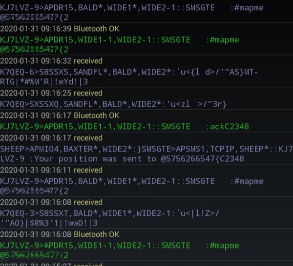

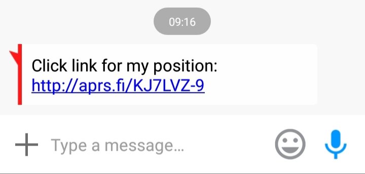

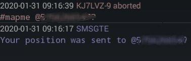

    It sends, gets digipeted, gets and ack returned from SMSGTE, and is delivered to the cell phone recipient. The re-sends are not acknowledged and not forwarded as a text message.
    KJ7LVZ-9
    Messages screen
    SMS from my phone

    It has to show the ack was... Acked.

    How do I ack an ack? Message sent, the response was delivered to my messages inbox. Does SMSGTE not automatically ack a message?

    You didn't get an ack, you sent one.

    Got acked on a different message last night. I think if you don't get the original acknowledgement, it isn't present with later message transmissions. Maybe the path settings from the SMSGTE acknowledgement don't ask for digipeting.

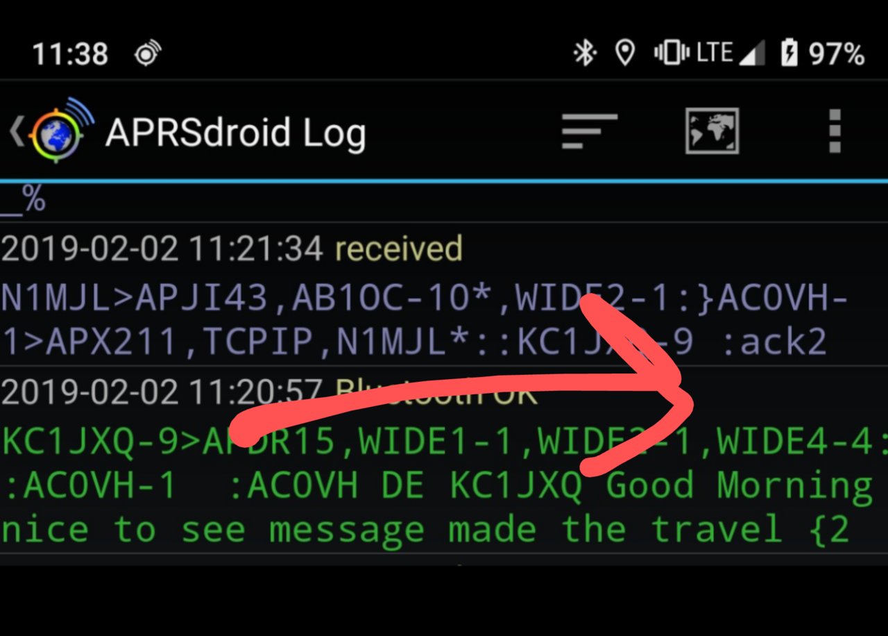

    The ack he's talking about is done automagically by the client receiving the message, at least if the protocol is fully implemented. Status and Posit packets are sent with no expectation of an ack packet but message packets are sent and will retry until either it receive an ack from the recipient or it times out.
    Fun fact, the example message he's using shows my station sending the "ack2" and in that case the client is Xastir over the Internet directly (TCPIP, not RF).
    Typically this is a finite number generally with decaying delay. IOW you hit send the message packet is transmitted immediately (or as soon as the TNC/client detects it's OK, they sometimes watch squelch to clear) and then some number of times following some delay algorithm.
    For example my Argent Tracker3 is set to a 120 second delay with a limit of 7. So that means it sends at most 8 packets at intervals of 0 (first packet), then 2 minutes later, then 4 minutes after that one, then 6, 8, 10 and finally a 12 minute delay. If it has not heard an ack packet by the last one (which I think is 38 minutes later) that message is assumed to be undelivered. I've experimented making that 30, 60 and 90. None of them are really ideal compared to an actual operator sending a message. If the network hasn't transported an ack in the first few minutes it's not really worth letting it ping away indefinitely.
    In that time the person you sent the message to may have actually composed a response message that implicitly acknowledged your original message in fact got through but to the network his station for whatever reason wasn't configured to send an ack or the network or your client never heard it.
    In a local network of all RF stations this I find is not usually the case, ack packets usually work. It's when sending messages over a digipeater they are sometimes mistimed or experience collisions. Worse yet is when it has to traverse APRSIS and the Internet there's so many more opportunities for a packet to end up in the bit bucket that waiting
